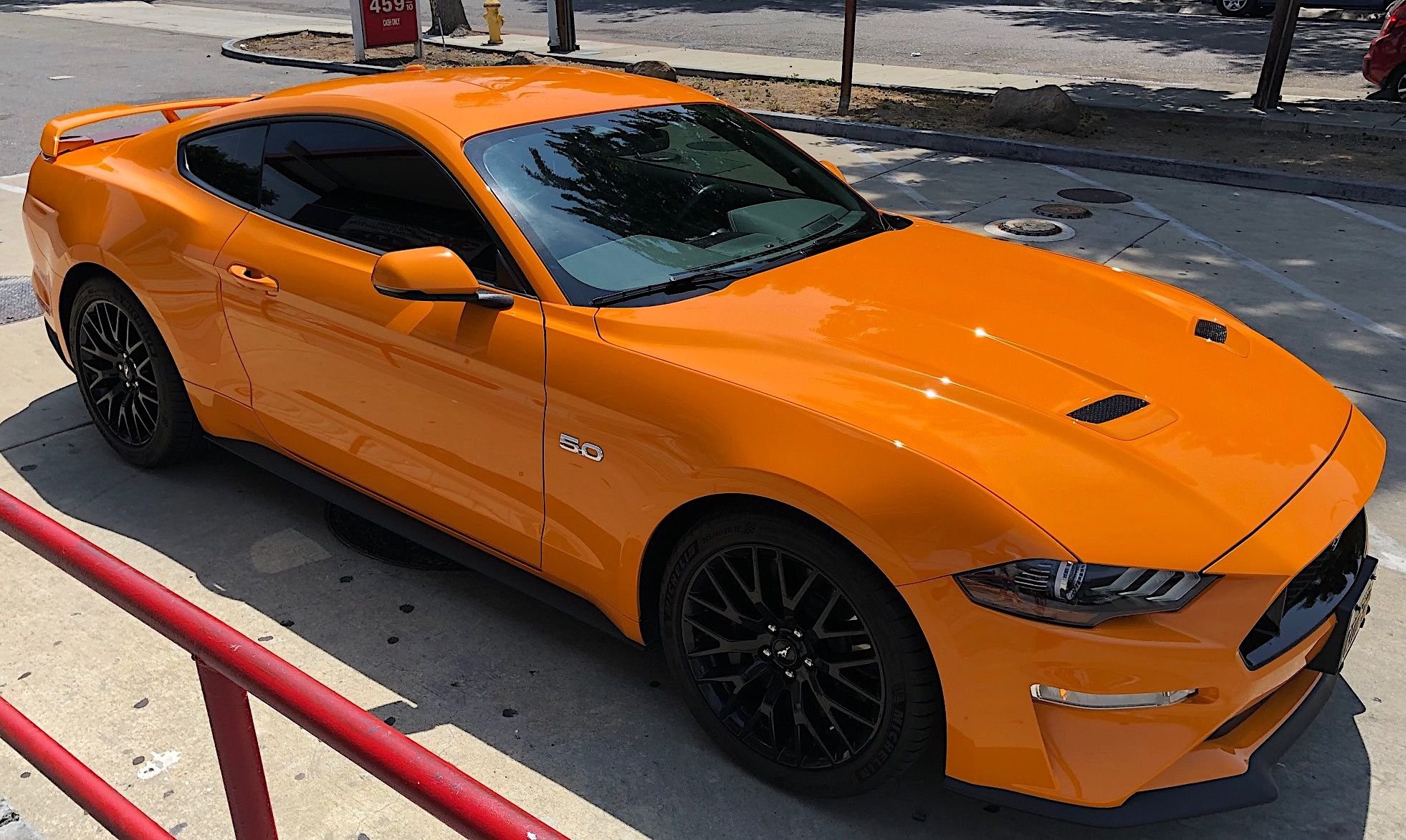

Thanks Hummerz...I plan on driving this Hummer a long time. 118K on it ​​​now...being in CA the body and undercarriage are in great shape. I've owned it since it was new. Never been beat on. Appreciate your advice....I just bought a brand new MustangGT, so this Hummer is pivotal to the mustang just being a weekend toy :-)
