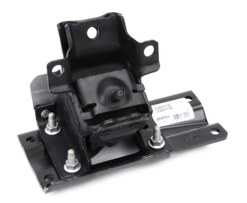

I'm helping a friend with a 2009 H3 Alpha with 90K miles in Fort Worth TX. She just had here transmission replaced. She was lucky as GM now listed only one other rebuilt transmission left in the US (Ohio). The engine mounts need to be replaced and the dealer said there are no left engine mounts to be found (part #25847738). I've confirmed this during checks with other sources and internet searches. The right engine mount is common with other GM products and available. The transmission mount is available, but few remain.

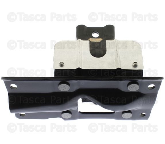

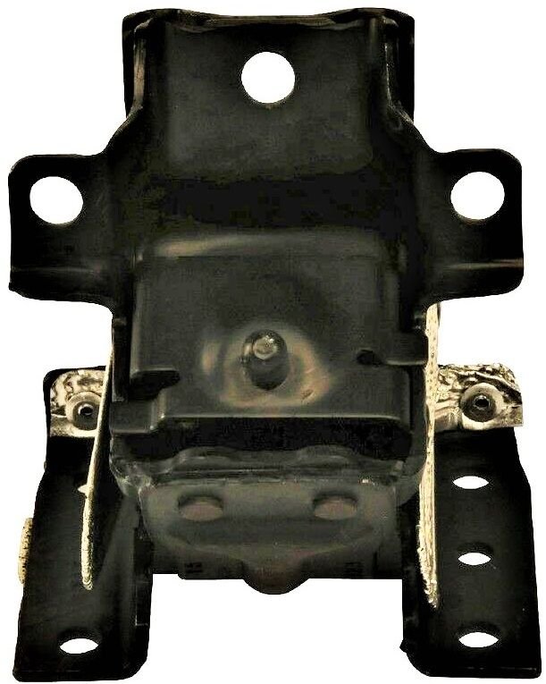

The engine mounts I've replaced over the years on many different vehicles have typically been common or symmetrical. When looking at pictures of the H3's V8 engine mounts, the core of the mounts appear to be common, but there is an adaptor attached to the left engine mount which makes it different (see below). I've suggested to the dealership to buy 2 right mounts then take the adaptor hardware off the original left mount and added it to one of the new mounts. They are reluctant to do this.

Motor mounts are usually identical, yet the 25847738 has an adapter plate. Buy a
25847739 25847739
& check fitment on the 25847738 plate. If it don't work, return free for a refund.

Thanks, hmmerz. Yesterday, the dealership agreed to the repairing the left engine mount using a right mount as a donor for attachment to the original mounting plate. Good news for others that might need a left engine mount for their V8.

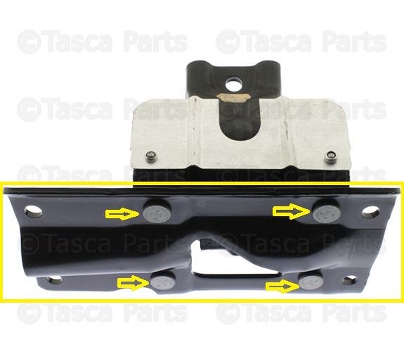

That sucker is riveted together. If I'm understanding things correctly, they'll have to remove the rivets and bolt it back together. Is that right?

The only rivets I see are the heat shield on the right engine mount and thin plate on the left mount. The right engine mount bolts to the left's adaptor plate.
The owner is happy to have her Hummer H3 back and running well. I am not aware if the right engine mount was installed on the left's adaptor plate with heat shield or if those riveted parts were swapped out.

Look again, you will clearly see the rivets are to secure the heat shield to the mount, not to the adapter plate. 4 studs/nuts secure the mount to the adapter plate.

Not, since the right mount has a better shield to protect the rubber.
Man, I guess I am blind or else those top views were just added! I didn't see the bolts until just now. Sorry...
