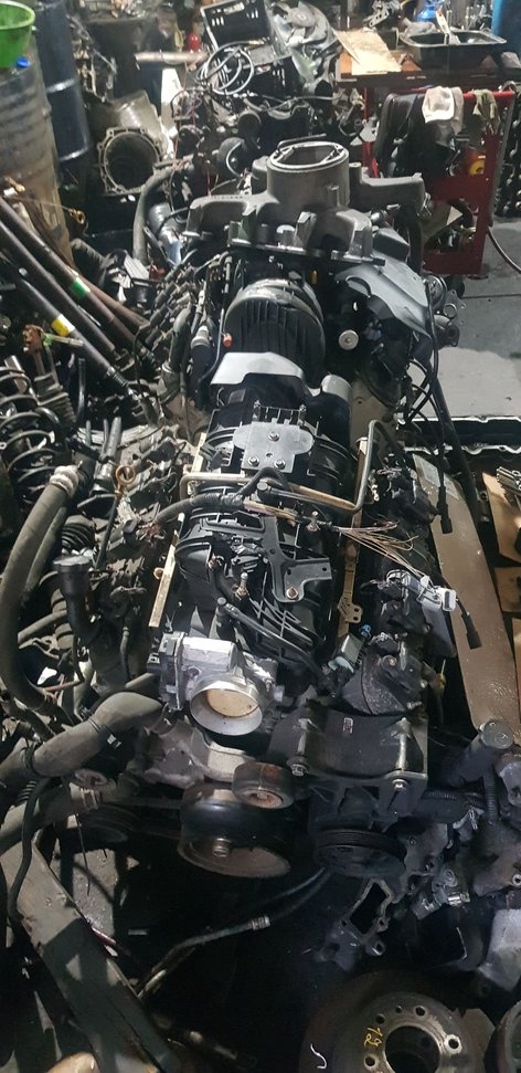

i have my v8 L96 2014 ready to put it on my h3
