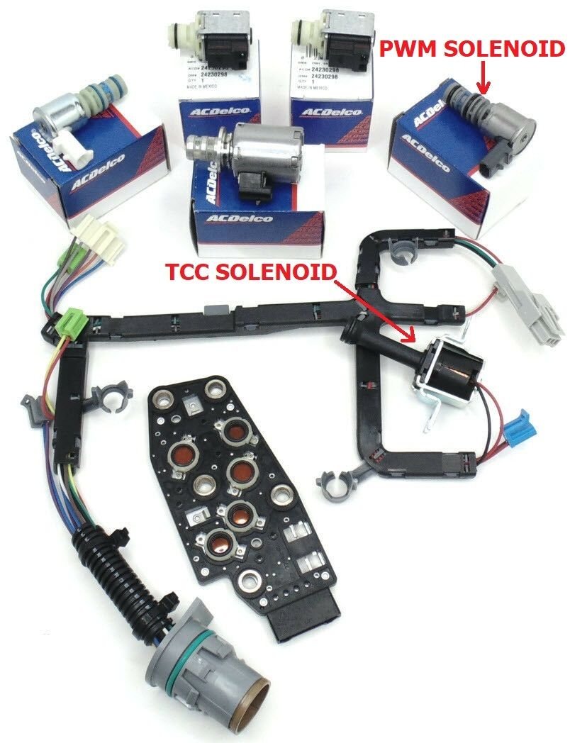

2007 i5 here, I had the transmission rebuilt a little over a year ago coz of some issues and now it drives well, except that the P0741 code did not clear. Mechanic said solenoid is good but I really do want to change it for good measure. A couple of questions (please assume that I'm dumb with these things);
1) In the attached pictures, it says no. 5 is the TCC/PWM solenoid - is that the one I should change for the TCC On/Off solenoid? I previously thought they were two separate solenoids but I'm not too sure anymore. If possible, a part # would be of great help!
2) Could anyone lead me to like a solenoid kit set with the harness? Might as well change all once it's open.

Could you please tell me if no. 5 is the correct one to change out or am I missing something? And do you know of a solenoid kit w/ harness for the '07 i5? Thanks!

Make sure to clean the valve body! The TCC is on the right front of the transmission. After you drop the pan, identify the parts. Many yt videos on how to change. JUST MAKE SURE TO CLEAN! #SeaFoamWorks

THANK YOU SO MUCH! Seems like the TCC solenoid is hardwired to the harness.
I'll be ordering the OEM kit, this is great help thank you so much! I'll update once I get it done. Thanks for tips too!
