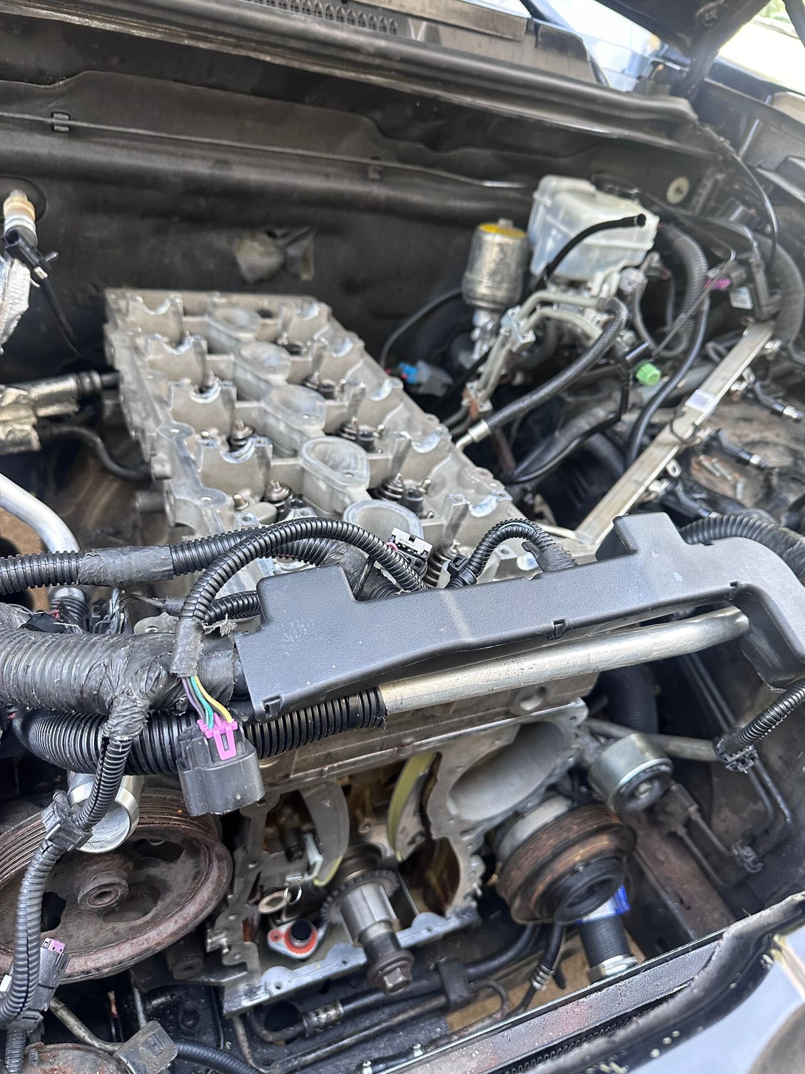

doing great I started a project to rebuild the engine . So far I replaced the pistons , crank shaft bearings, rod bearings, oil pump , cleaned the valves, new springs and retainers , and new timing chain and sprockets,remember a while back I stated that I lose oil when I drive it for a while. I should’ve seen the pistons they were so bad the piston rings were bad. I also changed all gaskets, putting new exhaust manifold because I found out that my exhaust manifold was cracked wonder why I was getting ****ty gas mileage . When I finish it she will be like new again brand new engine parts and all . I am almost done with her then gonna do a first start and see how she is gonna go

lol yes it did. I had 2 weeks off from work so I was like why not let’s rebuild it all internal engine stuff are original since 2007 so it’s been a min thought it’s time to just upgrade them and change them this way I can have more years out of it . After the engine rebuild the next step will be the transmission but I haven’t decided which one to go to yet I looked at monster transmissions and they have nice builds for good money so I may do that after a while

Almost done with it putting it back together . I broke the clips that hold the purge valve to the throttle body any one know where I can get them? I went to auto stores and got then 5/8 and the kit but still nothing fits
