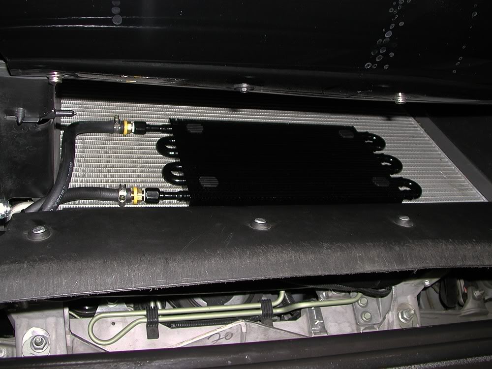

I haven't added one to my Alpha but I did put one in the wife's Covette which just happens to use the same 4L60E tranny the Alpha has. I installed a tranny cooler in the vette because I swapped in a hig-stall torque convertor along with 3.42 gears and it was a requirement for that setup. The tranny temps can be monitored directly on the cars Driver Information Center display on the dash and stay in the 150-190 deg. F range even in the 100+ deg. temps we had here last summer.
This is a dedicated tranny cooler so I would need to swap in a Dewitt's EOC-style radiator or a custom oil cooler if I were to go that route. I've seen some trick custom oil cooler setups on vettes but they are a bit more involved than a tranny cooler due to the adapter required to tap off the block. Dewitt's offers combo EOC/tranny cooler radiators for several cars but I have no idea if they offer a Hummer version. Tom's rads are trick and work extremely well.
The cooler I installed was an off-the-shelf Hayden that I plan to replace with a heftier B&M.
