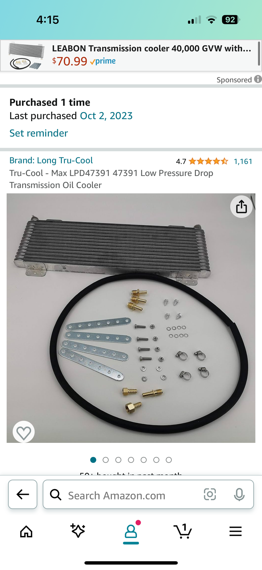

I ordered this one but my question is does the entry for the hoses to the cooler go top or can I flip it so it point down? Because when I point it down it’s easier to run the lines to the transmission lines . Also another question does it matter right or left is entry and exit back to the tranmission? Does like left is enter right is return ? Or it doesn’t matter ? Which way? Right now with the stock setup does the passenger side transmission line is entry or return? I just Wana keep it the same order when I install the cooler. And my last question is how you plug the holes on the radiator were the transmission lines used to go?

Down or to the side are the options to avoid air gaps. Definitely not on top. If you point the cooler connections down it does not matter. If you point them to the side, then the Bottom connection is for IN, and the Top is back OUT to the Trans.
A bypass really only if you install a Trans Cooler as a stand alone (no longer use the in Radiator cooler) and you have temps below 32F for extended periods.
Passenger side of the lower Radiator connection is the Radiator Outlet back to the Transmission.

thank you doc I will position the port of the cooler facing down and I will keep it where passenger side is going back and the driver side is entry just like it used to be on the radiator and I will change the filter and the fluid as well. What do you use to plug the radiator plugs where the transmission line used to go to? Or do they just stay open ?

the one I ordered is like 40000GVW
Tru-Cool - Max LPD47391 47391 Low Pressure Drop Transmission Oil Cooler https://a.co/d/98dsVv9
I got the one without the bypass thermal

The cooler you got is quite large, you won't have much choice in terms of positioning - check out this thread for reference.
To help answer your question about plugging the old ports in the radiator, I just left mine open, but people do plug them with something to prevent them from getting dirty and what not. Doc suggested foam ear plugs
