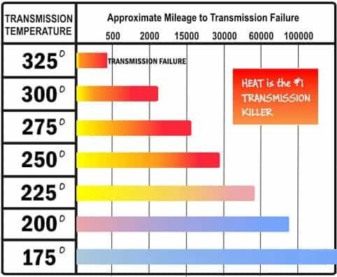

The normal(optimal performance) operating range for a 4L60-E is between 160° and 180°!
Transmission temperature you can expect the transmission to last:
Ooof, I saw this chart on a different cooler I got for my chicken coop. A bit unsettling considering I have no idea how long this truck been running with transmission temps around 230F. I am also not sure just how accurate my scanner is. Could I send a temperature probe down the fill hole to check?
