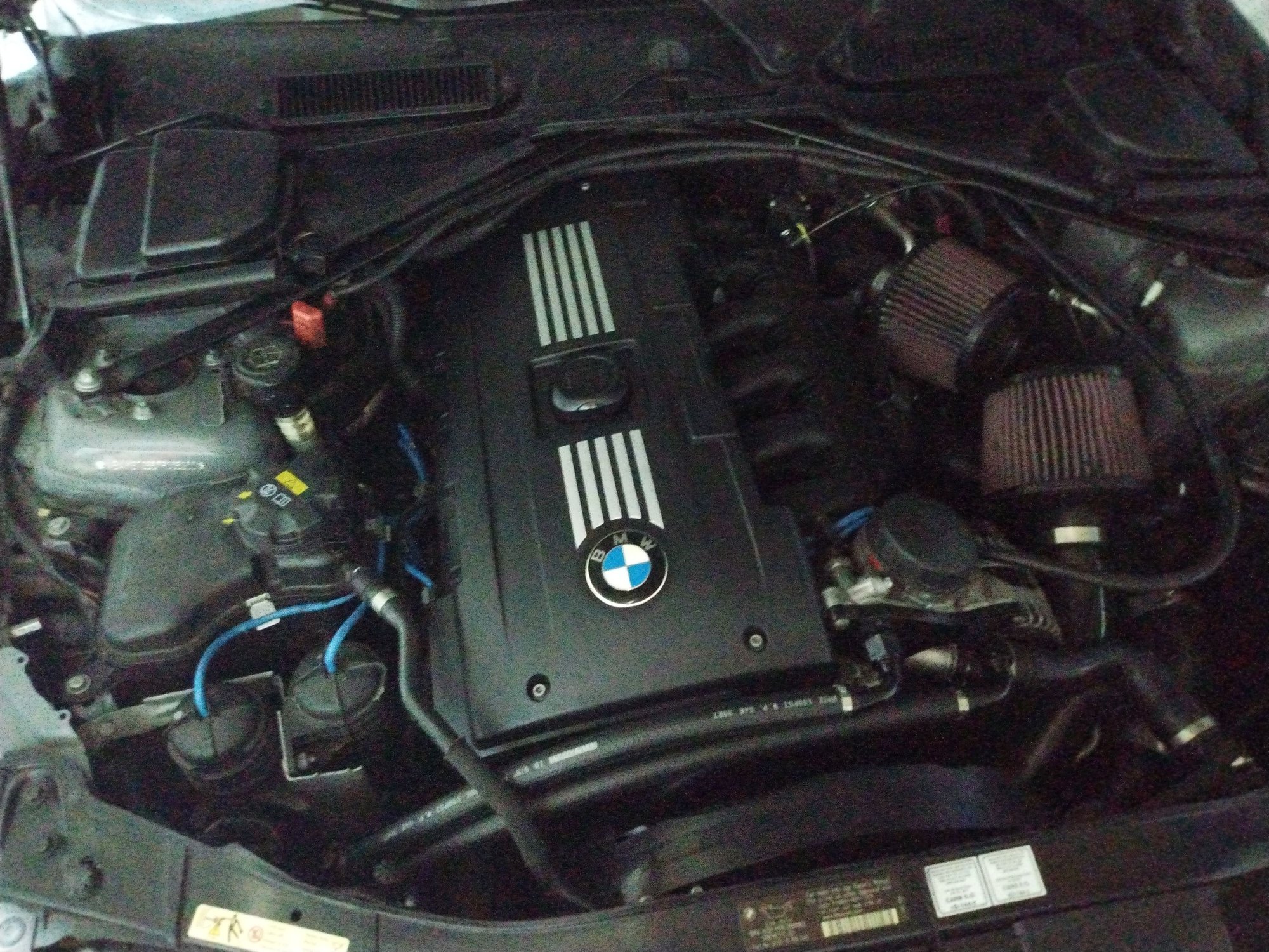

What about ear clamps? Here's a photo I did on my BMW oil cooler lines with some AN fittings.
Twin turbo magic
