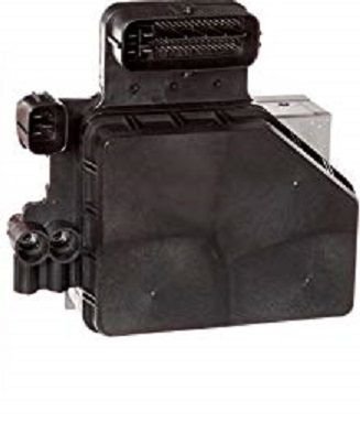

Look at your brake fluid reservoir. "black box" next to it, just pull the 2 connectors at the top & clean/seal the contacts. Btw, make sure the connections are clean/sealed at the bcm and tcs.

i wonder if the EBCM on the H3 also suffer from internal cold solder joints like on other GM's

can the EBCM be opened?

There is plastic cover glued over, non-servicable.
Can be opened using sharp knife and patience, that what I seen on youtubes for other cars.
That would be last resort in the list of last resorts someday.

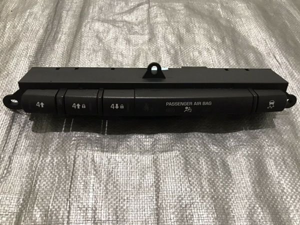

I have 2007H base, with basic switch.
Can I buy switch with rear lock and plug&play ?
Mine(image stolen from internets):
Can this one fit just fine? Of course I do not expect extra button to work.
When I opened my switch there was extra button for rear locker, but it was blocked with plastic and covered with Air bag bar, so I assume they are identical inside.
Thanks!

Sorry, needed to use search on forum, answer is here:
https://www.hummerforums.com/forum/h...-switch-41171/
Will buy switch and see if this fixes, if not, spare switch!
Old Feb 29, 2020 | 01:36 PM
  #28
Yes, swap the cover, to the new 1. GL

Got the switch, swapped.
B2745 - Body control module - Traction control switch circuit - remained
B2725 - TCCM - Mode switch circuit malfunction - gone
New switch has snappy buttons, previous one had mushy/sticky ones.
I can easily switch modes now, no errors thrown, previously I needed to clear codes, then switch modes.
