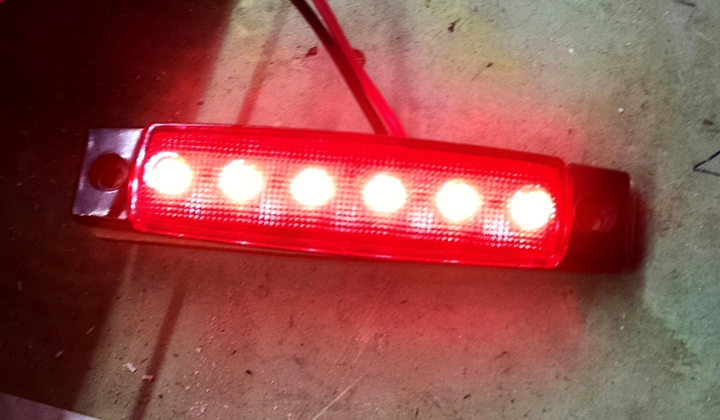

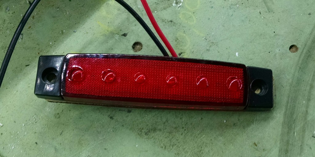

I bought a couple of small LED lights from eBay; they're about 3" long (not counting the mounting tabs) with 6 LEDs. Cut the mounting tabs off one side and glued them together to make one 6" long unit with 12 LEDs, then mounted them inside the housing.
Sorry, no pics of the finished unit, but here is what I started with:

The stock unit is red LEDs with a clear diffuser lens. These were white LEDs with a red lens. I left the red lens in place, AND left the stock clear diffuser lens as well. They're not quite as bright as the original, but are sufficient (and a helluva lot cheaper than the Chevy part!).
