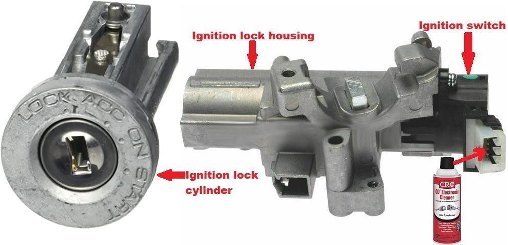

Have you tried cleaning the ignition switch with CRC? Pic courtesy of hummerz...
