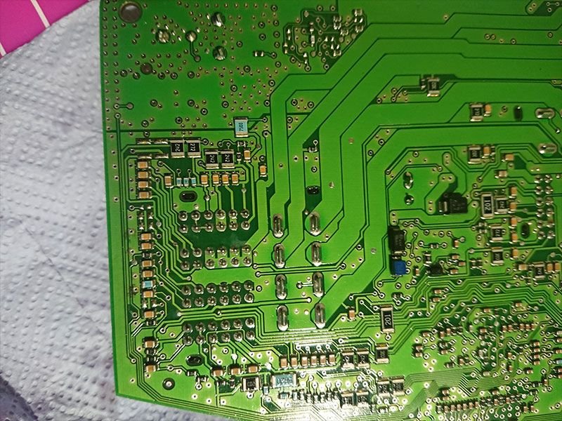

Traced cable to BCM, no shorts, cable is fine.

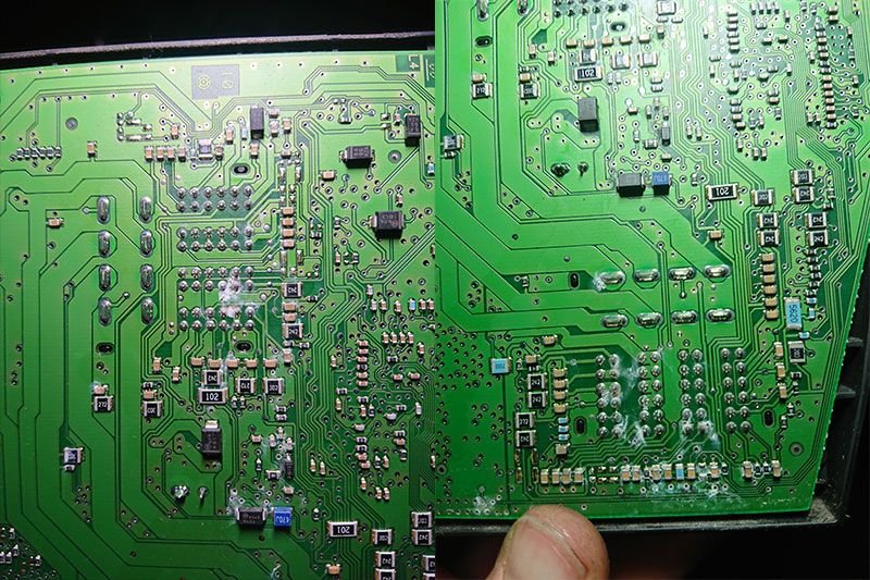

Ripped out BCM, opened up.
Does not look too good.
Got some common household tools:
Nice and gently rubbing resulted in shiny BCM board.

Looks good. Nice work! Btw, dealers service and auto repair shops won't like your post, since they prefer to throw parts at it, at the customer's expense.
Old Feb 11, 2020 | 05:56 AM
Looks like water damage.
Sunroof on your H3?

TAINTER: sunroof never had much leaks while I owned truck.
I tested tubes and passenger side tube was very slow to drain water, driver side was much better.
Looks like water or condensation of water that oxidised board.

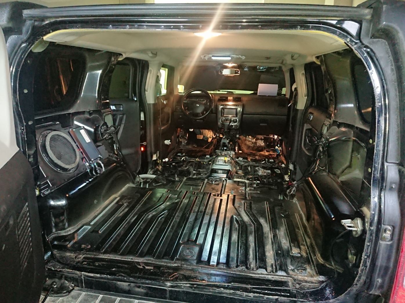

It was rainy outside, ripped out BCM, dry, no moisture, ripped out carpet, nothing, dry(there was substantial rust under passenger feet, so water was leaking before I owned a car, needs wielding).
Will grind down rust spots and repaint, good reason.
Next step is to rip out console/dashboard and see if anything is wrong there.
Something with moisture somewhere, I need to find out all ground points maybe.
