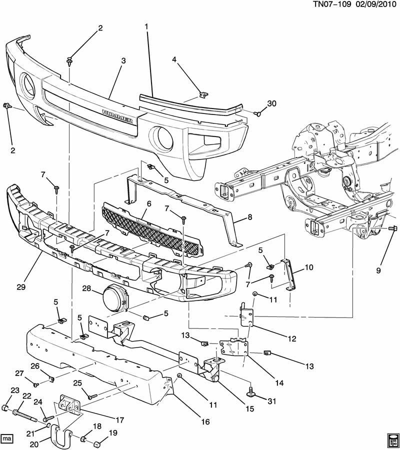

If you disconnect the fog lights, remove the front tow hooks, the entire front bumper can easily be removed in less than 15 minutes. There are how to step by steps on line, just google it. After the tow hooks, you just remove two of the four bolts from #12 on ea. side. Pull the entire front bumper assembly off and lay it face down on the ground.
Old May 17, 2018 | 12:19 PM
  #82
DOC, you forgot about the 2 frame bolts on either side too.
#9 in the diagram.

#8 is the framework that I used to mount my lightbar brackets to.

Thanks to all for your reply's. I have the bumper off, however, since my 30" light bar is about 31 3/8" outside to outside the only way I can see to mount it is to remove #8 and use those holes for the two hidden brackets that came with the light.
