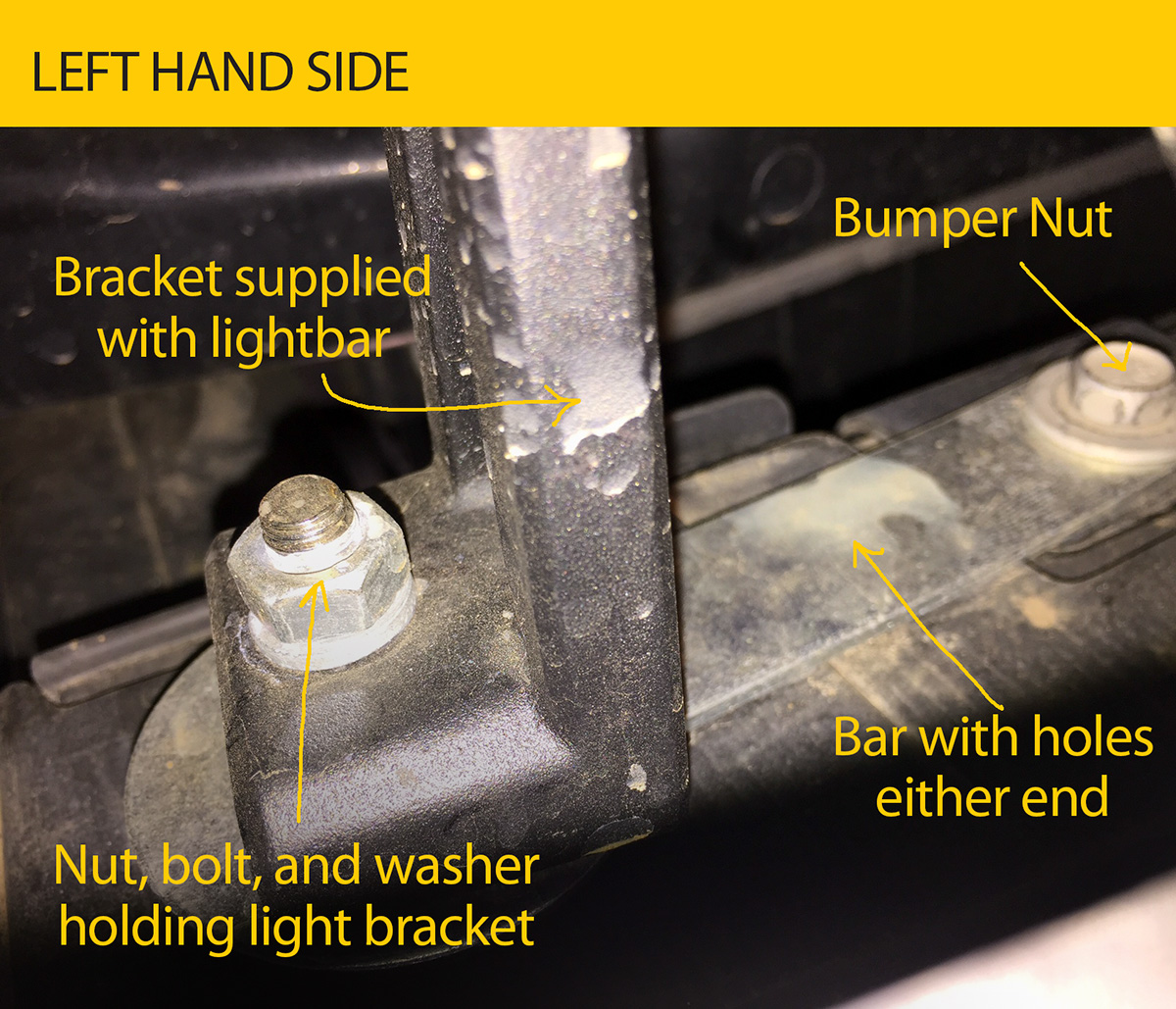

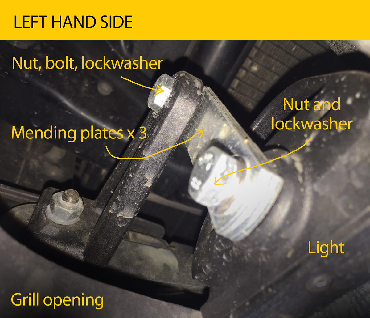

Brackets - left side shown, everything bought at Ace Hardware straight off the shelf.
Basically uses the existing bumper bolt to attach a mending plate which the bracket that comes with the light connects to with a nut and bolt. On the upper connection, I used 3 mending plates to push the light up and forward into the grill space so it sits flush. Lockwashers and Loctite a must, my light bar has been on a few months, not had to tighten it - rock solid.

Hope this helps, only other advice I can give is get it all installed loosely, position the light exactly where you want it and then tighten everything up. It's a little fiddly and smaller hands would be a bonus - but this way you can center the light and adjust height and position within the grill opening.
Perfect, you are a lifesaver! That looks solid. Did those bending bars come pre-cut and drilled, or did you have to cut and drill? Either way do you remember the length of the bars?
Thanks much appreciated!

Hey Torquetwister, they were off the shelf - didn't cut or drill - truck is at work, I'll see if I can measure them tomorrow. Only other thing I did was install a couple of large washers beneath the mounts supplied with the light bar, each mount has a rubber base - wanted to give it something to 'stick' to.
