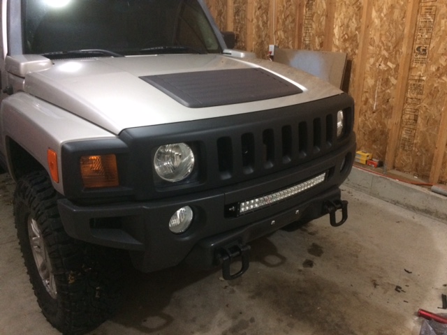

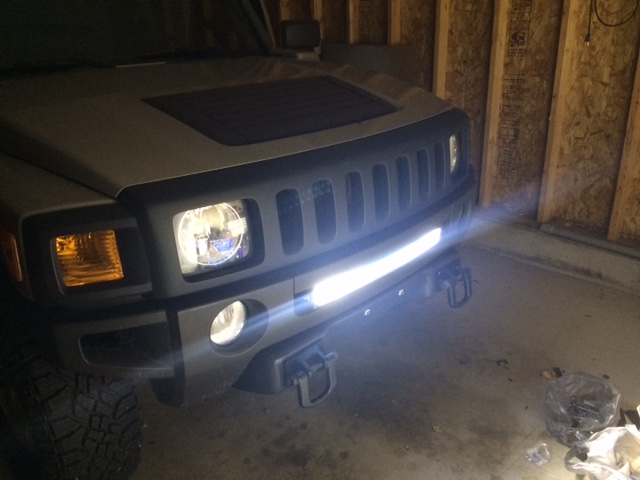

Hey Dukie, I have it figured out, I used 2 1/2in mending plates all the way around. I couldn't be more happy with it. Thanks for all your help!

You don't hang about - looks perfect, nice job.

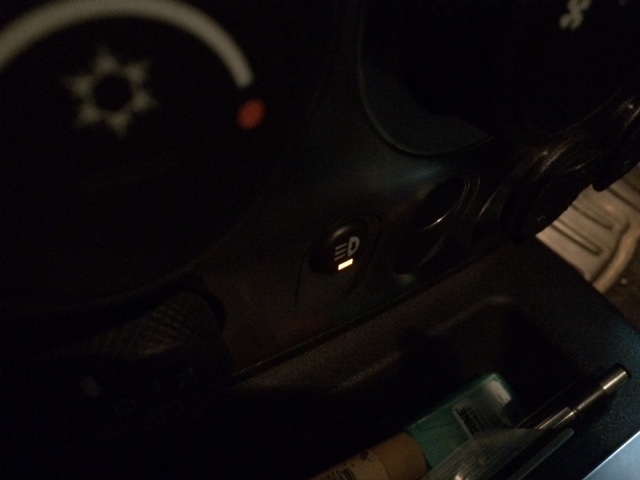

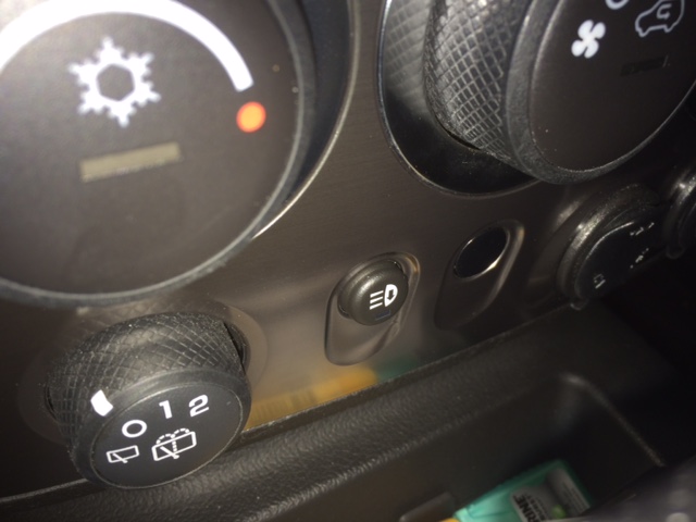

If anyone is interested in using the OEM switch with the Amazon wire harness, please use the following pin orientation.
OEM Switch Pin A = Black wire from Amazon harness - Ground
OEM Switch Pin B = Blue wire from Amazon harness - Relay pin 85
OEM Switch Pin C = White wire from Amazon harness - +12
