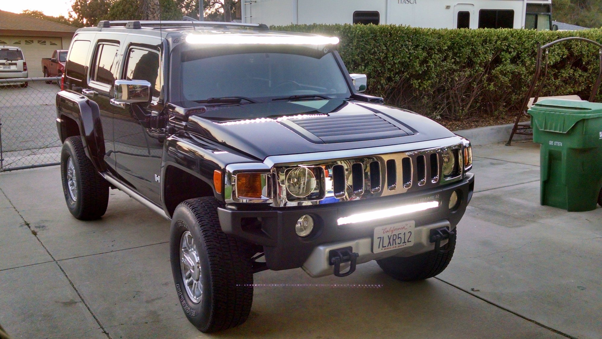

Just buy a switch you like and a relay, and make your own harness. As for the lights, there are a million out there on eBay and Amazon; read the reviews and take a chance. I bought a straight single row 30" for the grille and straight single row 50" for the roofline from Mictuning, and am extremely happy with them. Currently watching for a 40" curved single row for my MH, but they're a little harder to find for a reasonable price.

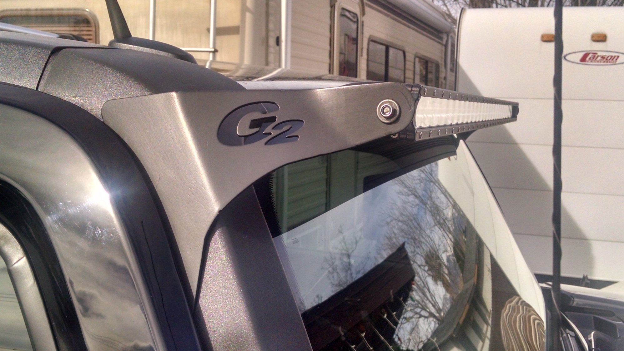

Very nice. Where did you get the switches from? 12mm? those brackets for the roof bar where did you get those there nice also.

Switches came from Amazon, brackets were available for quite some time at G2leds.com, but not sure if they are still around.

I really need your help!!!!! I have a 30" LED and having a hard time on how it gets mounted in the lower grill. The only way I can see how to is by removing the metal frame that goes around the plastic grill. Is that what you did? If not how did you install yours? My light measures about 31 3/8" from outside to outside. Any help will be more than appreciated.

I took the entire bumper off so as to work from the backside. There are metal supports in the back, on either side of the narrow grille opening. Those supports are at a slight angle (i.e. not straight up & down). I simply made mounting brackets from some flat steel with a slight "twist" to match the angle, then drilled a hole and bolted the brackets to those supports on each side. My lightbar fit without having to remove the framework; but keep in mind that mine are single row lightbars, not double row. I don't remember the exact dimensions of my bar.
