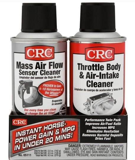

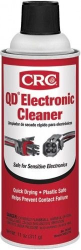

Save yourself money, by opening up a can, or 2
I need to get that electrical cleaner I used the same cleaner for the maf and I also have the other one for throttle body mad and throttle body is clean but that electrical cleaner will come handy to clean that fuse box
