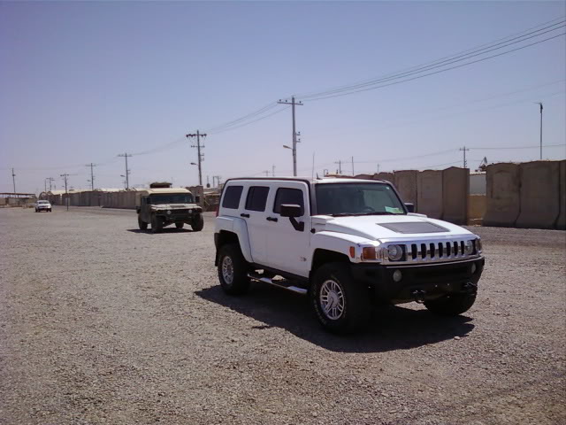

Originally Posted by drtom
it should run from +110 to-40!!
I remember a white H3 in Iraq last year and it was around 140 during the day.
