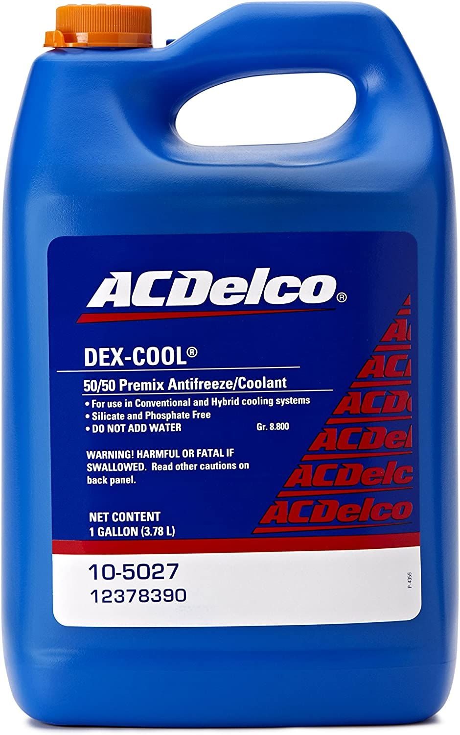

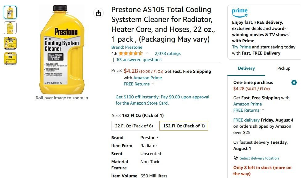

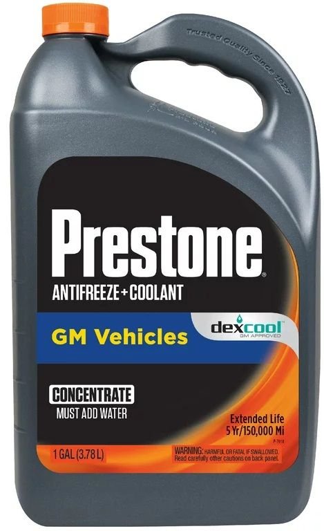

You found the blockage! Get that radiator out/replace, or you can try flushing it? Perhaps previous owner used the wrong coolant or stop leak? Make sure to flush the ENTIRE COOLANT SYSTEM, then drain and refill with:
Old Jul 16, 2023 | 07:11 PM
  #127
Posts: 9,024
Originally Posted by MadDogBimmer89
What else is there??
Old Jul 16, 2023 | 07:28 PM
  #128
Posts: 9,024

Will defiantly add this to the list, thinking of replacing the radiator anyway since that would be the last part in the cooling system that I haven't touched yet. And a chemical flush wouldn't hurt for the piece of mind.
