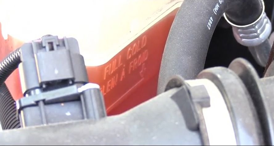

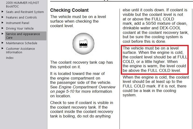

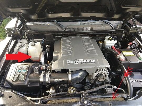

Mr Silly, you have covered the air flow induction, yet you need to check your coolant level/loss.
Full should be at the seam:
You would be WRONG. The Cold Line is exactly where my level is at, the "seam" would be even higher than HOT.
Old Jul 14, 2023 | 12:51 PM
  #112
Posts: 9,024
That's the minimum level, go below=OVERHEAT.

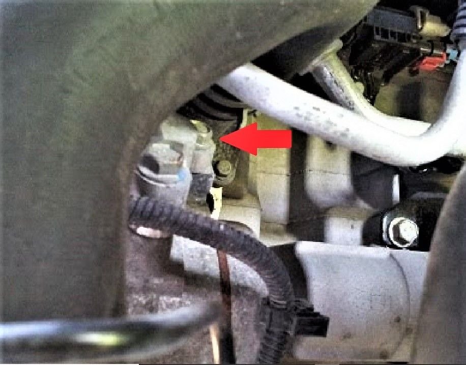

Direct IR at T-stat housing/block(not hose) to check temp. Post results.
Old Jul 15, 2023 | 04:46 PM
  #118
MadDogBimmer89's Avatar
Joined: Jun 2023
Posts: 171
I couldn't get the reading from the T-Stat Housing as it is located on the lower driver side (lower hose), upper outlet housing (upper hose) couldn't get a stable reading due to air flow from the fan so it kept jumping around all over the place. When I say "upper hose/lower hose" I am using that as reference, I was measuring closer to the radiator similar to your photo. Upper radiator/inlet was at 226F similar to what I am getting on the torque app. Lower radiator/outlet was at 173F, so about 53F cooler. I don't think using an IR method is a good indicator of anything since we're measuring surface temperature, not very accurate unless you have a reference point. Same with your grilling, just because your steak is 135F on the outside does not mean its 135F on the inside, why probes are used instead. Same with HVAC, if you use the same instrument measuring return temp vs. supply temp you get a difference in reading/delta T. But more accurate temp reading would require an actual probe.

Back to your OVERHEATING, YOU NEED TO check IR temp at the head and block, NOT HOSES. Hoses are an insulator and will not show anything close to the temp inside with IR. Just make sure you point the IR at the passenger side of the head(not exhaust manifold) & drivers side of the block t-stat/housing. Try doing this after you reach your high temp at idle, then shutdown and check temp variance between the 2 points.
