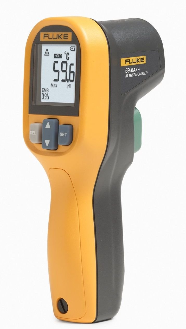

Do you own an IR gun to check temp variance/blockage throughout the coolant system?
https://youtu.be/EjvkoYvQ06E
i dont have one unfortunately but it just seems like I'll have to go this route. What are the usual places where blockages are common other than the radiator?

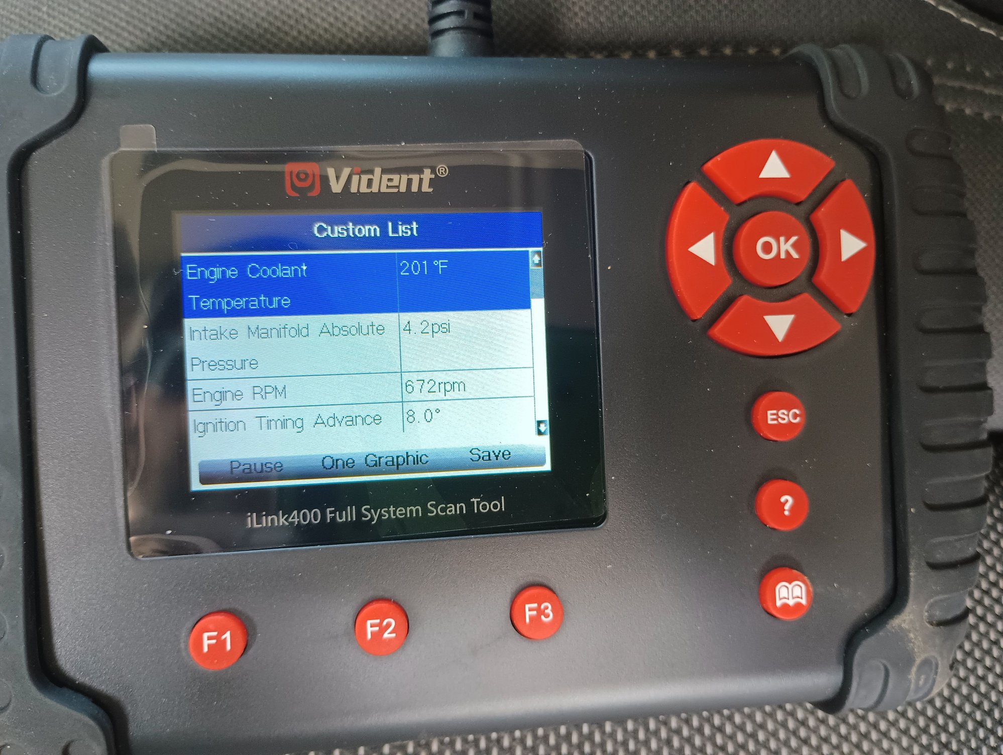

Your cooling fan is junk?
I just checked my '07 system(OEM>clutch/fan, AM>radiator/tstat/ect/waterpump).
Ambient temp:78°, start and let idle until reached max temp., 20+ minutes and stopped @
201° on my scanner. I checked cylinder head temp with IR and @ 201°. I checked both ends of the radiator and @ around 170°.
I increased RPM's and within a minute my scanner dropped to 192°.
On a side note, I had an issue with high temp on the gauge many years ago and replaced the ECT, no problems since, only reaches 1/2 on the gauge to this day.

Not a pusher fan, air needs to be pulled in, directed at the engine. Fan should INCREASE CFM off idle! Increased RPM's=Increased engine temp. I tested mine with the OEM fan and the temp immediately dropped off idle.
