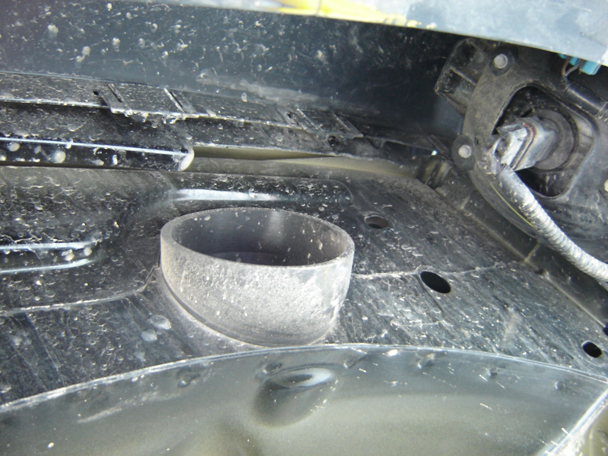

The OEM air intake gets its air from inside the inner fender behind the turn signal. That is already functional, and is the basis for the entry of outside air (air from outside the under-hood environment) into the intake system. The entire inner fender behind the fender liner is open, there is no tubing. We have tested the utter snot out of that OEM intake source and that is why we retain it in all of our H3 systems, the only mod being to the 06/07 inlet through the fender for those intakes. See below:
Snorkels are for the "look at my snorkel" type who think they look cool, but in reality accomplish little.
