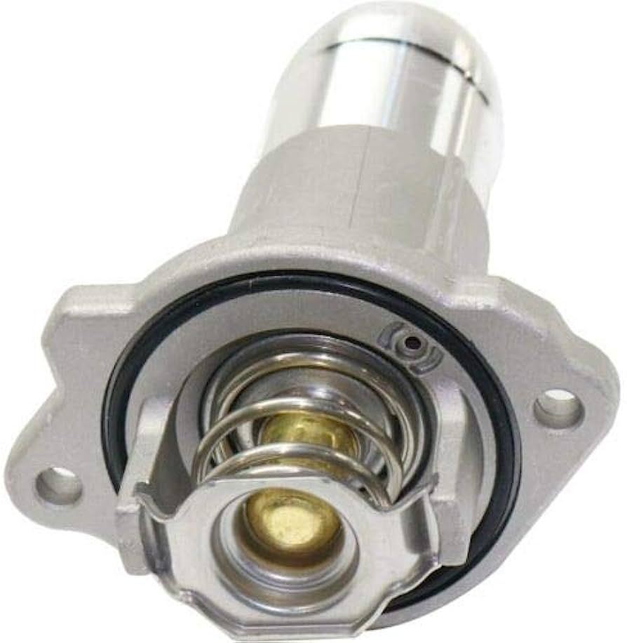

While were on the subject, Hummerz have you done the thermostat move to the top?
And if so did it make a difference?
Old Jul 21, 2023 | 07:04 PM
  #147
Posts: 9,024
NOPE! I did replace the OEM T-STAT with housing many years ago due to low temp(stuck open). Still in the same position, on the drivers side of the block, and never a problem since!

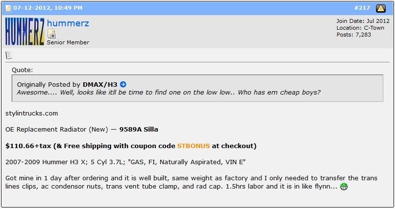

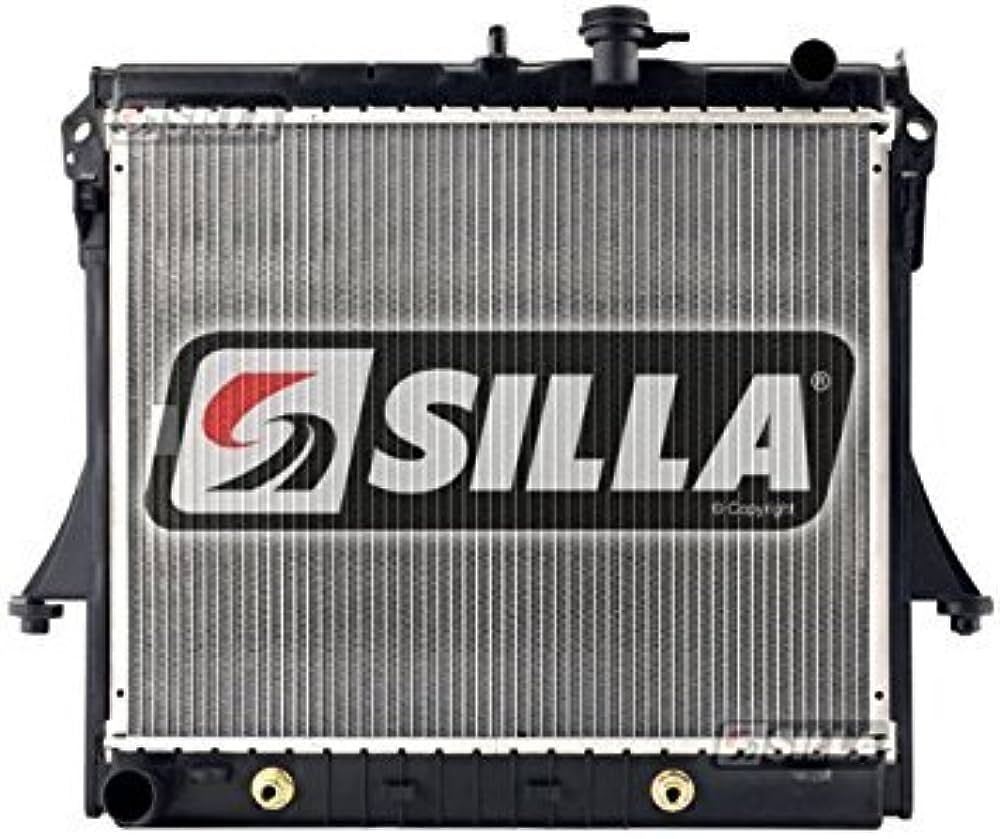

@hummerz do you have an separate cooler/radiator for your transmission?
Old Jul 22, 2023 | 09:53 AM
  #149
Posts: 9,024
NOPE! Still connected to my Silla I installed over 11yrs ago.
