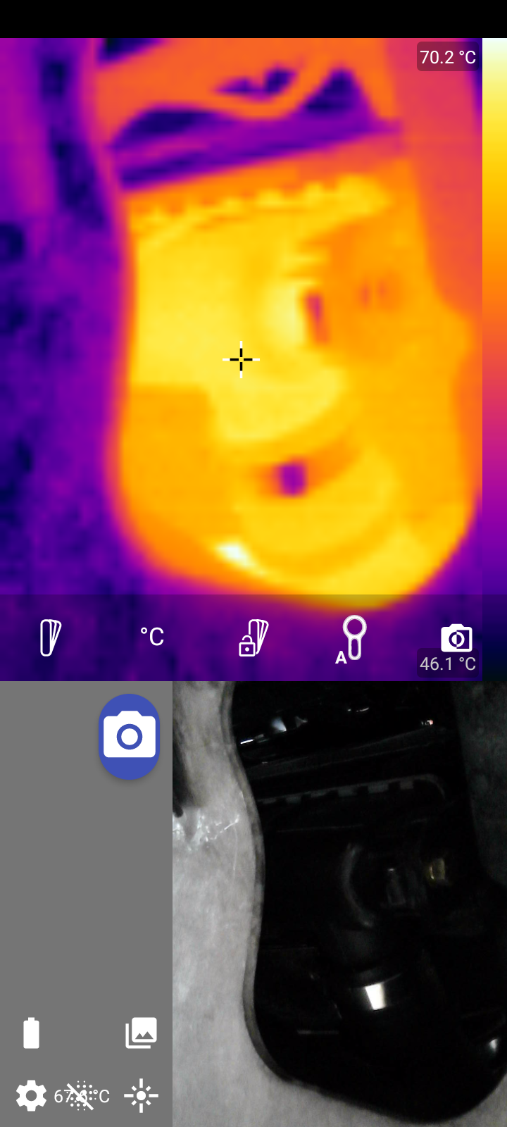

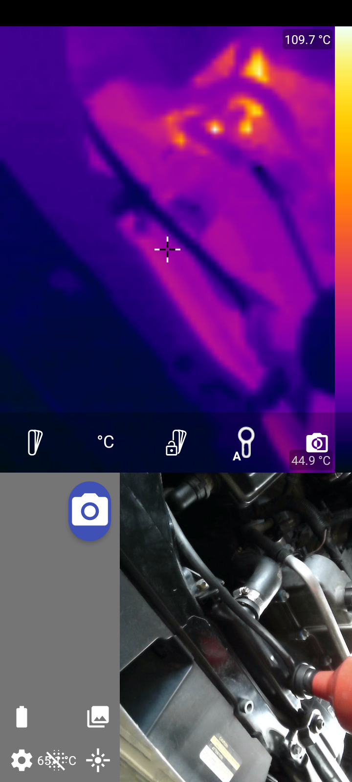

Just double checked using thermal, on top of radiator inlet it's actually about 109C (228F) and bottom radiator outlet is 70C (158F)... Wtf? I am still going to do the flush and see, but is there anything else or is this really considered normal?? If normal, I want to see something from manufacture stating that.
I should add I took those readings while "burping" the system, funnel fitted at the radiator and vehicle inclined. Heater on full.
Hard to see, but this is taken from the bottom of the truck where the lower radiator hose meets the radiator. Aiming right at the outlet, understand plastic is a poor conductor, but we're measuring apples to apples (bottom radiator vs. top radiator) not the actual temp of coolant inside.
Taken from the top, right where the upper hose meets the radiator inlet. Again, not interested in actual temp, just interested in temp difference between top and lower radiator to determine if it's actually cooling the fluid.
As a side note, don't mind the color difference between the two photos. Bottom looks hotter because it's brighter, it just looks that way in reference to surrounding items within the picture frame. Same goes for the top photo. Without temperature reference you'd assume bottom is hotter, but that's not the case.
@Doc Olds I know you mentioned this is normal for H3 in several threads/many threads, do you have any source? I want to believe you and just keep driving without worry, but there's conflicting information I am reading from other H3 owners. With all due respect of course, your thoughts and opinions are greatly appreciated 🙏

You're doing great with the radiator cooling. Your fluid is not getting into the radiator. It's a bottom thermostat problem. Transfer to the top and you will forget about this problem forever.

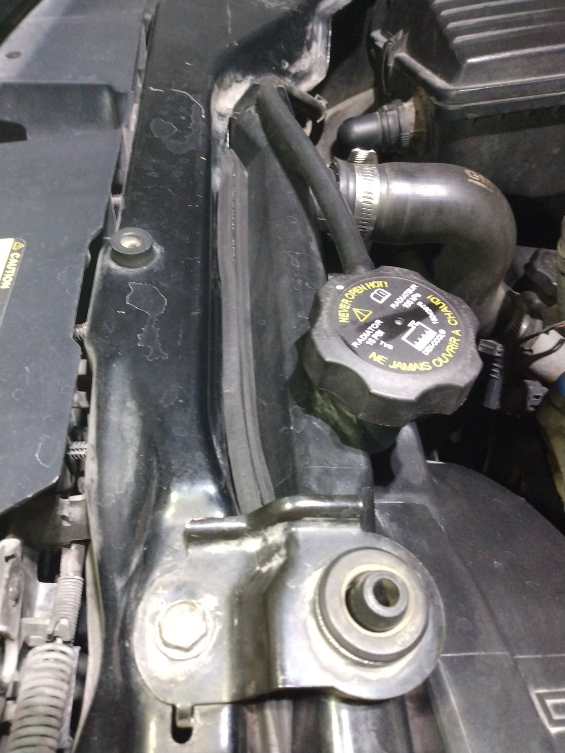

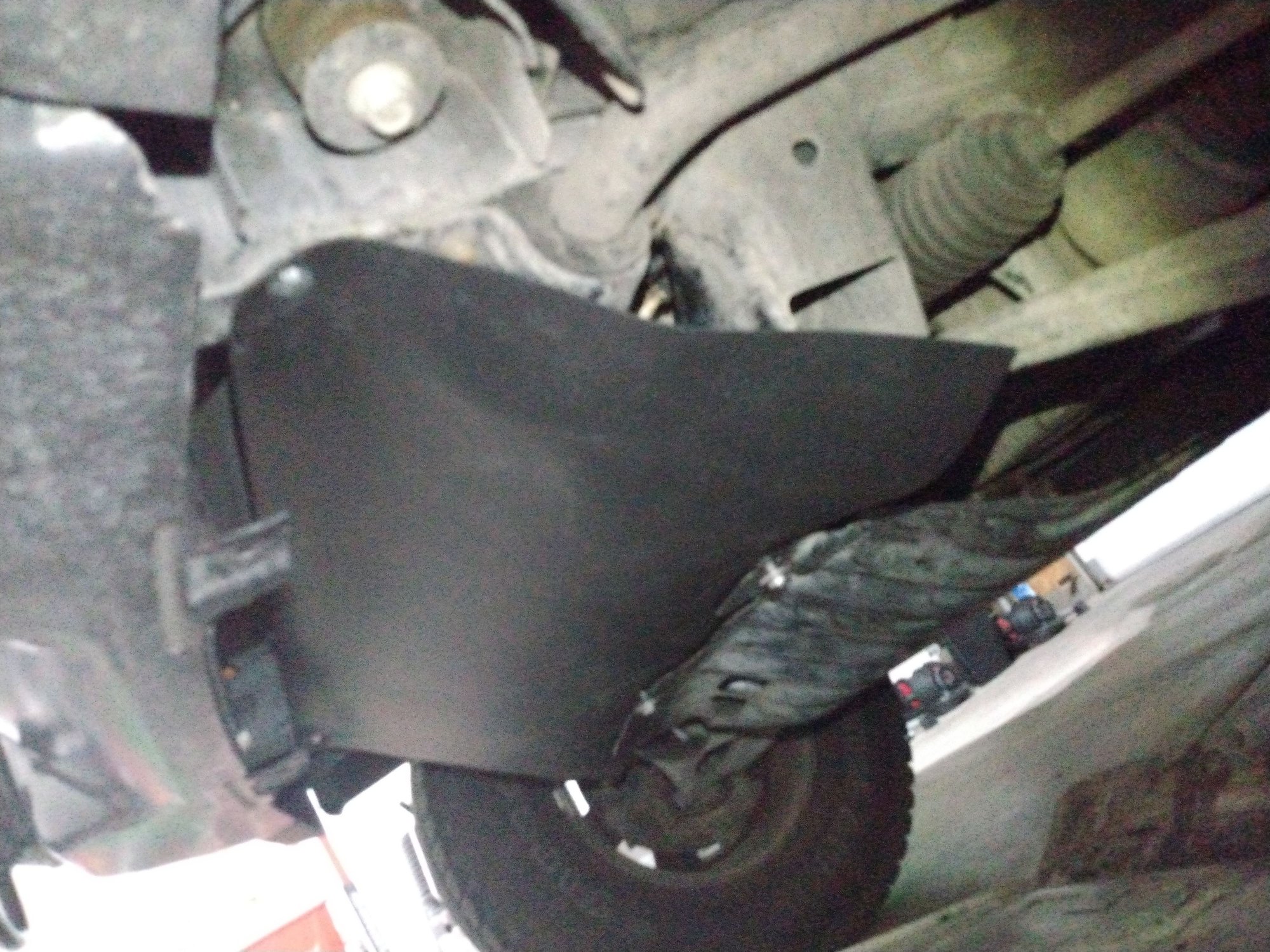

I just replaced the water pump yesterday and added weather stripping on top between radiator and AC condenser coil. Today I went and bought a rubber mat from Home Depot, cut to size and installed it below the radiator, tucked it back behind the skid plate - see photos below.
Some weather stripping on top sealing the gap between radiator and AC condenser coil.
Rubber mat from Home Depot. I actually end up cutting the front a bit and tucking it behind the radiator. There were already pre drilled tapped holes that I was able to attach to.
Went for a test drive and to my surprise it's actually running cooler. Still warm but an improvement overall, only got to 220F briefly on a highway but once on the street 207-208F, got to 215F going up a hill but cooled off once leveled.
I think what might have been happening is the hot engine air was getting drawn in from below and maybe some over the top. I am gonna take the bumper off and do some work up front to better isolate the radiator and redirect air. I think all those baffles, diffusers, seals, etc. play an important role herre, air flow is critical for proper heat transfer. Removing those baffles/diffusers may not make a difference in some driving situations, but when it's 100F + outside and conditions are extreme, every little detail counts. I was surprised seeing my temperatures drop while sitting at the light, before it would just keep rising. One other thing to note, my Intake Air Temp was 130-140F not sure if that's an indication of anything.
I am going to keep tinkering with it and do more test drives tomorrow to be sure. I take the same route every time and note where I start to notice heat increase. Ambient temperature was 106F this time around, I'll check again tomorrow when it's 112F and sun out.

Update: took another test drive 111F outside AC full blast. I can definitely say engine is running cooler especially when stopped or city driving, getting 205-208F. However once the transmission temp start to creep up to 235F engine will stay between 215-217F and gets worse on the highway. I'll get 220-221 on the highway traveling about 65mpg and RPM below 2k so the fan is not really doing much. Once I am off the highway, city driving, accelerating and hearing the fan going brings the temps down. Transmission seems to stay pinned at 235F.
I think the added seal on top and skirt on the bottom helps during idle, but at highway speeds I suspect the missing baffles/diffusers is not allowing adequate airflow through the grill and radiator. I believe the baffle as mentioned earlier in this thread is used to produce high/low pressure environment (Bernoulli's principle) which helps with airflow within the cavity between the grill/pumper and radiator. @hummerz you mentioned that air no longer goes through the grill in modern cars but rather over the grill due to EPA? Correction: you said most of the air will not go through the grill because of EPA, therefore it's best to seal air intake (I think you meant as in air going into the grill, not the actual air intake) on all 4 sides. Sorry, had to re-read what you said.
