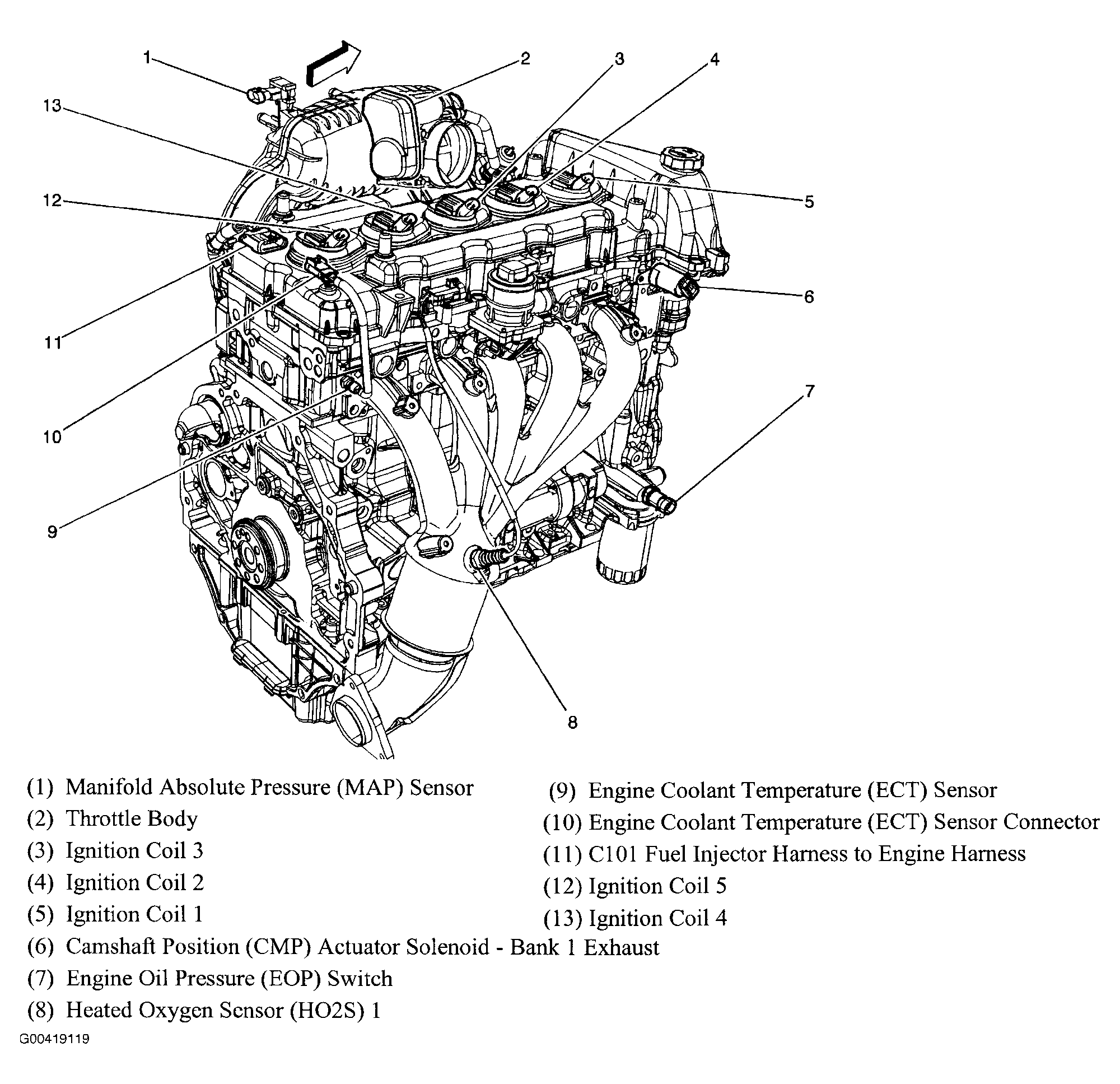

The TStat is at the Radiator Inlet side,(#954 in 305) which is outlet of coolant from the engine, so it is acting on the engine heated coolant. It stays closed at start up to build engine temp rapidly until warm enough to begin to open and allow flow out of the engine back to the radiator. Your upper radiator hose is the outlet from the radiator heading into water outlet (#308) into the engine to the water pump (#300) at the front to be pushed through the engine/system.
The gauge gets its feed from the ECT, but just points and does not display actual temp. It is located at the back of the block to measure engine heated coolant. #9 below.
A scan tool displays -38°F to +284°F. The Engine Coolant Temperature (ECT) sensor is mounted in the coolant stream. The powertrain control module (PCM) applies 5 volts to the ECT sensor circuit. The sensor is a thermistor which changes internal resistance as temperature changes. When the sensor is cold (internal resistance high), the PCM monitors a high signal voltage and interprets it as a cold engine. As the sensor warms (internal resistance decreases), the voltage signal decreases and the PCM interprets the lower voltage as a warm engine.
None of this measure the coolant exiting the radiator, which is always significantly cooler than what is inside the block. How much, 10-25F cooler always. Obviously, it has to "cool" the engine, or the system would not keep temps under control. I have a digital temp controller on my SFan4500 Efan that operates on the outlet side of the radiator on my 09 Alpha (not an I5 but near identical radiators and locations and more motor making heat) and it is always 15F + cooler than the actual ECT numbers.
Whether the TStat is at the top, or bottom, doesn't matter, the cooling system is till doing the same thing. None of this mentions the PCM's role in maintaining temp either. Get those panties out of the wad and relax for the big picture instead of staring at an idiot light with a needle.

With all due respect, I don't think you're correct about the coolant inlet/outlet location. Unless the diagram you're showing is incorrect. In your diagram, part #308 is actually the water outlet - see highlighted below. This means that the lower radiator hose and thermostat housing is the inlet to the engine. Thus the t-stat is acting on cooled radiator coolant rather than engine heated coolant as you're suggesting. Or is there more to it?
