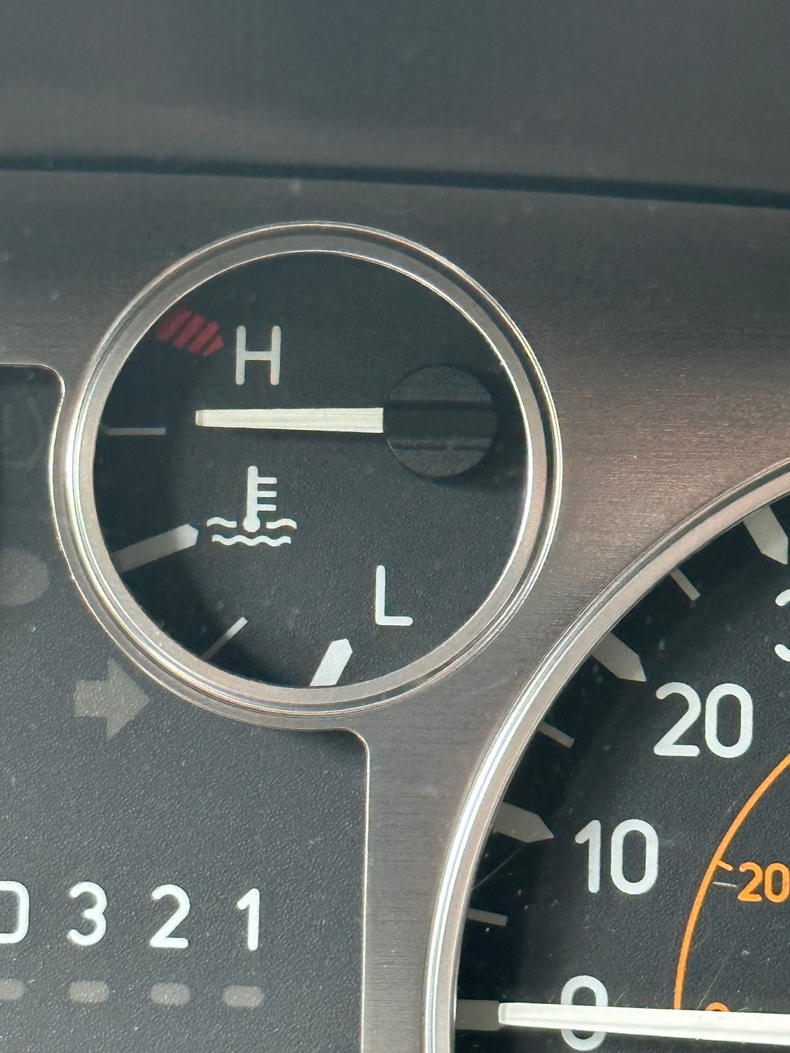

What i was at
What my temp gauge is at now.
