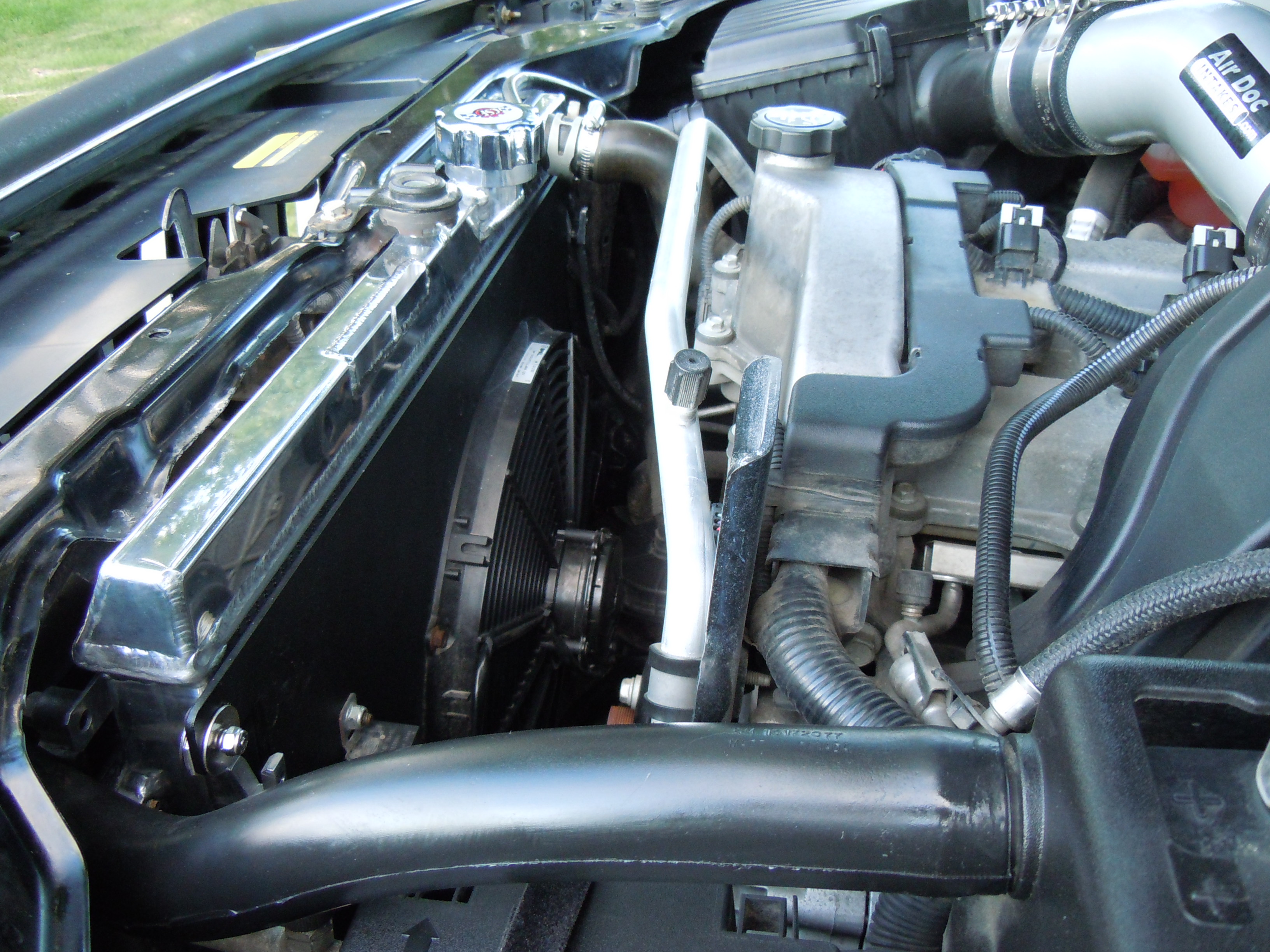

More than likely, you have the oh so common radiator leak. This is what happens when GM sourced Asian crap radiators, the plastic tanks can separate top or bottom, or perhaps just as commonly, the top radiator mount bracket rubs the plastic top tank and eventually cracks or wears through it.
You can search around for threads on this, there are a ton. Here is a link to the over the top blah blah blah thread damn near everybody and there brother has posted in. https://www.hummerforums.com/forum/h...-leaked-21184/
There are better and more useful threads on the topic, but you get the idea.
Rinse it off under the hood, let it dry, then start the engine and let it reach full operating temp, and see where it is spitting..
