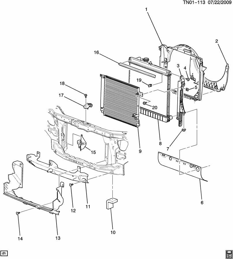

That's what the troubleshoot guide is referring to when they say inspect "the seals"? Mine are missing sheesh my truck is missing a lot of stuff, no wonder it runs so hot.

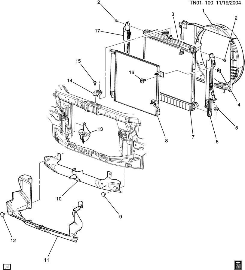

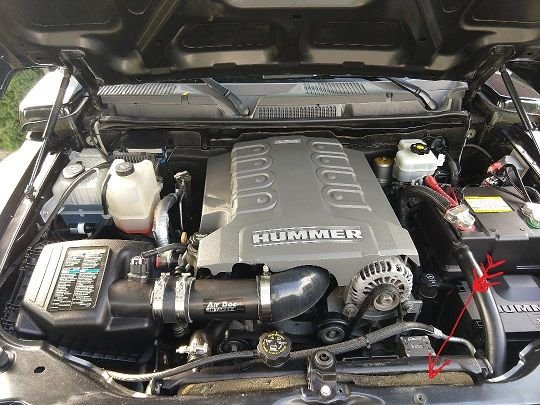

The #5 is like a 3/4" - 1" wide foam weather-stripping squished and glued in place. When they get old the adhesive wears out and they blow out and disappear. I had to shoe goo mine to keep it put. Buy some weather-stripping and stick it in there.
I would say both of those are more important than the plastic deflectors out front. I cut the plastic deflectors out to accommodate the Mile Marker 9500 winch in the BA Winch Bumper and it does not run hot at all. Again, in MI it is not going to get 100F+. We usually only see 12-15 90F+ days all year.

Originally Posted by NMH3
Thanks Hummerz. Do you think that seal is going to be most of my problem? The seal is so far out of the way that I thought maybe it had something to do with being able to drive through water vs directing air through the rad.
Both the baffles you indicated, plus the seal on top between rad and frame, are all there.
With EPA fuel economy regulations, most of the airflow does not penetrate the grilles while driving. Best to keep the air intake from the grilles sealed on all 4 sides, directing air to the engine, to prevent overheating!
it's silly to compare V8 and I5. they are different engines. different cooling system. the I5 is poorly done. so I moved the thermostat to the top and put electric fans from Chrysler. no more overheating.

Mr. Silly, that is what they call me, just silly me pointing out the freeking Upper Radiator Seal that NMH3 asked about. MY Red Arrow in the pic was spectacular I would say, almost genius if I were not so silly.

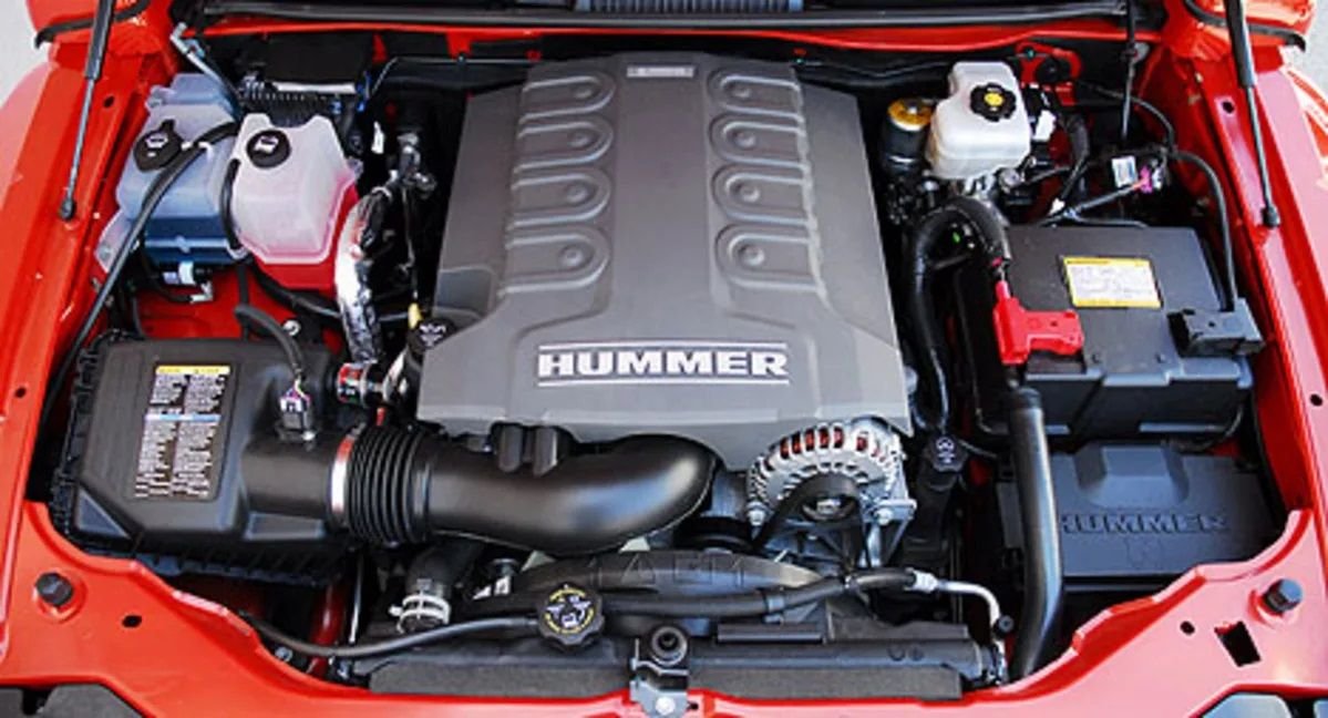

All H3/H3Ts have identical radiators, coolant reservoirs, Radiator Caps, overflow hoses, mounts, baffle and operate at the same pressure using Dexcool. I'd say that was the same.
I5s
V8s

Waiting for a few parts in the mail, only thing I am not able to obtain unless I order a used one is the bottom seal/rubber flap.. weather stripping I'll do today that's easy. Might even seal off the sides where the fan shroud meets the radiator.
