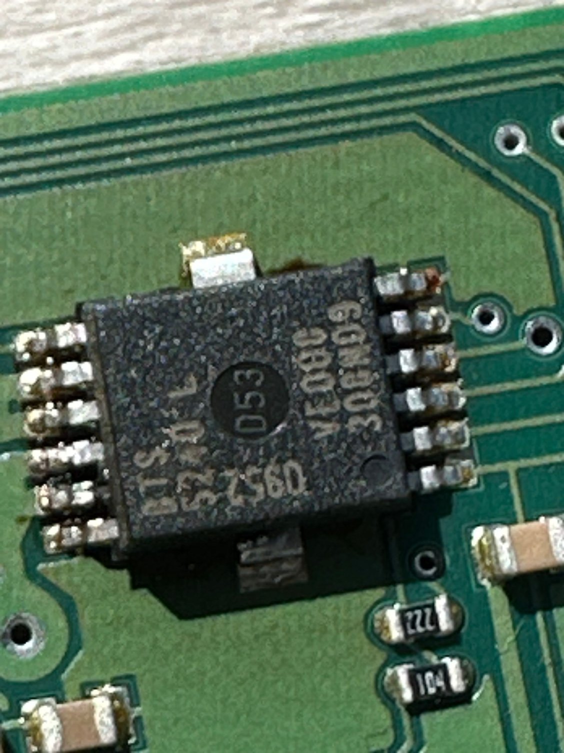

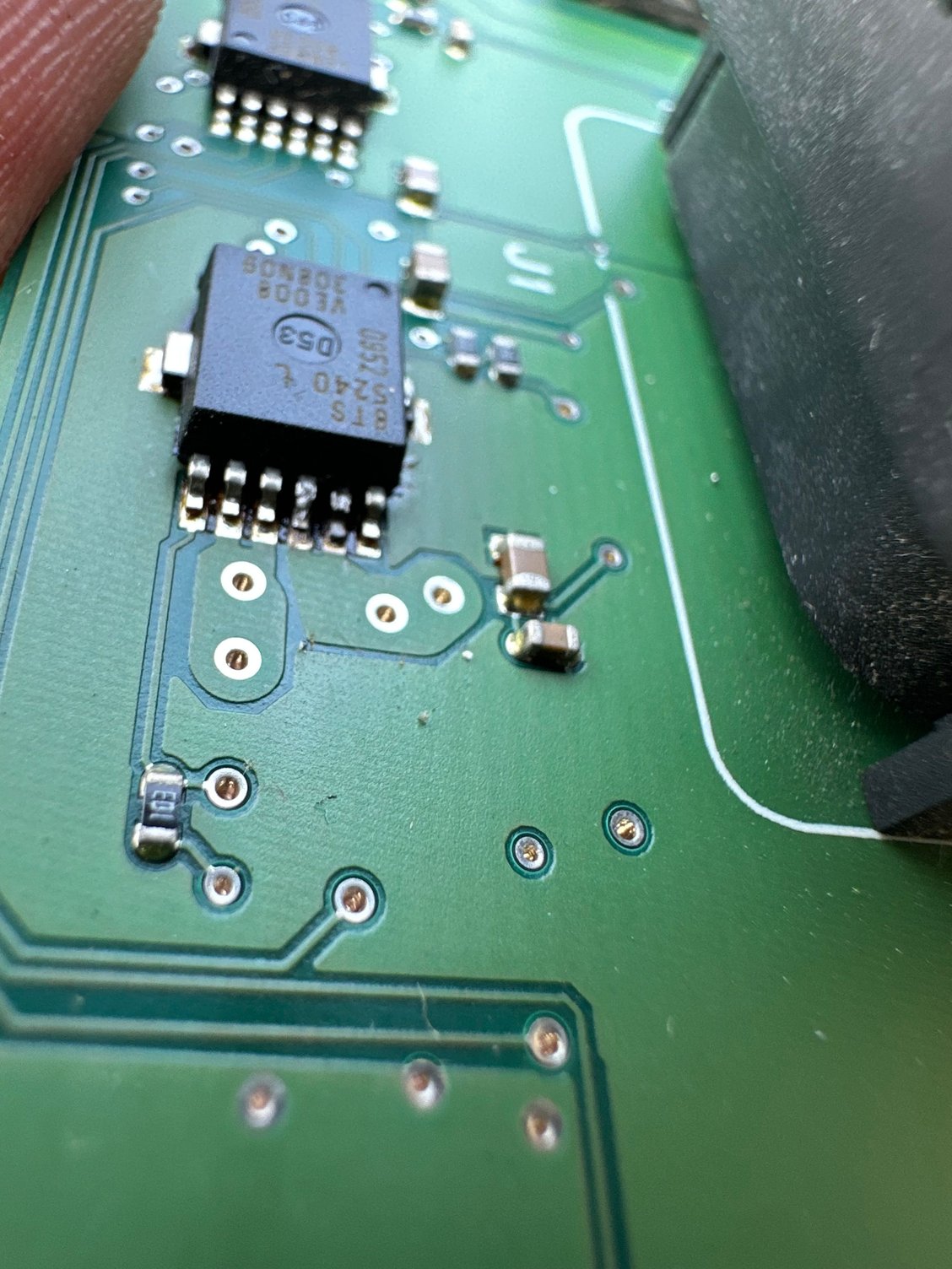

So, let me get everyone's thoughts on the update. I after replacing the BCM, The brakes and turn signals stopped again after a few days. I noticed the Fuse to the brake light was blown. I replaced it and the right side brake light came on and wound not go off. So, I pulled the BCM back out and discovered that 3 or the 4 prongs on one of the chips was melted. I have found another BCM. I can't find what would be causing that kind of damage. I have physically traced as many wires as I could uncover, checked the circuit for shorts and even disassembled all the grounds and cleaned them all to bare metal and reinstalled with dialectic protective grease.
So, if anyone has any ideas for me to try I would appreciate it. Also the wires to the Fues box look discolored. should I source a better fuse box and supply wires ?
