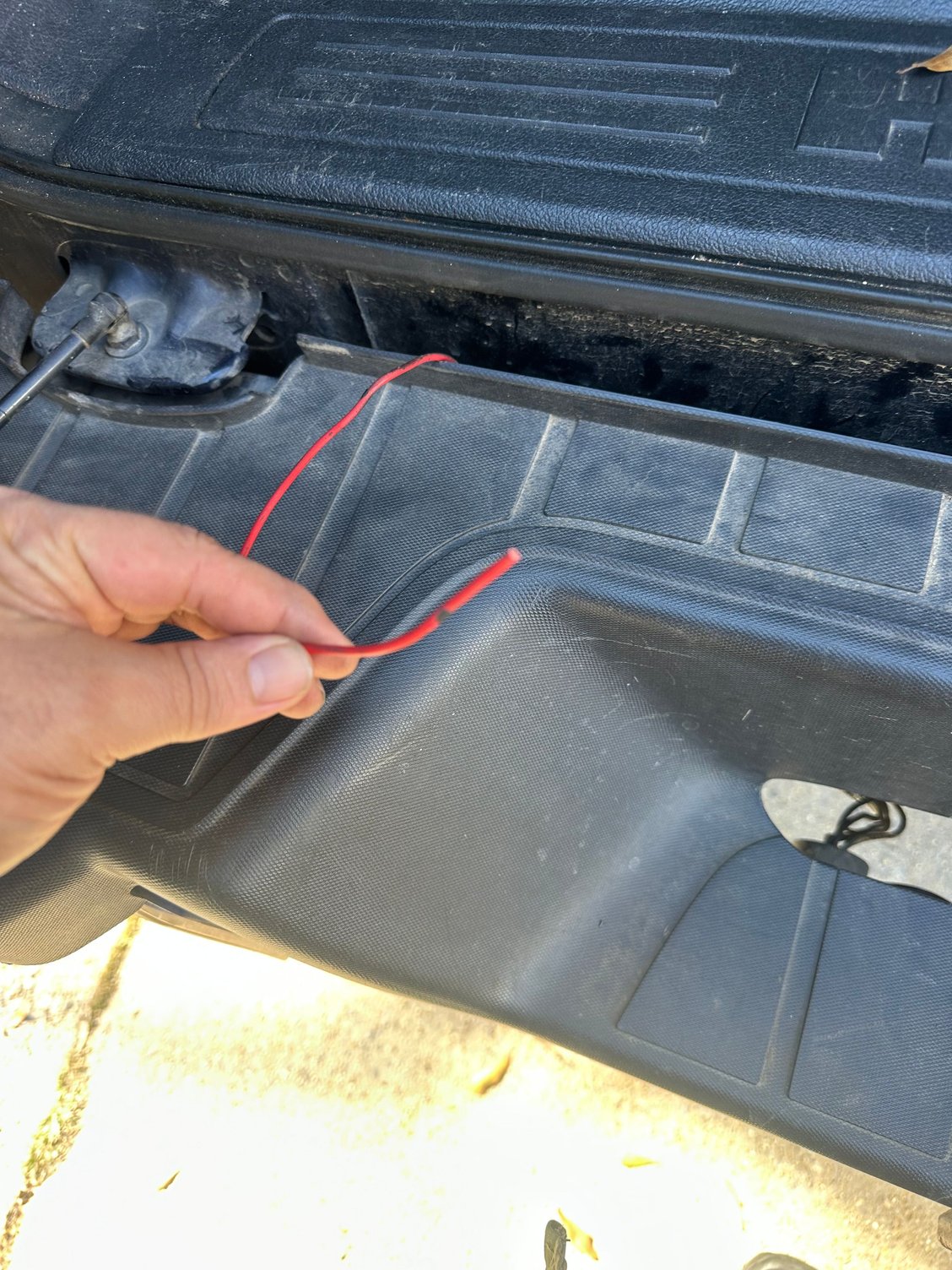

i did find the one red wire that is hot bit didnt see anywhere it should be connected.

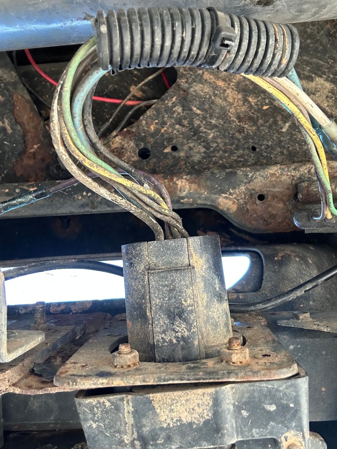

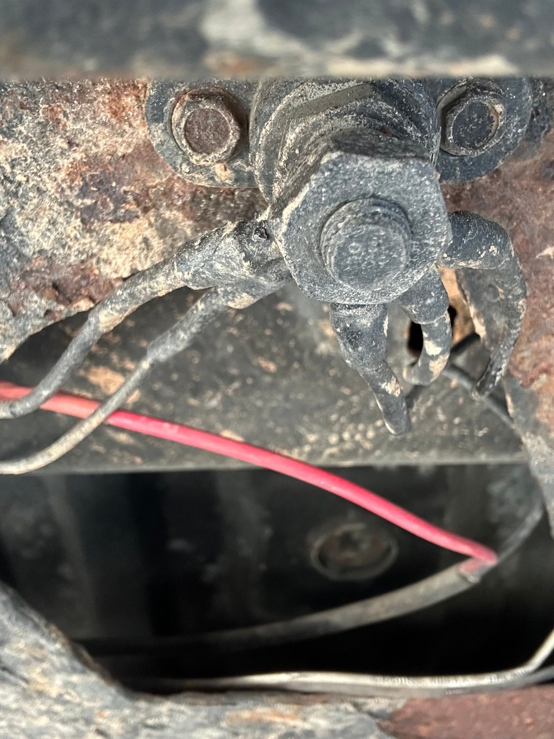

that ground does not look too hot. maybe take it apart and hit it with a wire brush or some sand paper. if that stud is held on with the other bolts i would probably want to expose some fresh metal on the mating surfaces as well. might have some rust scaling behind it. also maybe check inside of that short piece of wire loom at the hitch maybe its hiding something.

Took the ground apart cleaned everything and no change. The wire cover wasn’t hiding anything. The tag light works Can’t recall who asked that.
replaced both brake light harness with new ones. Checked all the wiring to my ability several times.

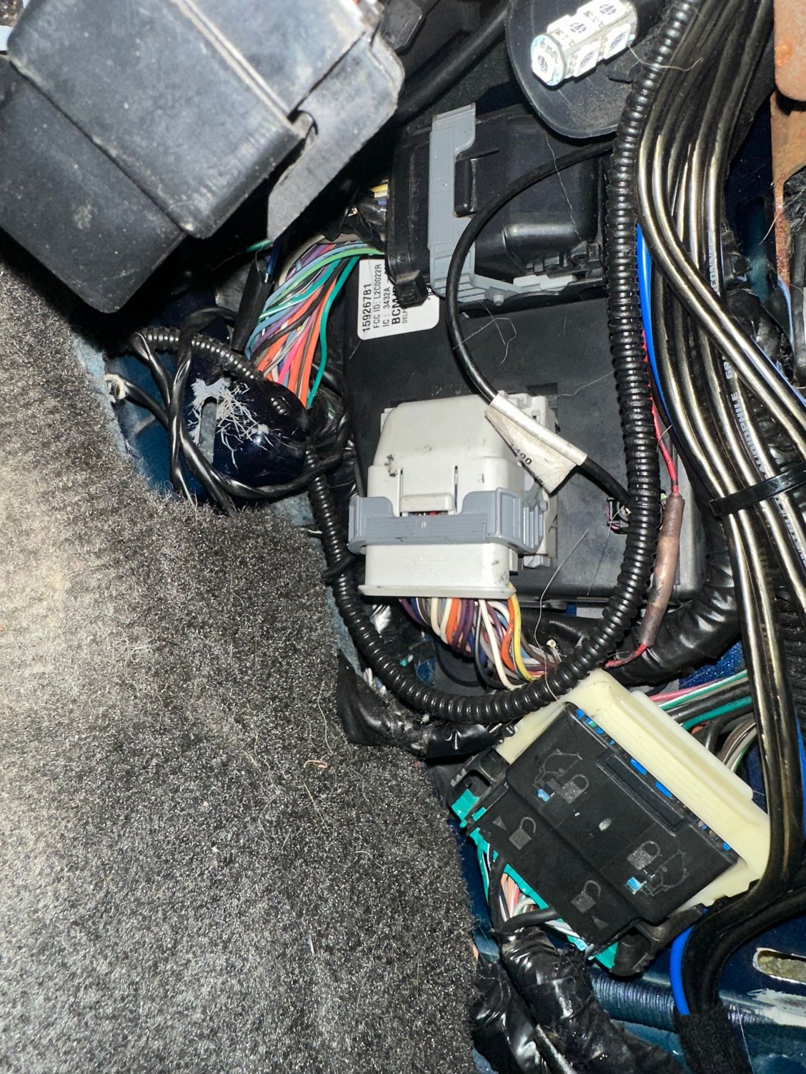

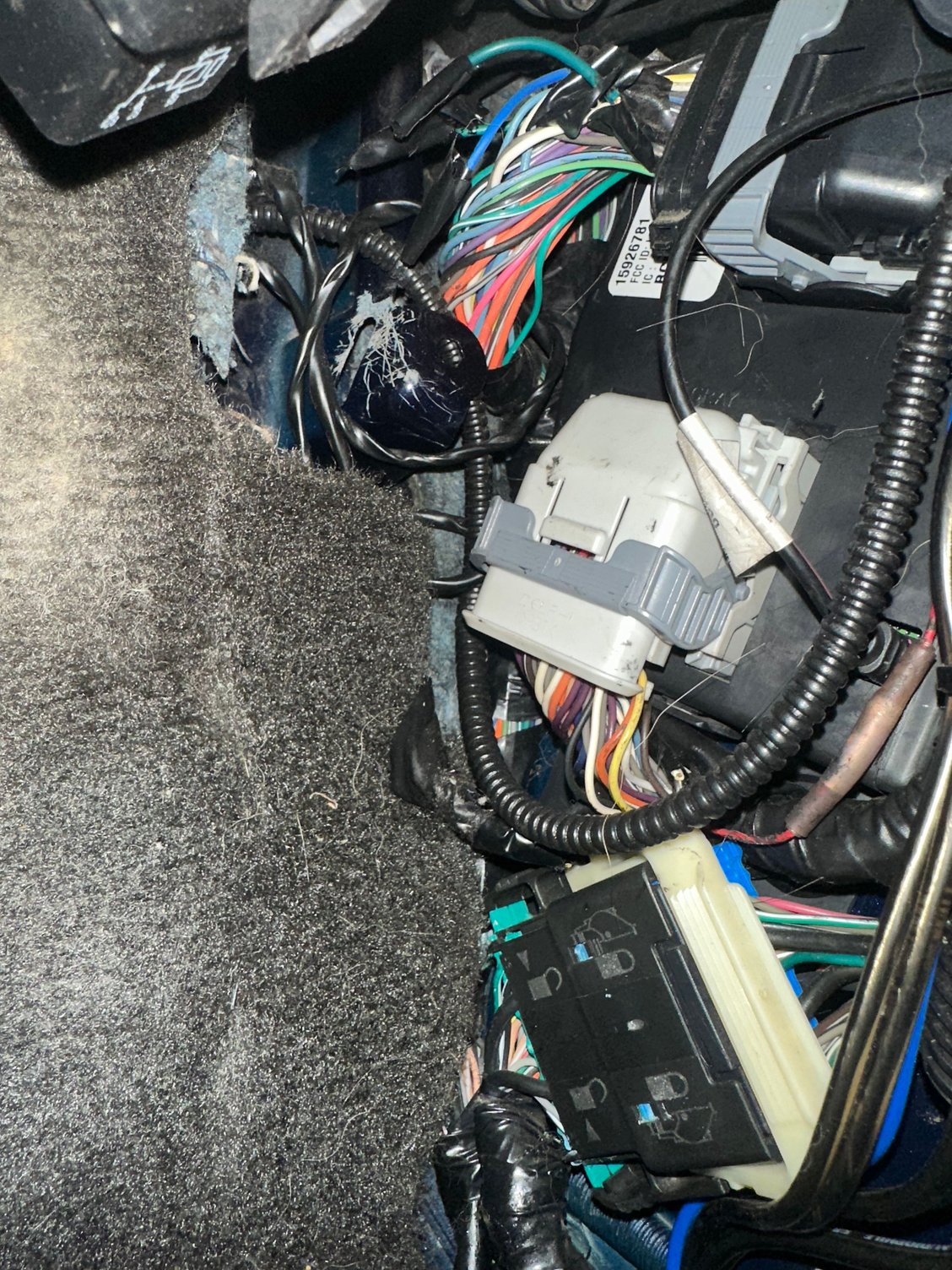

Someone has cut a number of wires from the BCM top connector (two green, one blue) and spliced in a new wire (red) off the bottom connector. Maybe you can match those wires up to the images Hummerz posted and figure out what they are for.

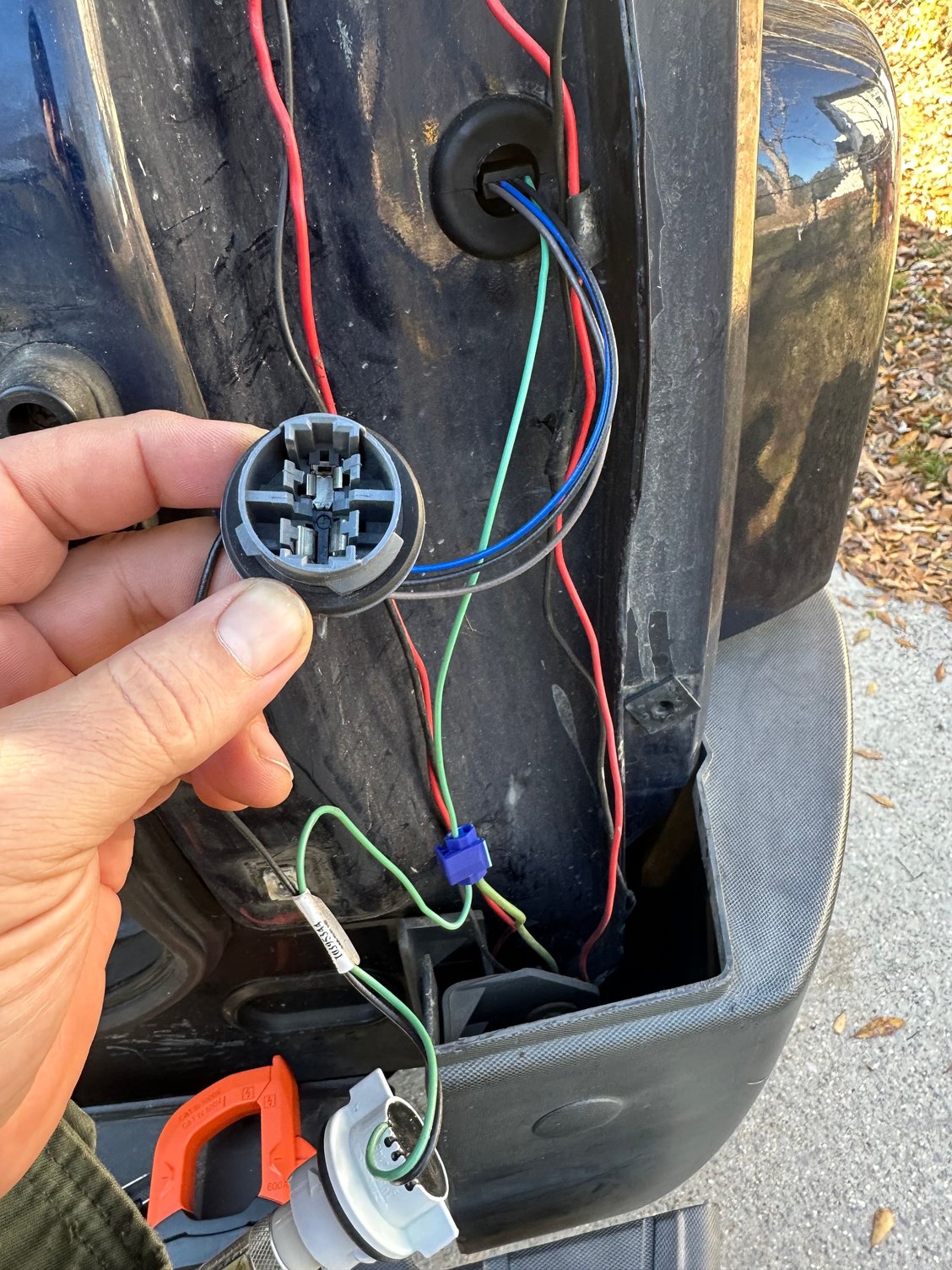

The tail light wiring similarly had added wires (the red ones) and splices (on the green wire) not present in the factory wiring. All bets are off until you figure out how its been rewired and why they did it that way. At this point the factory wiring probably isn't much help.
Looks to me like that ground stud is the one of the left side of the rear cross member. If so, it has some extra things added to it from stock. In stock configuration that stud is used only for the fuel pump sender, the license plate lamp and the trailer connector. One by one give those wires a tug and see if they pull free - that area is a hot spot for corrosion. On my truck those wires had corroded internally and had to be repaired.
Wtf? No broken wires? Someone hacked the harness in all your pictures which needs attention to restore!
Start by removing that blue quick wire splice connector then check for battery voltage with brake switch on to the green wire.

Also check/post any markings on the lock box tapped into the bcm with the burnt red wire:

I’m not sure what the red wire gos to but it looks over heated.
The green wire in the back seems to be a ground. no idea wtf it gos too.
