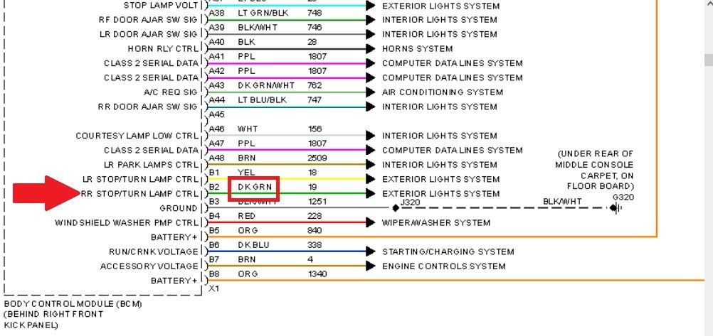

Did you look at the wiring diagram posted above? Dark Green> Right Rear Brake Light Turn Signal

Old Dec 23, 2024 | 04:41 PM
  #33
Posts: 9,018
The dark green wire also goes to the trailer wiring.
Heavy-Duty Trailer Wiring Package
The trailer towing harness contains the following
seven trailer circuits:
• Yellow: Left Stop/Turn Signal
• Dark Green: Right Stop/Turn Signal
• Brown: Taillamps
• White: Ground
• Light Green: Back-up Lamps
• Red: Battery Feed
• Dark Blue: Trailer Brake
Light-Duty Trailer Wiring Package
If your vehicle is not equipped with a trailer
towing package, the chassis harness will
contain the following blunt cut circuits:
• White: Ground
• Brown: Tail Lamps

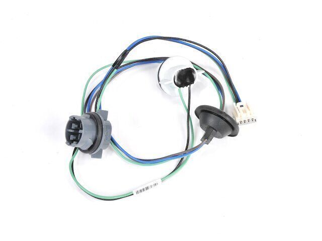

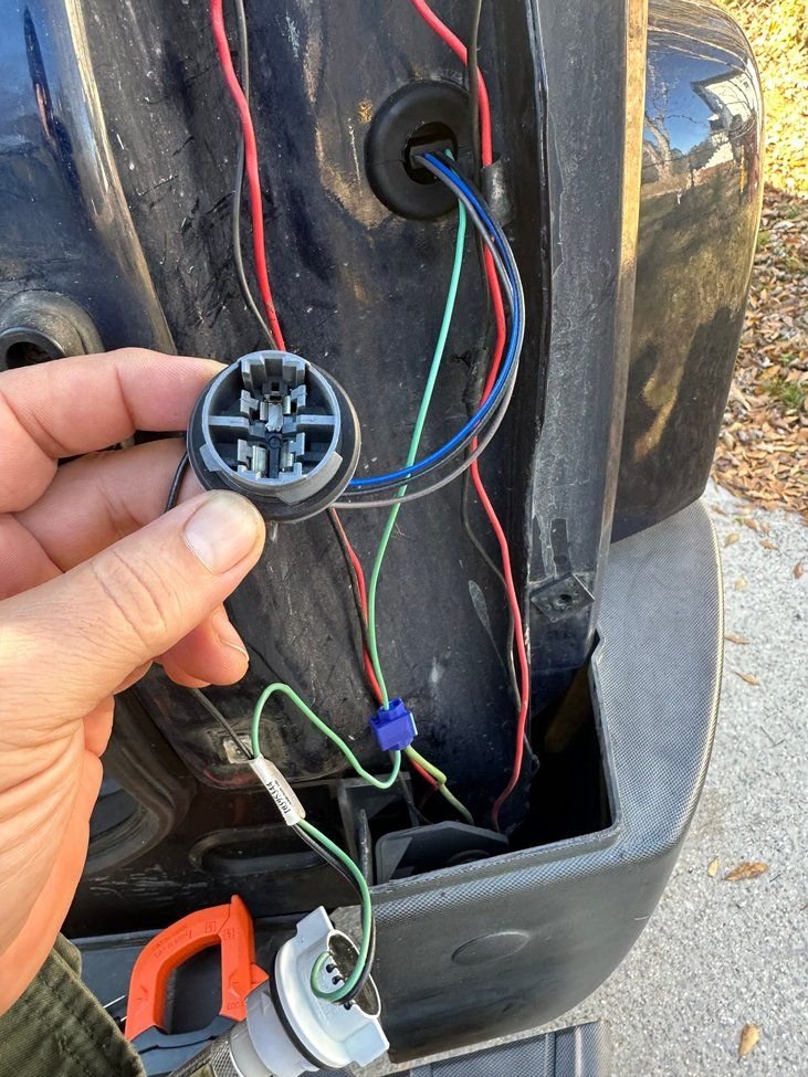

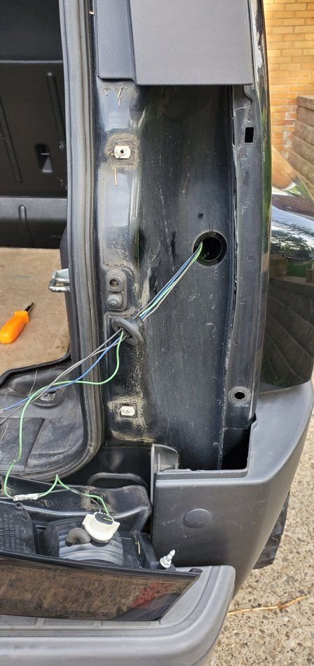

Observe pics below!
OEM factory(4 wire harness) compared to your RR taillight wiring:

Yeah im trying to figure out what all that mess is.
I’ll recheck the trailer connection as well.
gonna get back on it tomorrow.
ill update if anything changes.
i was wondering if anyone else had all those wires behind the lights like that.
now i know 😂.
Old Dec 24, 2024 | 06:44 AM
  #36
Remove the scotchlok connector since it isn't connected to anything and repair the wire with solder and shrink wrap with sealant.
Then proceed with your testing/probing.
