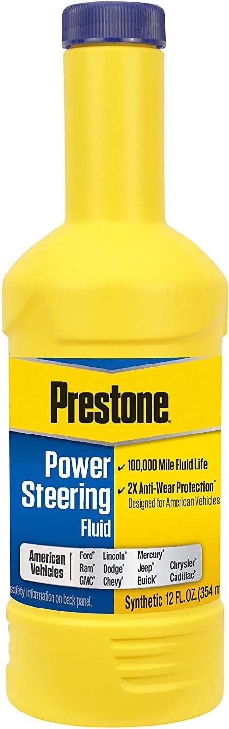

Got it haha. I'll pick some of the SeaFoam spray on my way home from work tomorrow morning. I have to get some power steering fluid to do a flush, as well.
The old PCM was never updated with the 3.7L swap. I am probably going to buy the HPtuners tool soon so I can segment swap for the engine, adjust speedometer, and play with the shift points. I want to make sure some of the weird little problems aren't related to the PCM thinking it is still running a 3.5L. I wish HPtuners had a diagnostic setup similar to the Autel tool, which I would love to have, too. Maybe one day. I figure having the tuning tool will be helpful for learning more and being able to tweak along the way. I did consider a mail order but think the tool is more consistent with my style.
