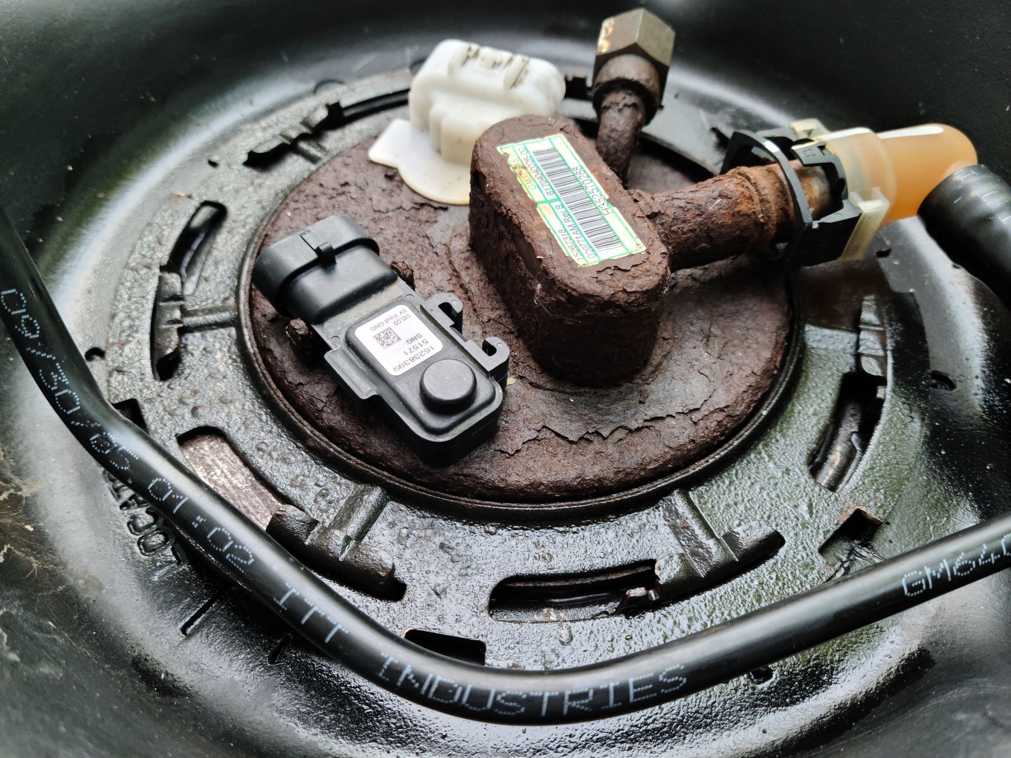

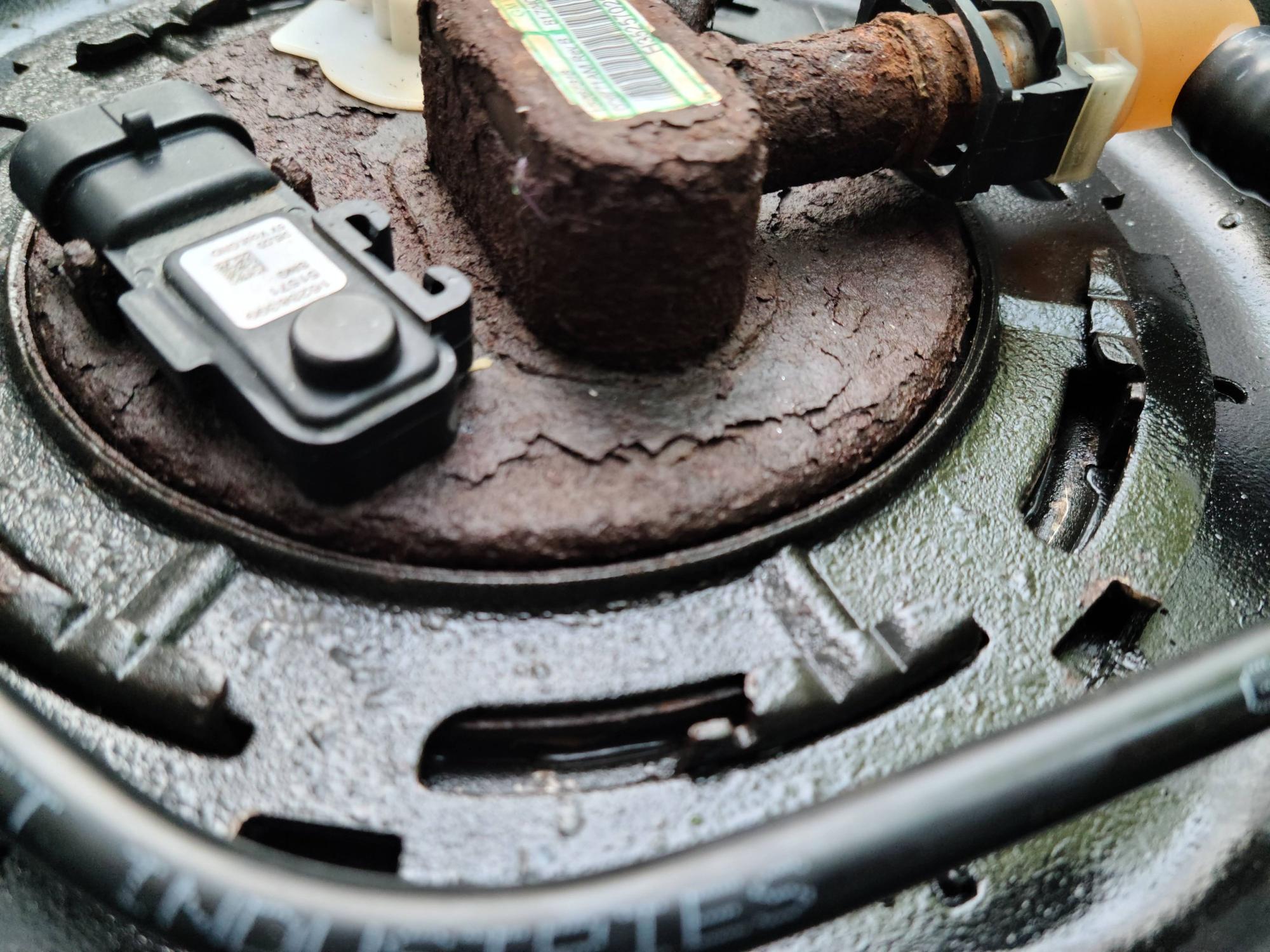

Btw, I see a lot of damage on the locking tabs. Make sure to tap on the ring only.

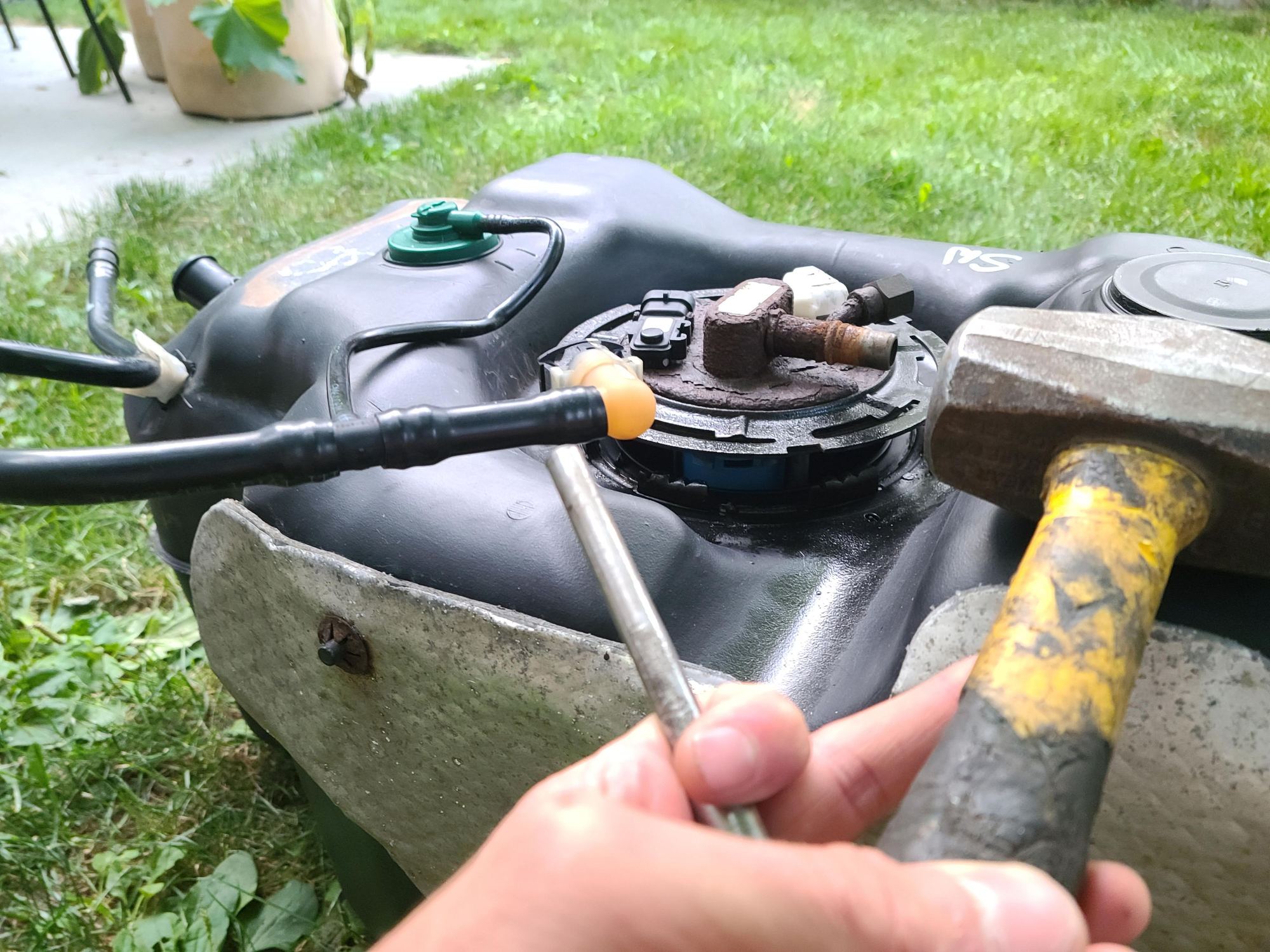

Any damage on the locking tabs was already there (I promise)! I only struck where you drew arrows (using the brass drift) and had no luck. I will spray some penetrating oil on it. The tool arrives tomorrow, so I'll just wait it out.
idk but from the picture the lock unlock emblems on the tank do not coincide with the way the tabs taper to wedge the lock ring. looks like lock is unlock.
I'll keep you updated on if it comes off or not. I'm hoping the tool will help!

Your tool could do more harm than good? Time to take control, don't be afraid to tap that lock ring! I've removed hundreds over the years, takes less time on the metal tanks when severely rusted, I just used a cutoff tool/air chisel. Just make sure to install a NEW lock ring! Watch the video I posted above!
Edit: MAKE SURE YOU'RE TAPPING COUNTER CLOCKWISE ON THE LOCK RING! Also check those lock tabs that appear damaged.

Tool snapped. Plan B. Still no success with brass drift. I did watch the guide you posted yesterday. I don't think the lock tabs are damaged, but maybe! I have only tried counter clockwise (tapping and with the tool). It looks like if I bent those lock tabs upwards, it would come off quite easily. Should I bend them up or just carry one with brute force?

Why don't I see any punch marks on the lock ring?
I can see them haha. I'm using a brass drift and a dead blow mallet. I have other "weapons" in the arsenal. I will try a large diameter pin punch and my 3 lb beauty.
Damn you... I might just have to give you those rims.
The 3 pound "attitude adjuster" and a pin punch popped it right off. So much for wasting my weekend waiting on the tool (which snapped in 1 minute). Now I have to bicycle to work tomorrow because I won't have it re-assembled in time!
