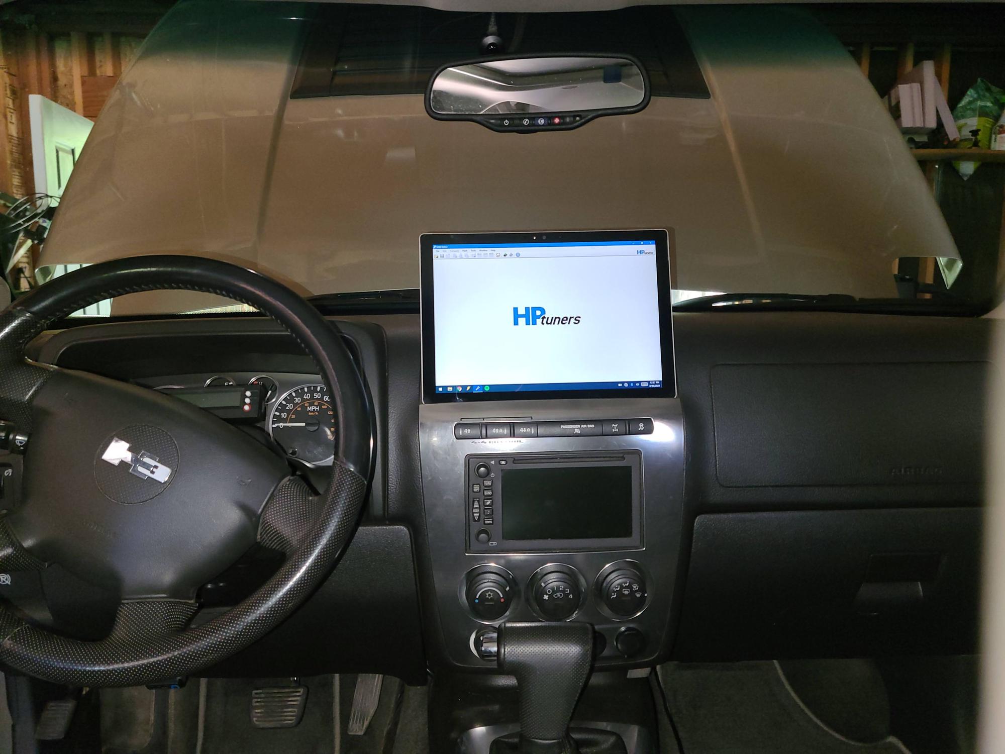

Default Infotainment Sneak-Peak
Still in the process of this conversion, but I think it looks great so far!
My plan is to completely remove the head-unit and then install a hidden Bluetooth amplifier. The amp will act as the stereo controllable via Bluetooth (either on my phone or the tablet) for navigation and music. The tablet also will serve as my datalogging device, which also connects to my MPVI2 HPtuners dongle via Bluetooth. In the cavity left from the factory head-unit, I plan to create a power zone with two hidden wireless chargers so the phones can ride in there along with keys or whatever. This power zone will pretty much just be another glove box (possibly w/a door on it eventually). The air vents will also be re-routed to this "cavity" so the A/C and heat can still flow from the center area of the dash (I know heat would not be good for the phones in there). I'm super excited about this and can't wait until I have more time to get it all setup. Another cool benefit will be the ability to flash different "tunes" on the fly. I can have a tune for economy/commuting on it most of the time and then switch to a more performance oriented tune when I am in the mountains or off-roading. I bought the tablet for cheap off FB marketplace and it fits this spot perfectly.

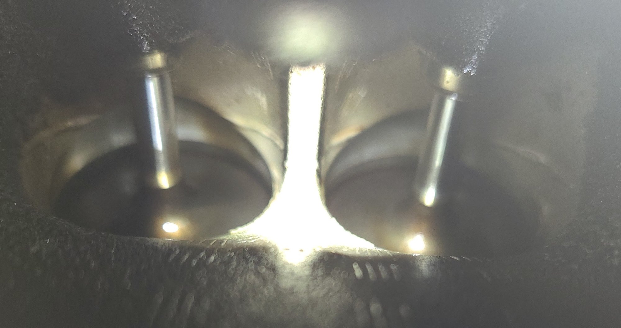

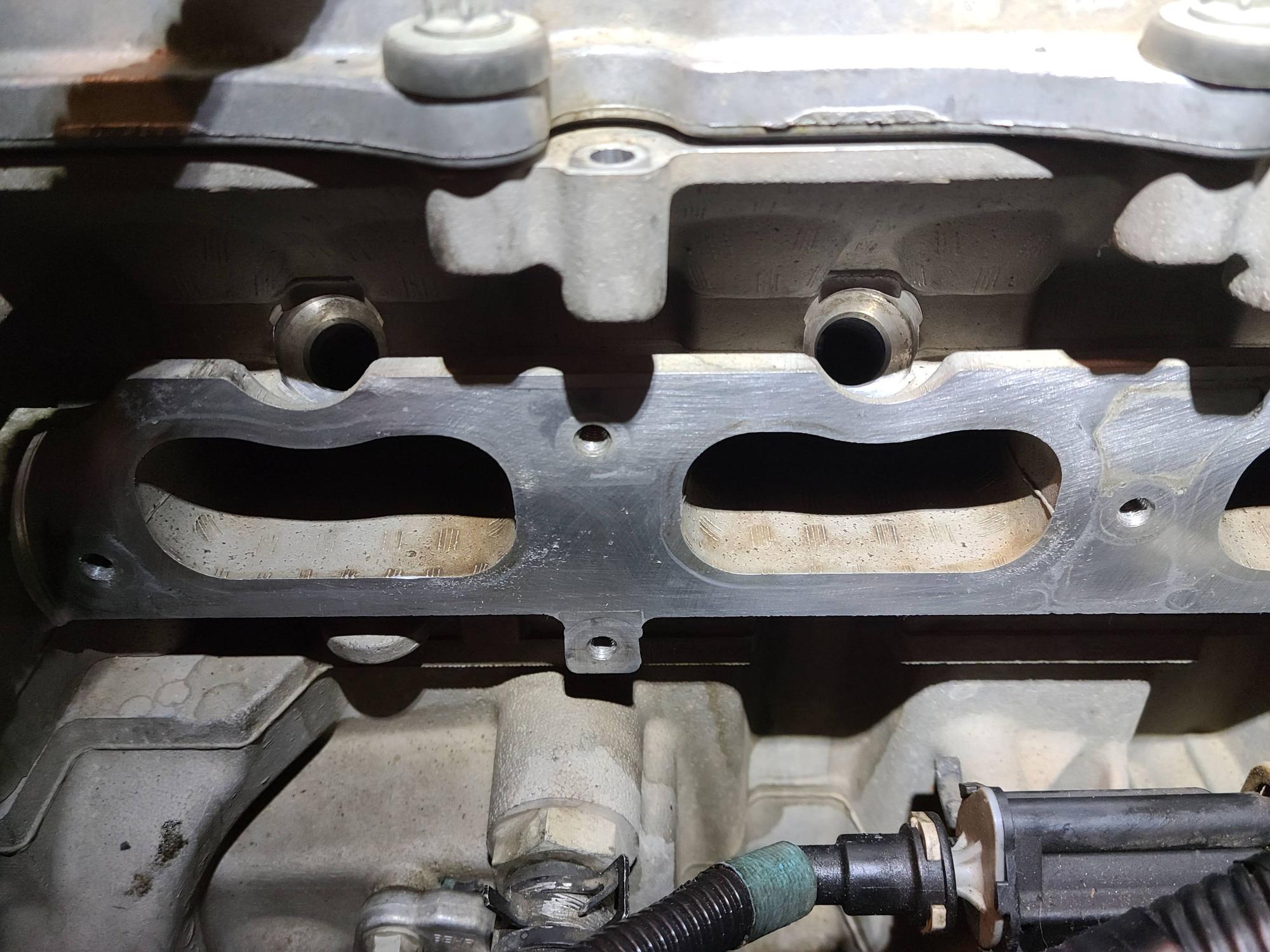

Also, my intake valves are gorgeously clean.

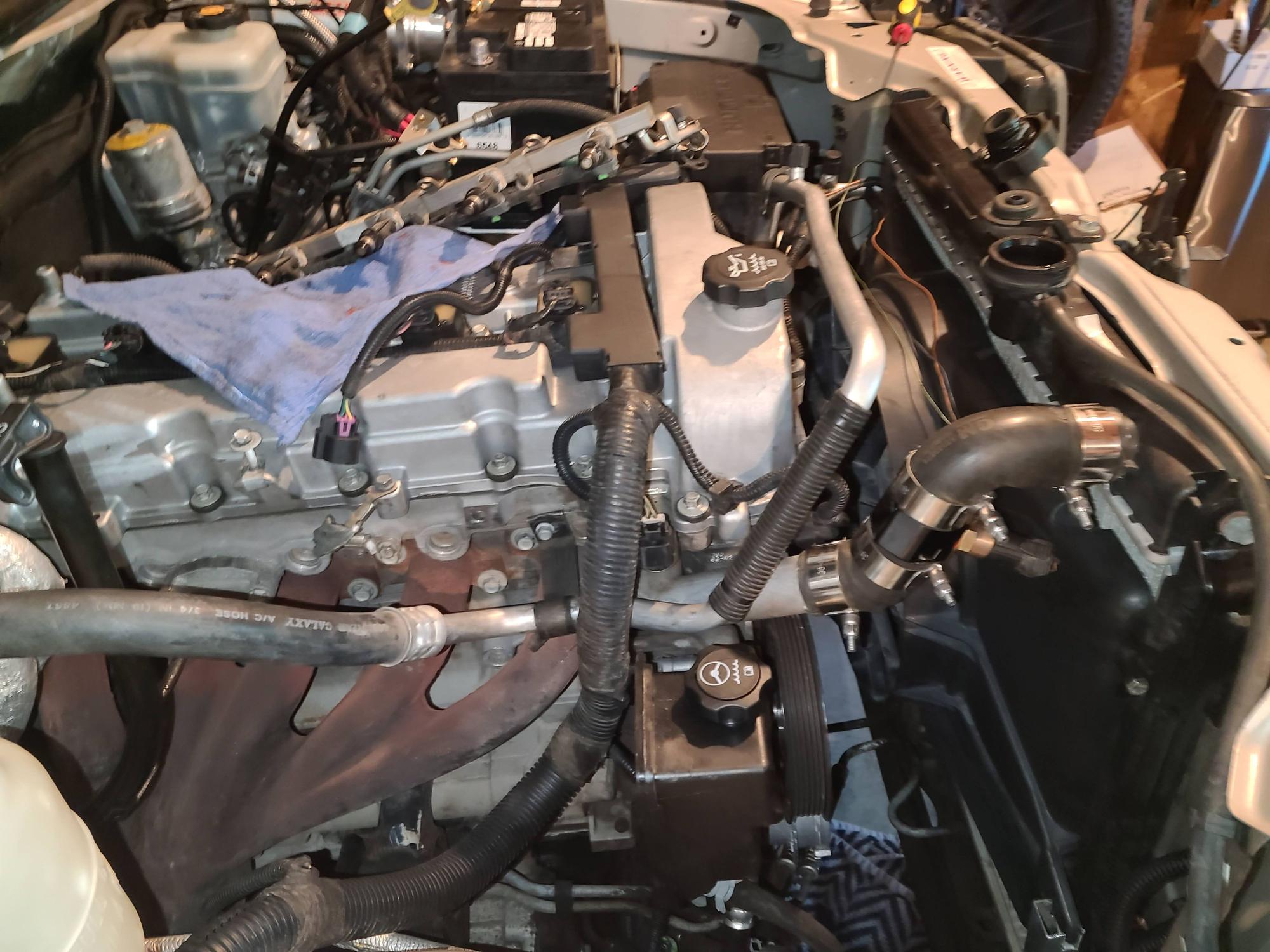

I've made a lot of progress towards virtually everything but the starting issue.

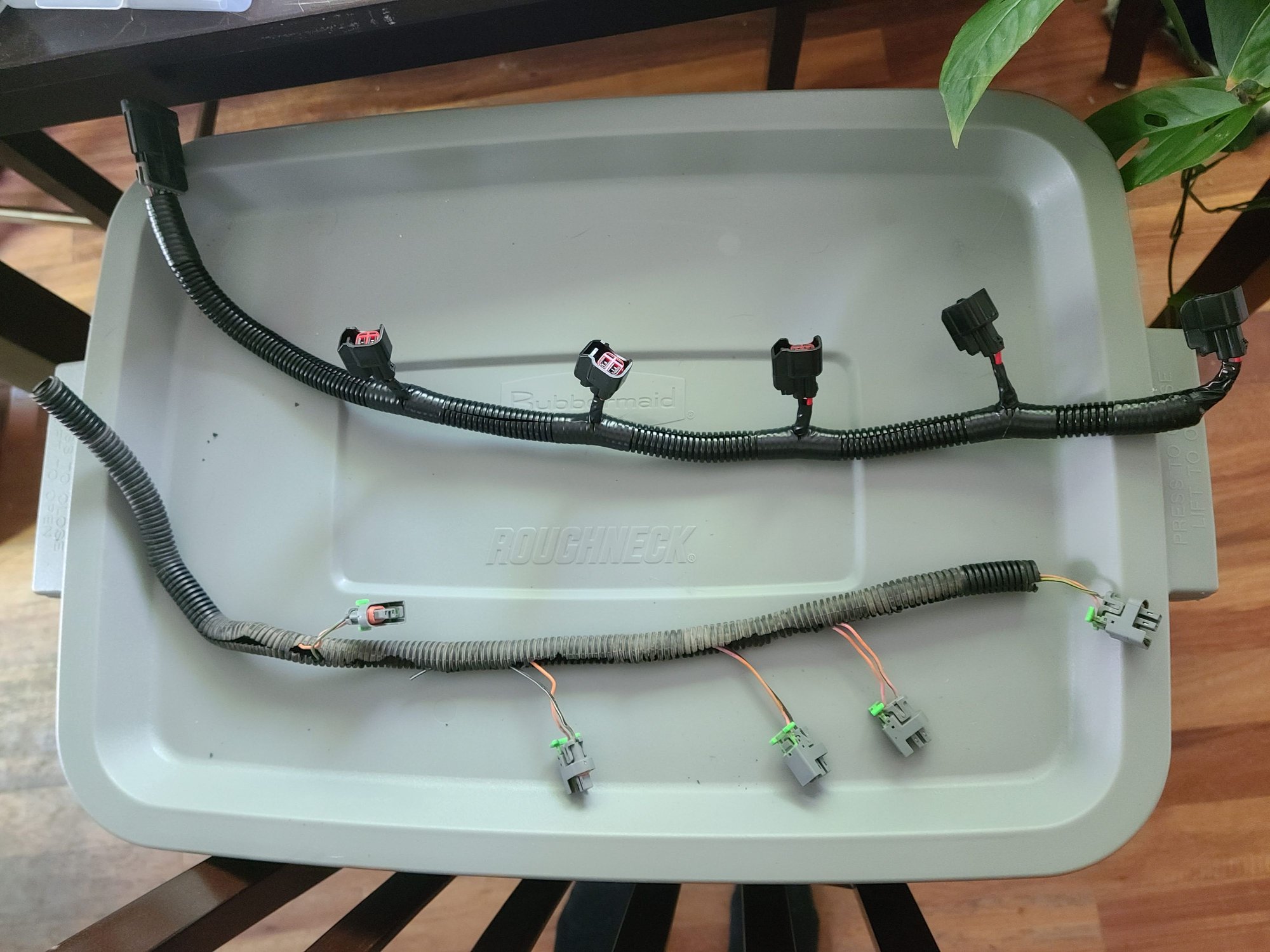

I upgraded the factory fuel injector harness from the original Multech 2 (mini-delphi) connectors to USCAR (EV6) connectors in order to swap from early LS truck (original) injectors to late LS truck injectors (2008+ H3's). The harness turned out really well and the injectors fit properly. If anyone in the future pursues this injector upgrade, beware doing so requires PCM adjustments (I am using a stock 2008 H3 file to copy/paste the newer injector tables in HPTuners).

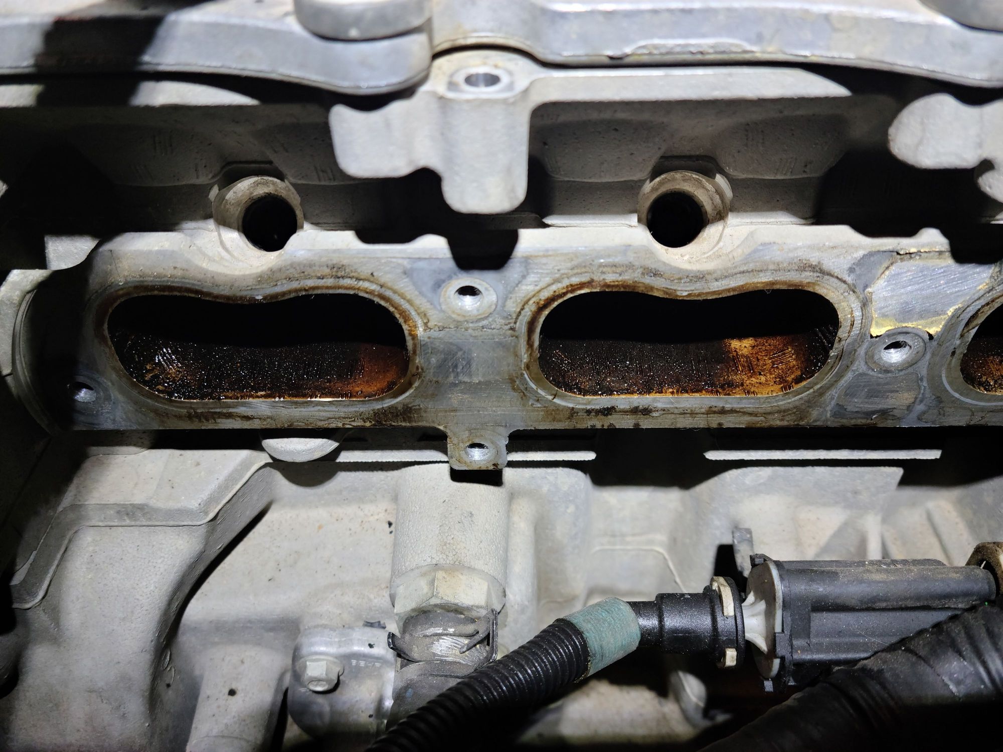

With the intake off, I cleaned the intake ports with carb cleaner and a couple of clean rags. There was a tremendous amount of carbon build up on the ports, though the valves were spotless.
I replaced the intake manifold gaskets as well as the throttle body gasket. The previous owner had removed the A/C system, and I have re-installed it along with re-wiring the A/C compressor harness due to it being sheared off. I bought a Denso A/C compressor from a 2011 Colorado with 140,000 miles. I figure $35 (used) vs $350 (new) is worth the potentially reduced life of the compressor.
While so deep in the engine bay, I re-routed many wire bundles to their appropriate areas with new clips and also installed some brackets I found on a Colorado at the junkyard (engine lift bracket & intake manifold bracket).
I have made good progress towards my e-fan swap (using a Ford Taurus e-fan, Volve relay, & BMW thermoswitch). I have the thermo-switch mounted at the upper radiator hose to trigger sooner than the bottom hose and also wired the high-speed side of the relay to switch on while the A/C compressor is engaged. This will help the A/C run cooler.

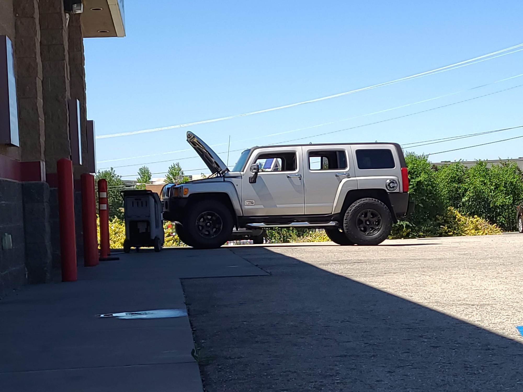

I picked up a used Denso A/C compressor from a local pick-a-part. A friend with an A/C charging system back in MN really convinced me of their value (as compared to A/C manifold gauges), so I brought my H3 into a franchise to have them charge it with their machine. After I sat in the grass for over an hour, the technician came over and told me it was fully charged but was not blowing cold. He suggested I take it to a local shop to have my A/C system diagnosed.
So, I hopped in and kept the A/C on blast on my ride home. I kept my hand on the vent and every once in a while felt a cool burst. I left it parked in the garage and went out the next morning to test the A/C again. I used a hygrometer/thermometer in the vent to check it and found it was blowing 47°F! I referenced the HVAC manual and found this was the proper "lowest" temp on the chart. When I bought this H3, the A/C hard lines and condenser had been removed, leaving open inlets on the compressor and expansion valve. I had to replace the compressor because it had froze from being left with open inlets exposed. I bet the expansion valve had also corroded (especially with my engine bay cleaning episode). I imagine the refrigerant/oil slowly worked out the corrosion in the expansion valve, allowing for proper functioning of the A/C system.
