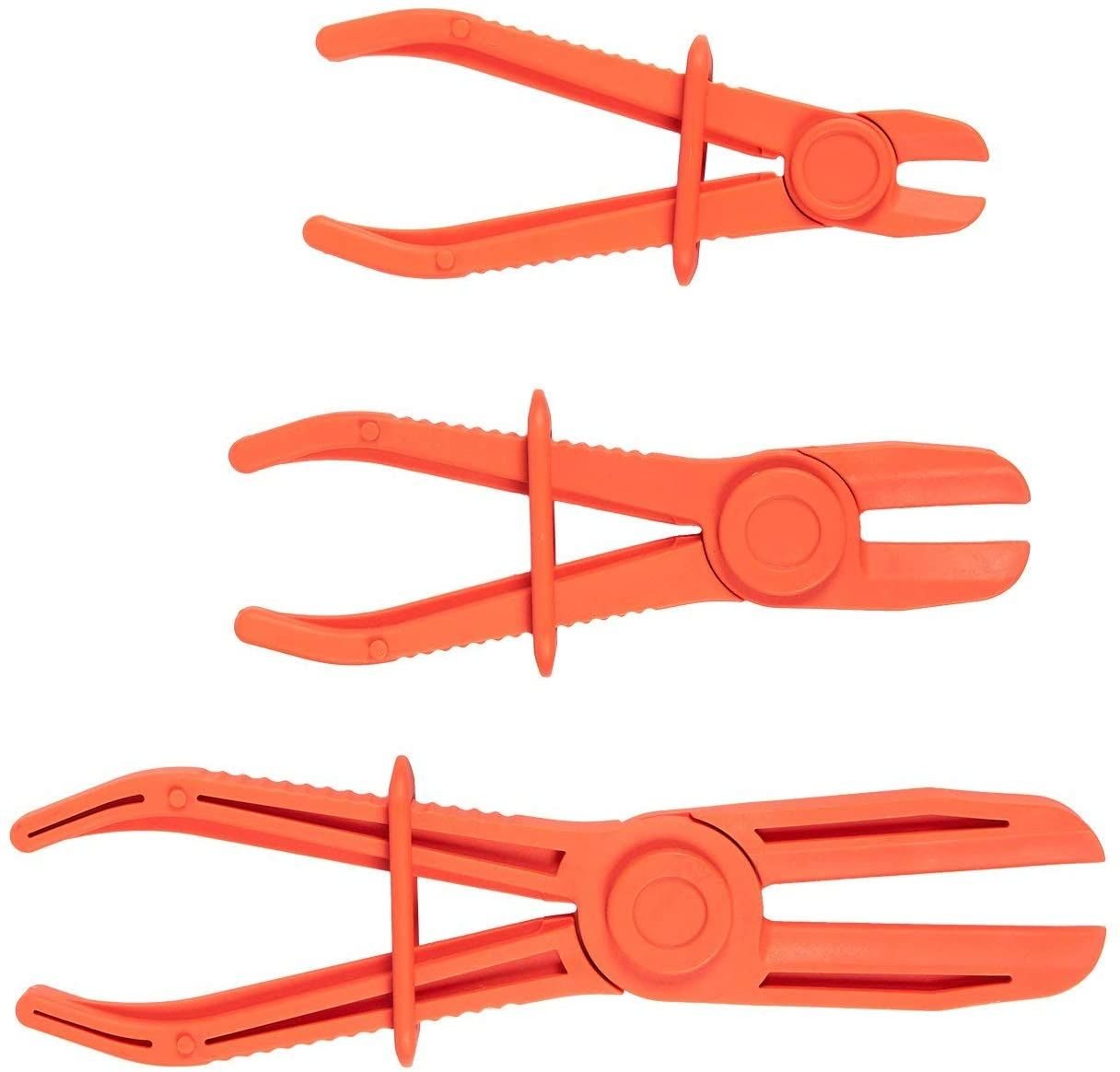

No need to buy J37287. Clamp the hose.
Line Clamp
Hose Clamp Pliers Hose Clamp Pliers
Line Clamp
Hose Clamp Pliers

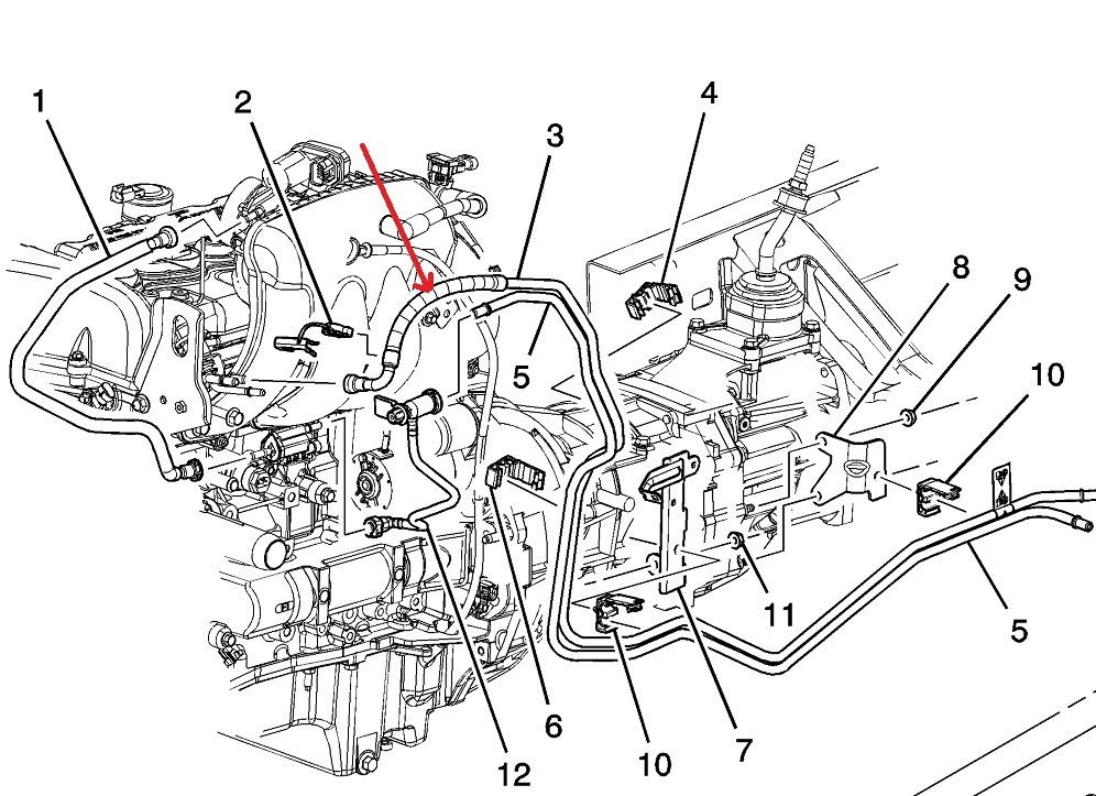

Oh yeah, I'll figure something out. What does #1 connect to on the bottom side?

You are so darn resourceful Thank you.
I ordered injectors for the 2008 H3 along with some EV6 pigtail connectors to adapt my old harness to the new injectors. 2006 injectors were $73 each, 2007 injectors were $32 each, and 2008 injectors were $18 each. There are no outer dimensional differences on the injectors (except connector type) according to the resources I read.
I will make a video on how to swap the injectors for future reference if anyone ever needs. I'm pretty excited about it. I also ordered a new intake gasket set. I figure I might as well replace it while I'm in there.
