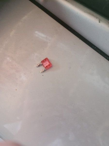

Update: it has a hard time starting. I was able to get it to start by putting it in neutral, so I replaced the neutral safety switch. Afterwords, it still had difficulty starting and wouldn't stay running for long. The stability system and ABS went wild and applied brakes so bad they were smoking as I pulled off into a parking lot. The brakes lights stay on even with the key out of the ignition, the instrument cluster is sporadic, and battery voltage was jumping around from 11.1V to 13.1V. I swapped out batteries to check if it was related to the battery (it was not the battery). I ordered some "Stinger" style battery terminals to replace the old terminals, which are really corroded (maybe originals). I also ordered a new ignition cylinder housing and lock cylinder.
Once I replace the terminals, refresh the grounds and other connections, and replace the lock housing and cylinder, I'm hoping the problem will be resolved. If not, does anyone have additional ideas?

check the brake switch on the brake pedal it might need to be reset or replaced, it controls both abs and brake lights

While waiting for parts in the mail, I figured I would change the oil, replace an axle seal, and replace diff fluids in front and rear. While doing so, I decided to triple check the fuses.
Up until today, anytime I have checked fuses, I just looked at the filament (or whatever it is called) inside the fuse. I hadn't thought to look at the blades of the fuse, however. Upon removing the BCM fuse, I noticed some suspicious scorch/arch marks on the blades... I sanded the blades clean, replaced the fuse, and guess what...? The vehicle started and ran with no warnings and everything worked as it had prior to this problem. Total cost: $0.05?
Here's what it looked like:
Corrosion on the blades led to arching and wild electrical problems!
