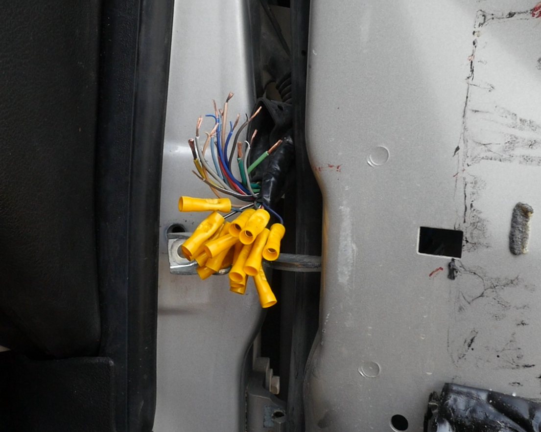

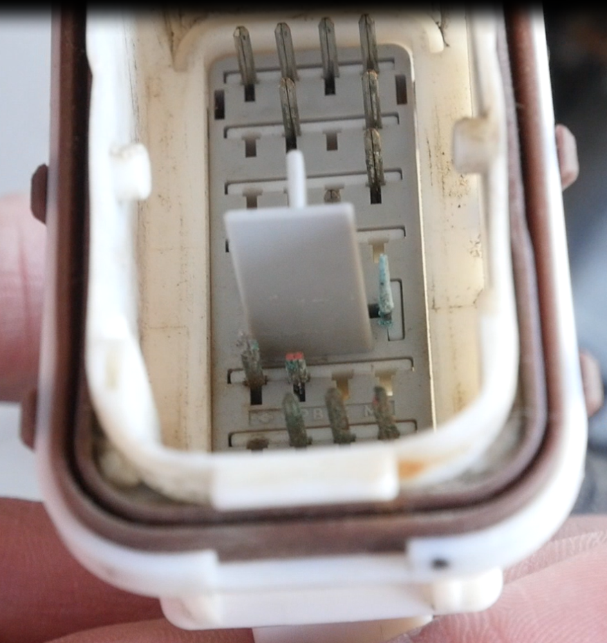

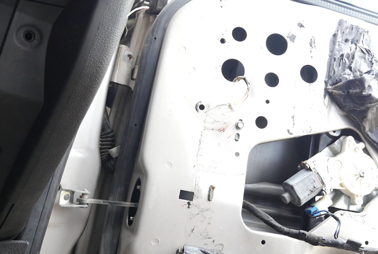

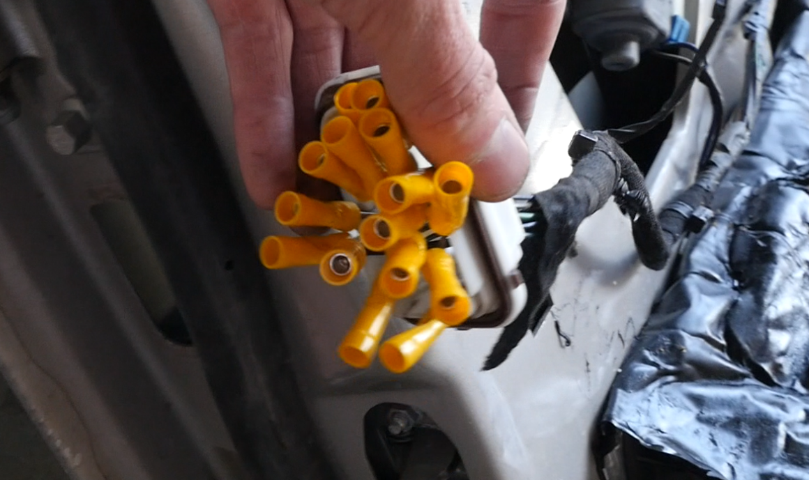

Also, I settled all the wiring issues I was having (no power mirrors and malfunctioning passenger door switch). I got the driver's side power mirror to work using the orange-to-orange wiring jump (from the window switch to the power mirror switch). My passenger mirror still did not function, so I disconnected the passenger power mirror and wired it to an old 12V battery I had to ensure the power mirror motor worked (it did work). With the issue now being the connection from the mirror switch to the mirror, I started tracing wires. I found the door jamb connector was badly corroded with one prong broke off completely. There was the issue.... I did a dirty and hardwired everything with either butt splices or solder and the passenger door functions (including mirror) work properly now! I am super satisfied being able to use the functions as they are designed.
Here are some photos:
Broken prong and several heavily corroded and weak prongs (likely cause of the passenger mirror and door switch issues).
Using butt splices and re-using old housing to maintain weather tightness.
Getting ready to connect splices and feed them through the sealed housing.
Fully wired door jamb utilizing old housing (looks completely original from the outside).

12-10 AWG Butt Splices on 22-18 AWG wire, without waterproof shrink wrap?
Btw, I would just replace the broken pin.
Thanks for the product suggestion. I understand you would have just replaced the broken pin. For me, seeing all of the pins and sockets as severely corroded with at least four not working properly, I decided to go a different route. I used what I had available and think my solution was effective.
