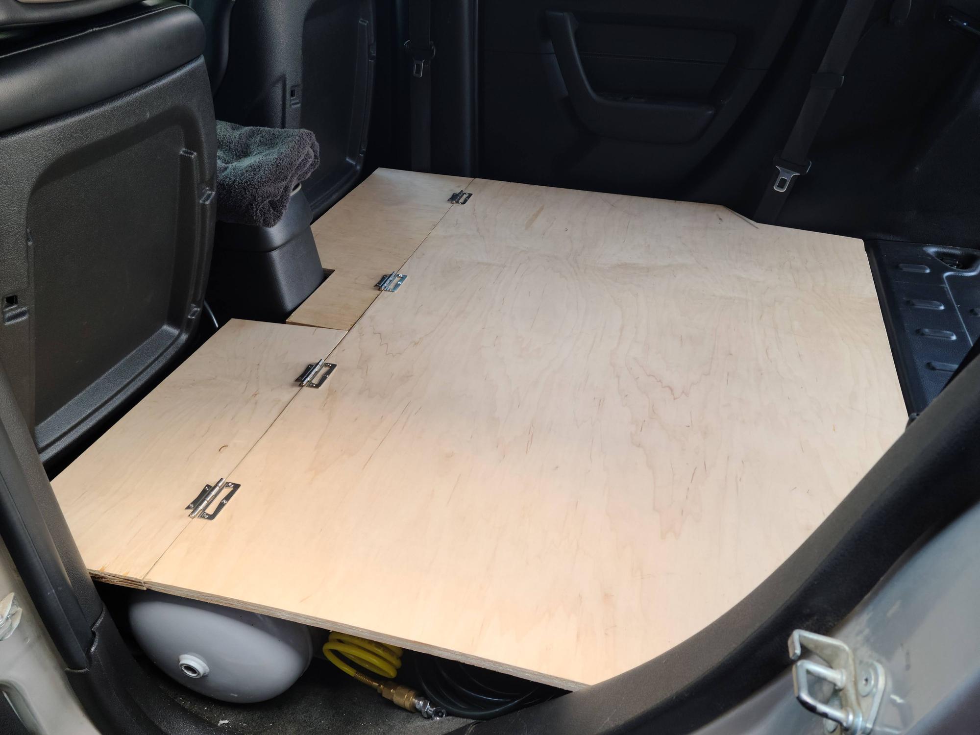

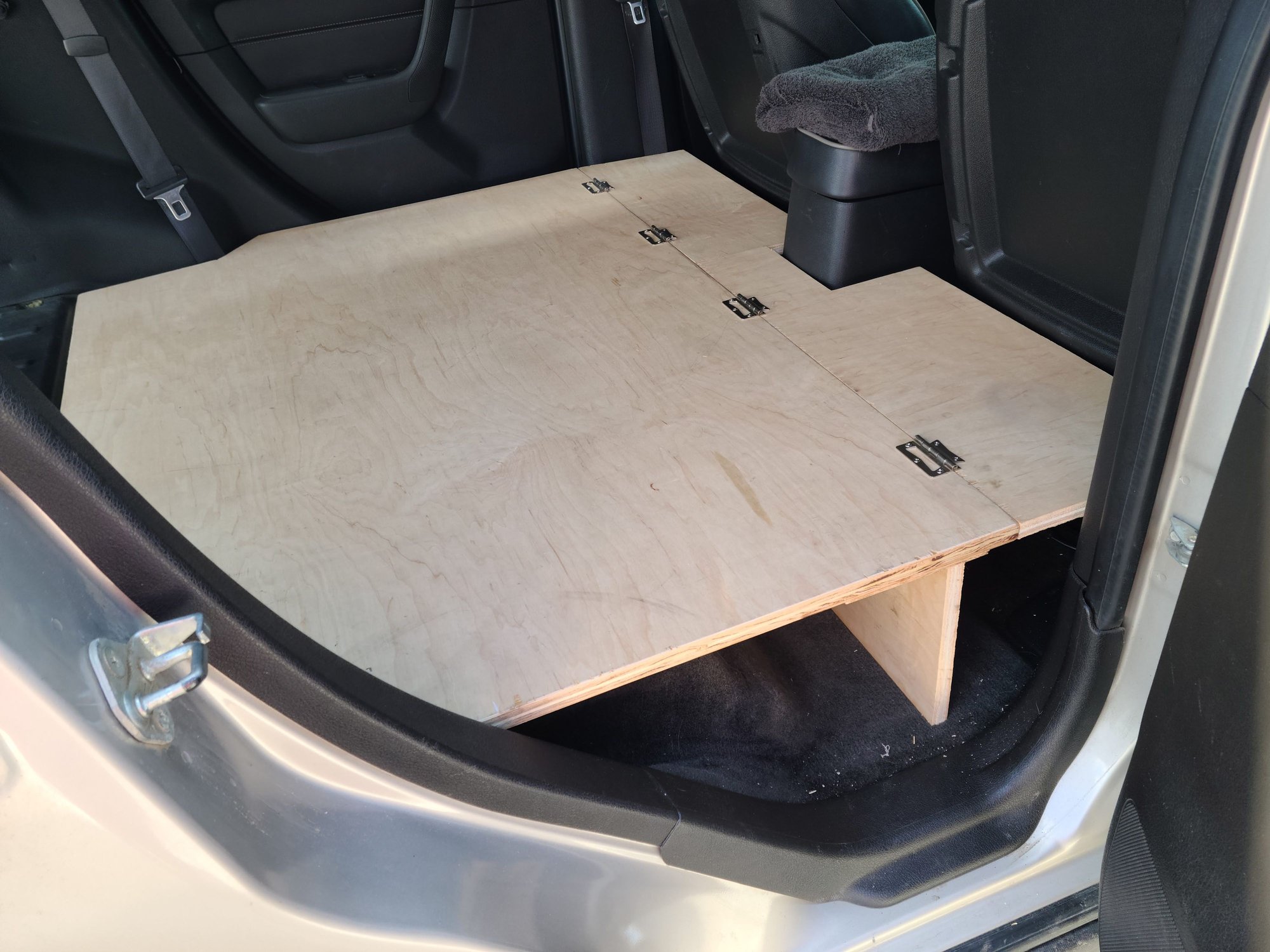

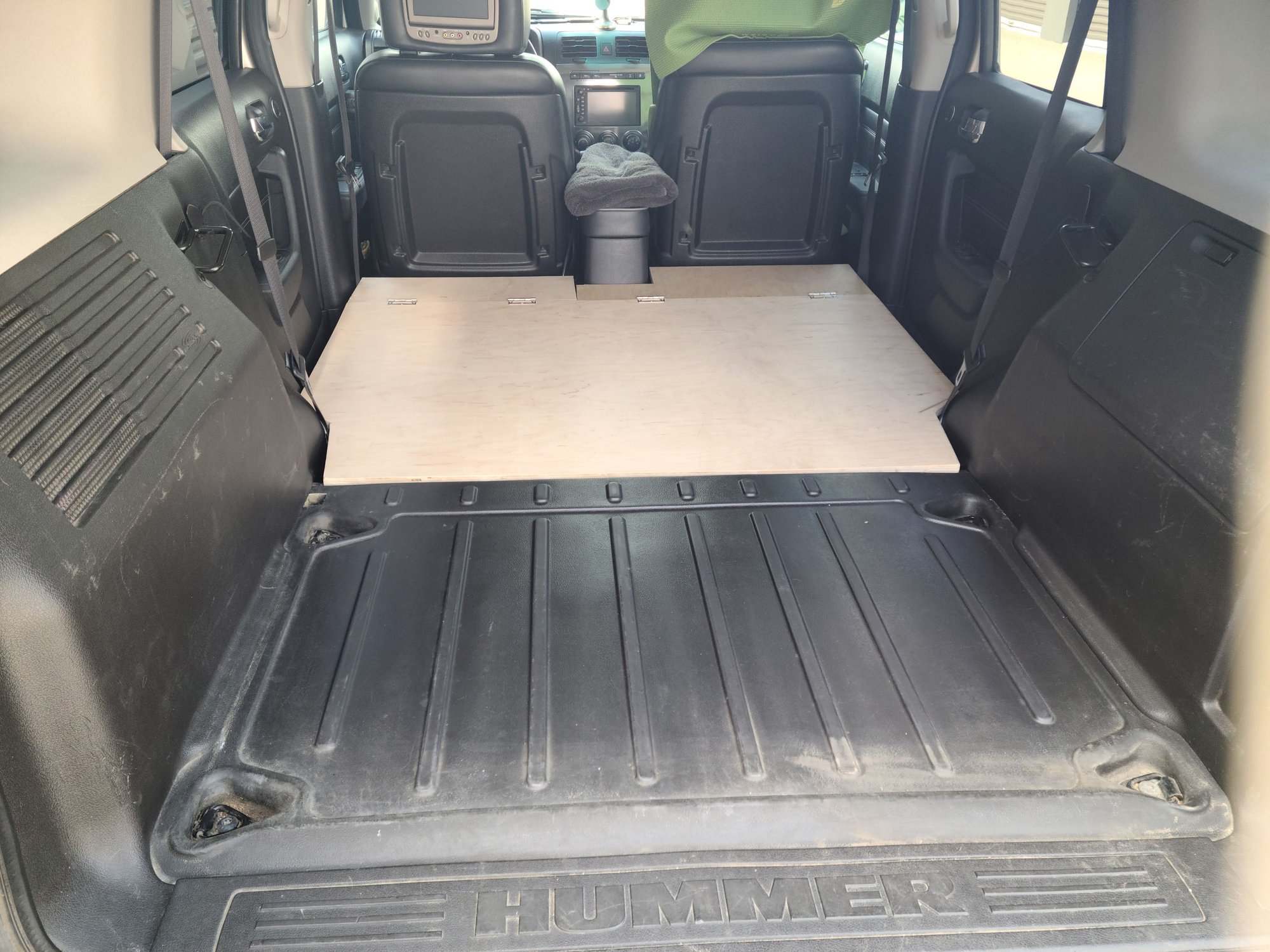

(For Raul: some photos of my sleeping platform with the air tank installed behind the driver's seat)
Air tank located behind driver's seat and serving as a support for the sleeping platform.
Sleeping platform from the rear hatch.
Sleeping platform from passenger's side being supported by plywood "foot".
