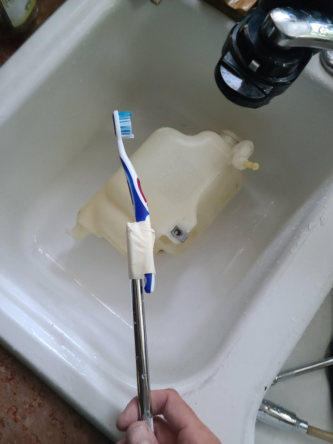

Default Flushing coolant & cleaned the reservoir
No more grape juice or ketchup stains in the coolant reservoir.
I made a major mistake/discovery before constructing this apparatus: clumping cat litter is like concrete (I had the idea of sloshing pebbles around the inside to scrape the inside clean and then though, "I bet cat litter would do the trick." It did not do the trick. It turned to concrete on the inside and I spent an hour blasting it out of there.) Do not use clumping cat litter on the inside of anything!
Precision instrument for cleaning the innards.

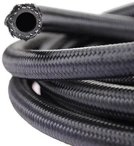

That hose should not be rigid? I can pinch my hose with my thumb & index, not enough to make it stall but it does collapse. You only need a 1 minute squeeze on it to verify leak down.
Nylon braided fuel hose:
The fuel line must have still had pressure in it when I pinched it by hand, which is what led me to believing it felt rigid... I went out again to feel it with my hands (has been sitting for 24+ hours) and it was soft. I will check for the leak down and update you. Thank you for your persistence
