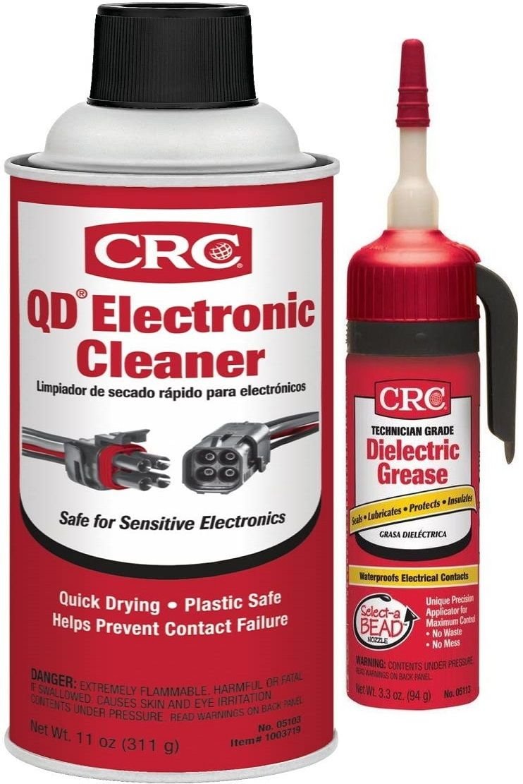

While waiting for parts in the mail, I figured I would change the oil, replace an axle seal, and replace diff fluids in front and rear. While doing so, I decided to triple check the fuses.
Up until today, anytime I have checked fuses, I just looked at the filament (or whatever it is called) inside the fuse. I hadn't thought to look at the blades of the fuse, however. Upon removing the BCM fuse, I noticed some suspicious scorch/arch marks on the blades... I sanded the blades clean, replaced the fuse, and guess what...? The vehicle started and ran with no warnings and everything worked as it had prior to this problem. Total cost: $0.05?
Here's what it looked like:
Corrosion on the blades led to arching and wild electrical problems!

Why all the drama?
I suppose I'll have to give in to your pressure for CRC. I haven't had problems with corrosion on electrical terminals like this in any vehicle I have owned previously (and they've all been from the rust belt except this one). Also the first vehicle I've owned with power mirrors, locks, and windows haha. I'm sure you were hoping this was all due to my questionable door-jamb job.
