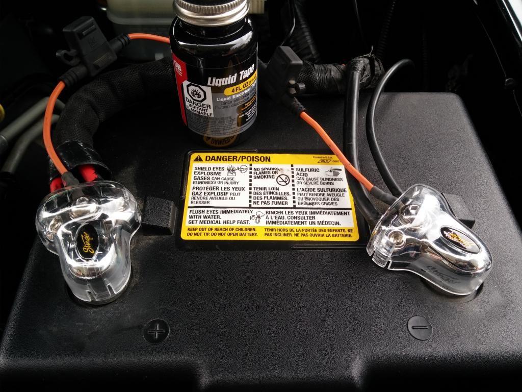

Nice work. Although the carbon buildup in your intake needs attention
Also, replace the oe terminals asap!
Old Apr 26, 2021 | 09:34 PM
  #46
Dylan Rogers's Avatar
Joined: Apr 2021
Posts: 220
From: Idaho
Thanks I already put a bottle of SeaFoam in this tank and also put some in the oil about 100 miles prior to changing it. I have the stinger-style (off brand, though) terminals sitting on my shelf right now. I'm surprised they haven't been replaced since this thing has 320k on it lol. I will install my new terminals once I get some of the other projects done and it is drivable again.
I have seen the paint on electrical tape in stores but have never used it. Have you had good experiences with it? Thank you for the helpful suggestion.

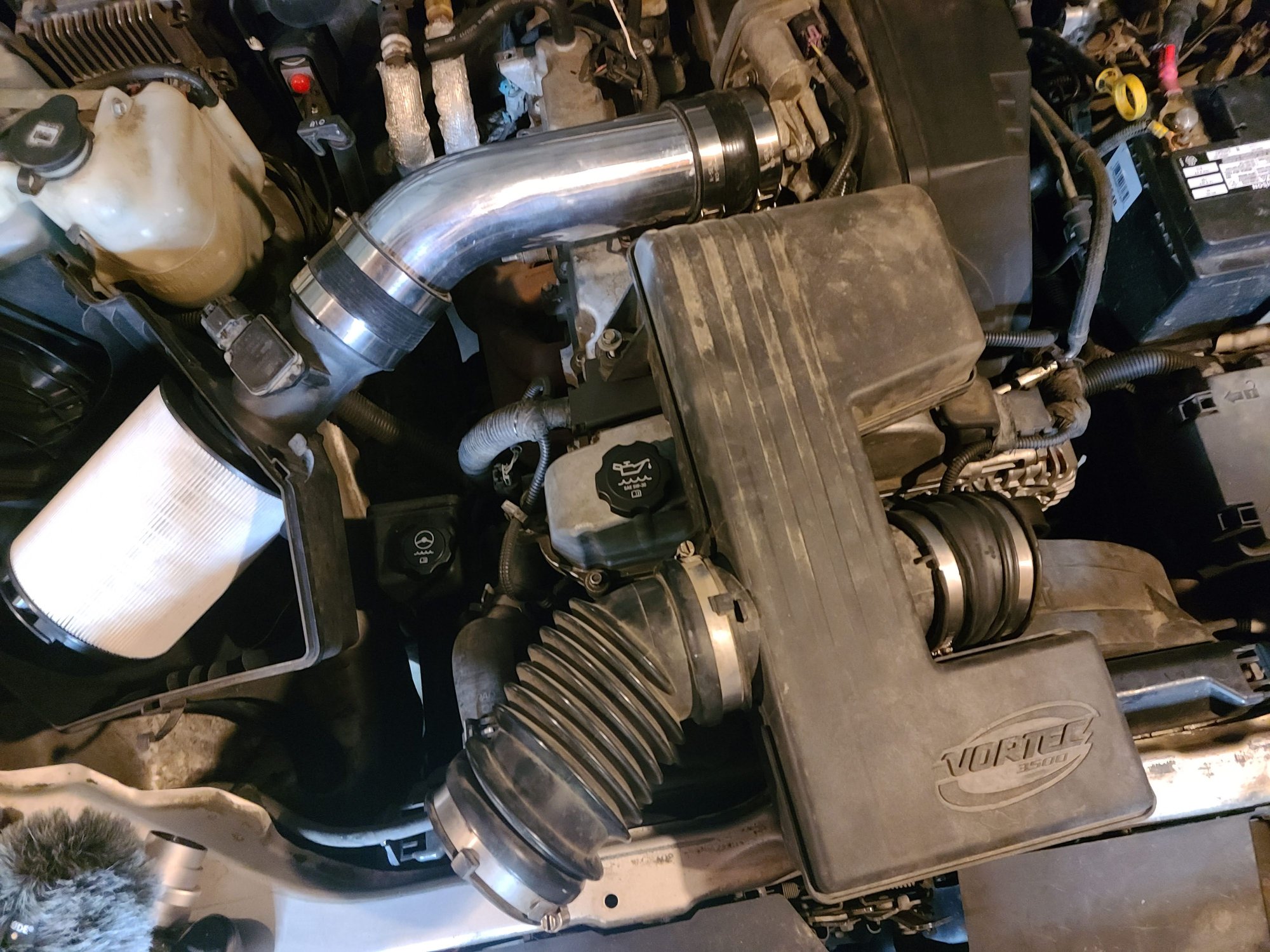

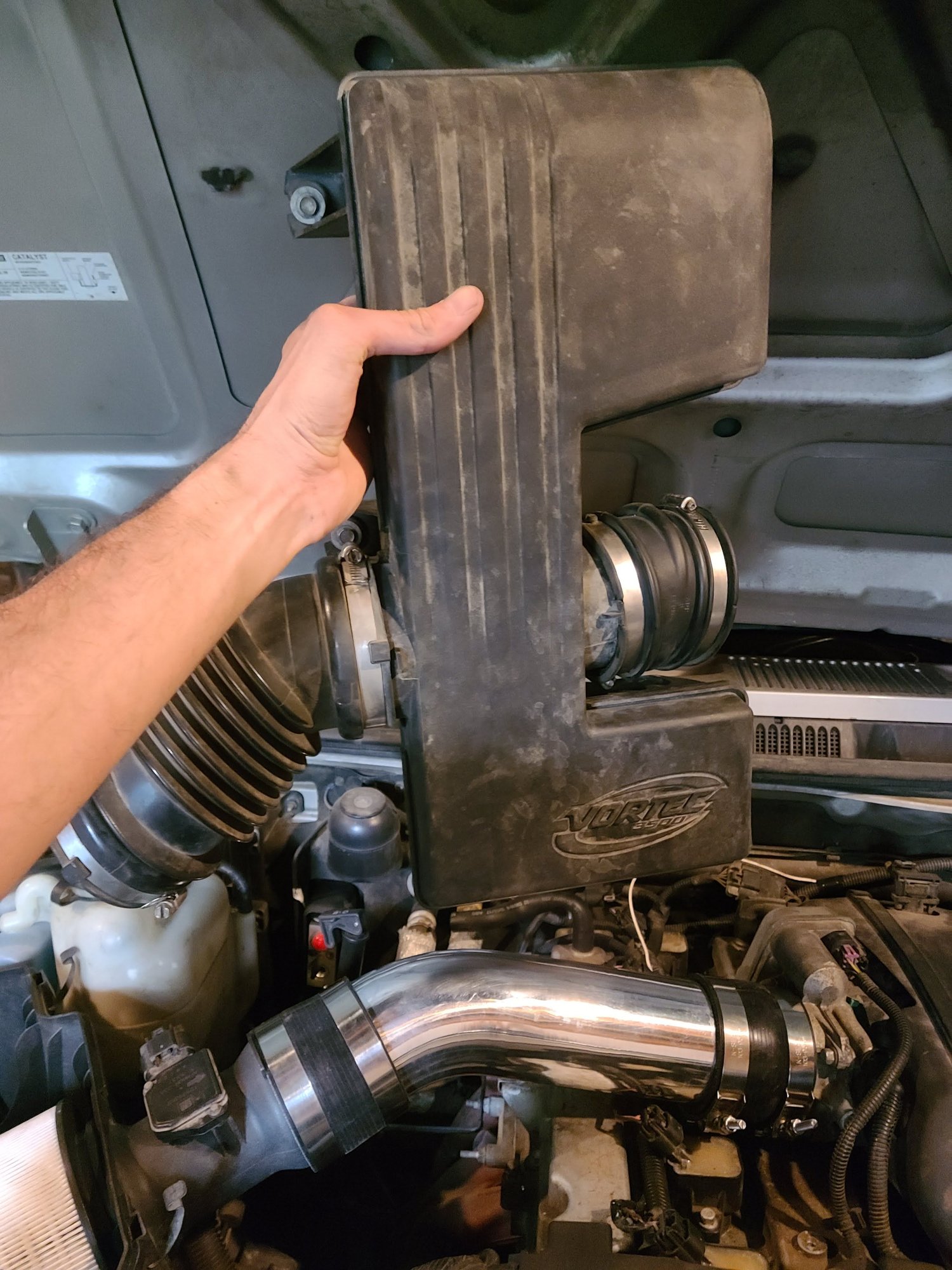

Default DIY Cold Air Intake Style Tubing for ~$80
I got my parts in the mail for my cold air intake style tubing. When I cleaned the throttle body, I realized how obnoxious the big box was just before it. I figure this style tubing will allow for easier maintenance and visibility of the engine compartment as well as smoother flowing air. I expect a small drop in MPG since the big black box heats up from the engine and offers a lot of surface area to heat up the air as it enters the engine (hot air = less oxygen = less power = higher MPG). We'll see! I really like the look. I considered a DIY cast tube but decided against it. Maybe one day in the future when I have a lot of time to spend learning a new skill.
I haven't purchased a new air filter for it yet and am planning on going with aFe.
old vs. new
old vs. new
