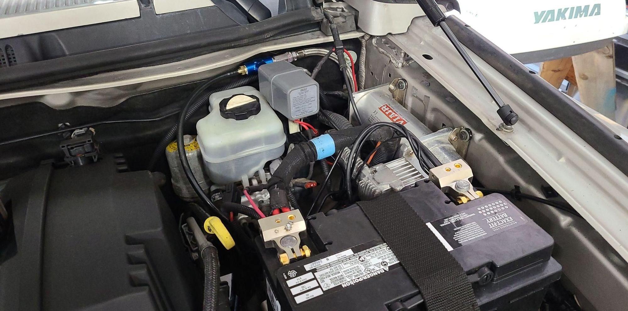

I finished installing my Viair on-board air and pressure relay. I still have to sort out air lines but everything fits well! I have the inlet filter mounted under the dash and the air line running to my tank under my center console.

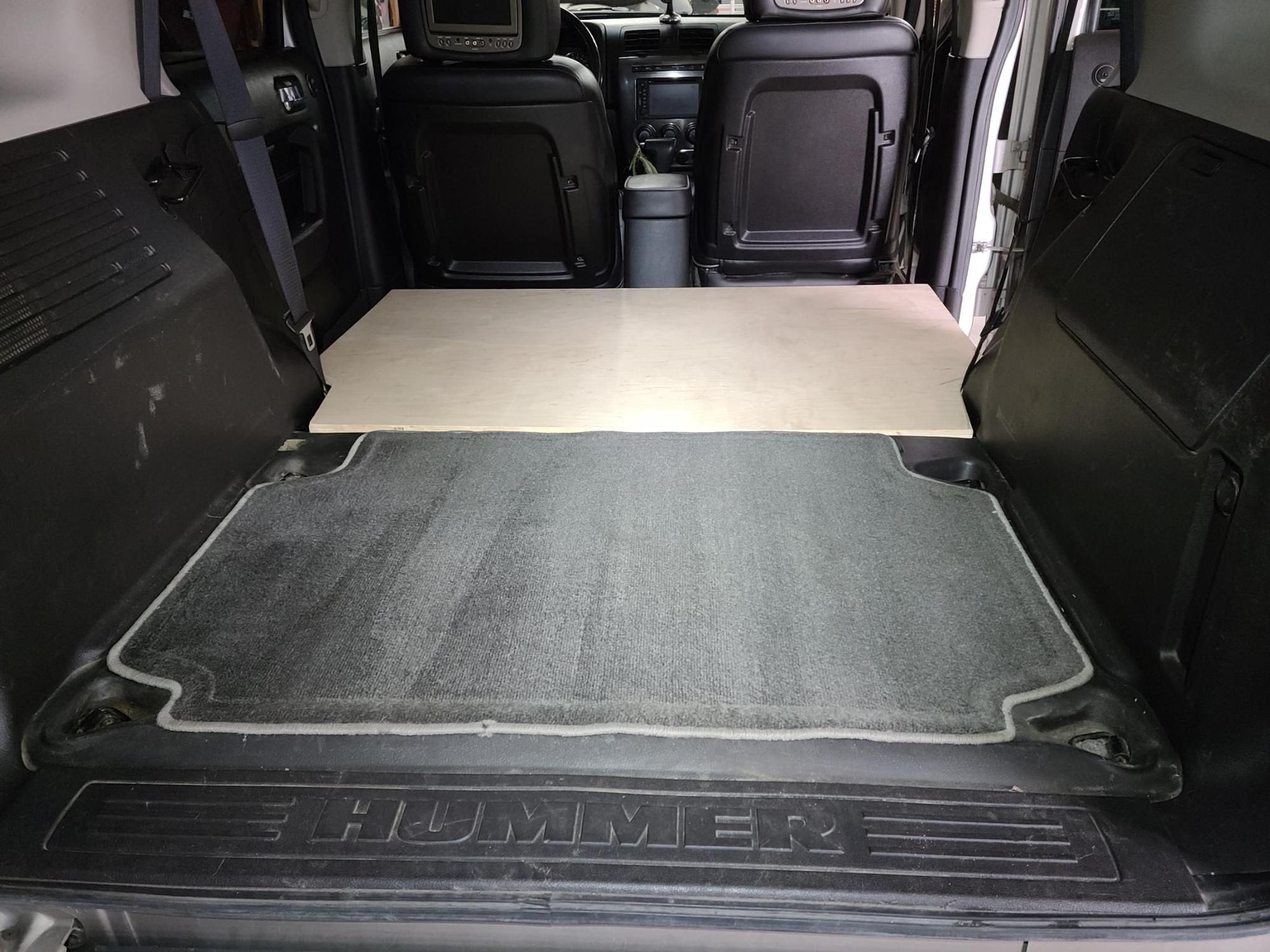

Default Overlanding Bed Setup
Here's my sleeping platform. It isn't quite finished yet, but all the pieces are cut. I will be adding hinged head supports. The hinged sections in "closed" position allow the seats to move backwards completely. In the "open" position, the supports add an extra foot to the length of the sleeping space. There are two hinged supports.

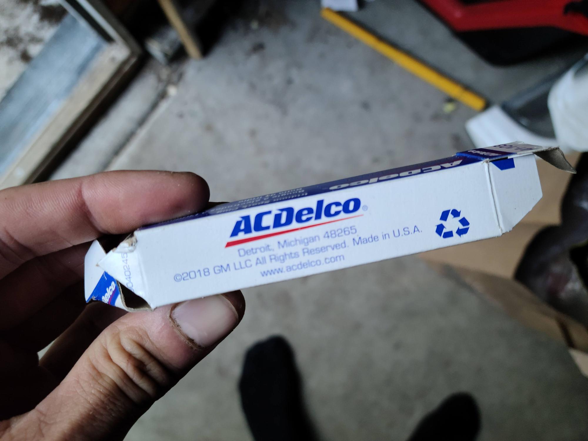

Nice work, except it appears you forgot the CRC Electronic Contact Cleaner on the coils terminals(boot end) & connector/contacts?
Btw, where were those plugs made?
Thanks I cleaned them off with contact cleaner and also sanded them down with a bit of sand paper at the end of a screw driver. I conveniently did not document the spray portion haha.
The ACDelco plugs are made in the U.S., and possibly in Detroit based on the packaging.

FYI, ACDelco parts are not made in Detroit. ACDelco is a distributor in Detroit. If you look at the box, always marked where the parts were "MADE IN____ ! Can you fill in the blank?

Default Hummer H3 Onboard Air
I've got my air compressor all set up and it functions well. I think I might re-orient it to an upwards position.
