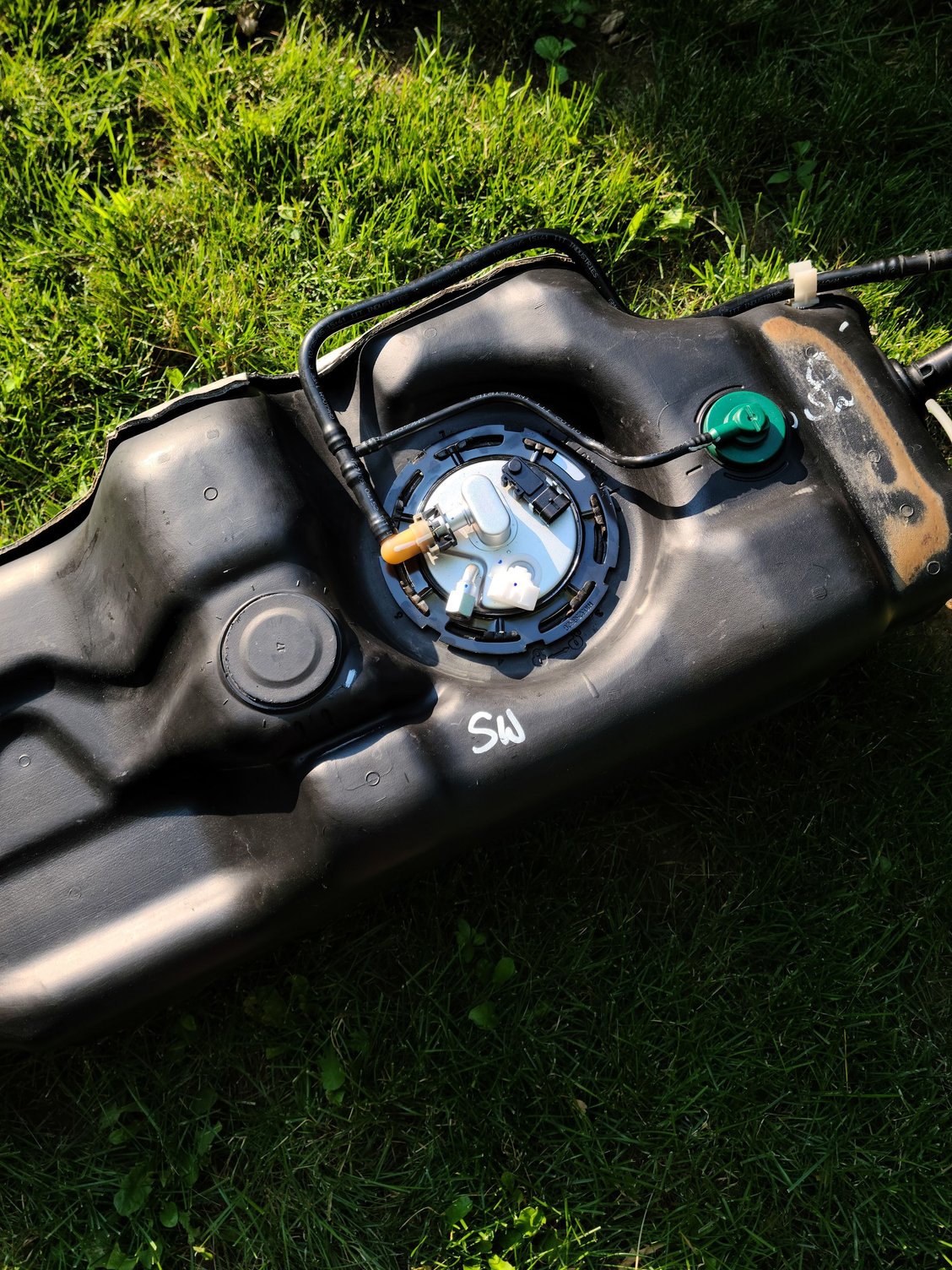

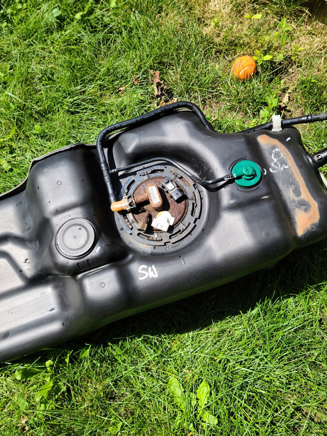

Default Success.
Before (old fuel pump)
After (new fuel pump)

I got it all put back together and the sporadic crank no-start persists. The symptoms did not change at all.
What's the next direction? My thoughts include possibly wiring issue or a failing crank position sensor or PCM. My fuel trims still read lean, too (ranging from -3% to 20% across the map).

well it was not in vain. your old fuel pump had pretty heavy rust scales. just takes one of those scales to pop off in an in opportune time.
I appreciate your moral support It was quite rusty, indeed.
