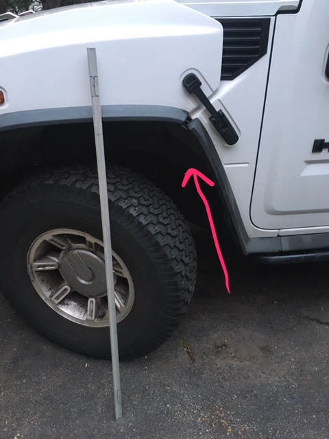

I just did the dumbest thing: Removed cable from catch thinking I would remove catch to clean it so it would properly retain the hood. Decided not to do the job. Shut the hood and wouldnt you know the latch that hasnt been latching latched! Only now, I had removed the cable from it, so there was NO way I was getting it to release. Well, I found a way. Crank the wheels all the way to the right so you can get your head and self in behind the driver side tire/wheel. With a flash light you can look up and see the latch mechanism (its spring is most noticeable). You can also see the little arm that you need to push back to release the catch. A long piece of aluminum angle iron, like the one in the photo lets you reach it and push it towards the rear, and it worked. Hope this helps some other desperate individual. I thought I was going to cry!! (actually my 20 yr old son crept in there and saw this first!)
