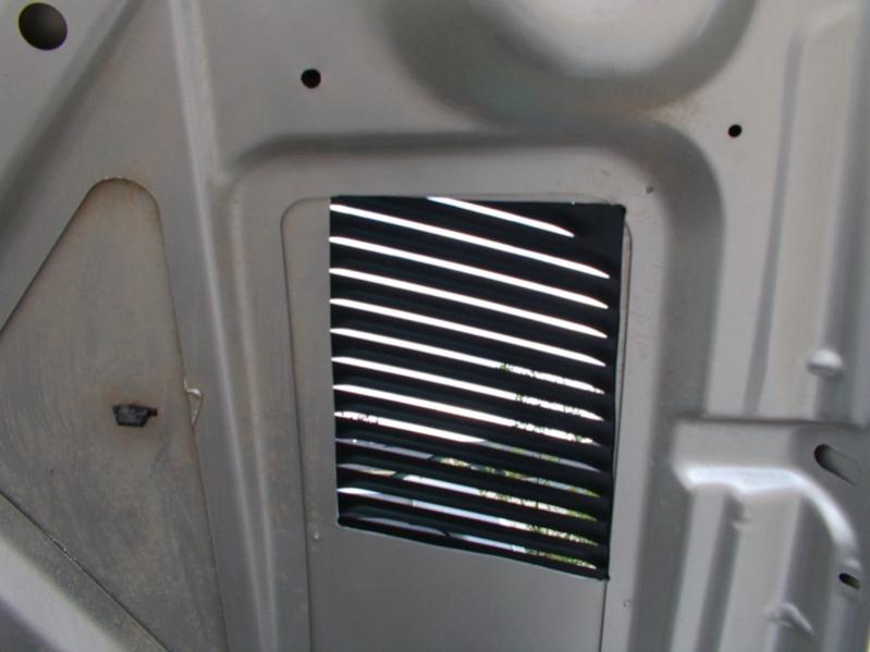

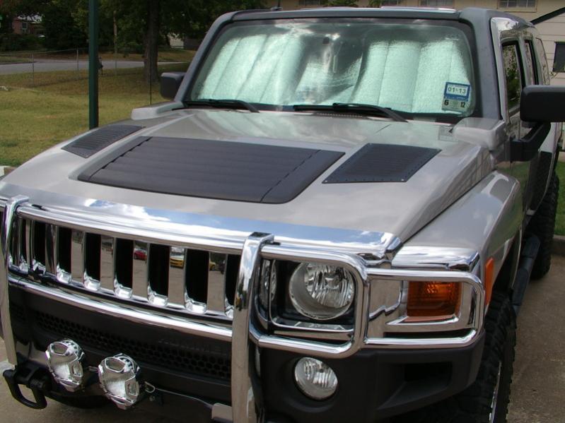

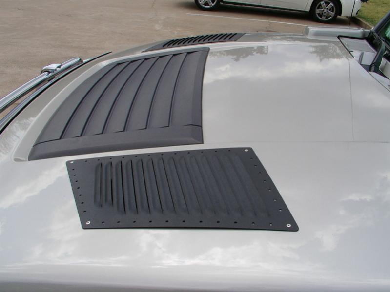

Found some Pics of Functioning Hood Louvers ....
Attached Thumbnails Real Hood Louvers Expelling Engine Heat ?-imgp2336.jpg   Real Hood Louvers Expelling Engine Heat ?-imgp2337.jpg   Real Hood Louvers Expelling Engine Heat ?-imgp2339.jpg

My question is there anything under the Louver area of the engine that could be damaged by Rain? I suppose hood rust might be another concern?
Thanks
Old Feb 22, 2015 | 09:59 PM
rsc's Avatar
rsc
Joined: Jun 2010
Posts: 1,042
No, the mod is not a magic pill for solving overheating issues. It does work, but not as much as I had wanted it to. If you like the looks or like to tinker and make stuff then its worth it. But if asking MY opinion, YOU will not be happy with the price/effort/results tradeoffs. Me? I would do it to my own again because its uniquely mine.
Old Feb 22, 2015 | 10:02 PM
rsc's Avatar
rsc
Joined: Jun 2010
Posts: 1,042
Yes, there is crap under that area of the hood to be modified like the plug coils. The rust isn't a problem because you are going to primer and paint the raw edges.

Yes it does let alot of heat escape, how much I am not sure, but on these vehicles anything is better than nothing. I noticed a big improvement in heat soaking after shut off.
When I park and shut off the engine, I can feel the heat rising out through the vents instead of just sitting under the hood heat soaking everything.
I cant say there is any benefit, but I can not see how less heat soak is a bad thing for the motor and electrical components.

I did the center of the hood. I removed the fake plastic, cut the triangle and 2 rectangle pieces out out between the hood bracing. I then cut and bent a piece of diamond plate aluminum the same shape as the entire recessed depression on the hood and spaced it up 3/4 inch so it sits a tad higher than the rest of the hood so air flows under it.
I did it myself, only took a few hours of messing around with the shape using a cardboard template. I also put a 1/4 inch bead of silicon around each hole so water does not run in in the rain. I have not seen any water get in yet so Im not worried about that at all.
There is pics somewhere on here from a couple of months ago.
