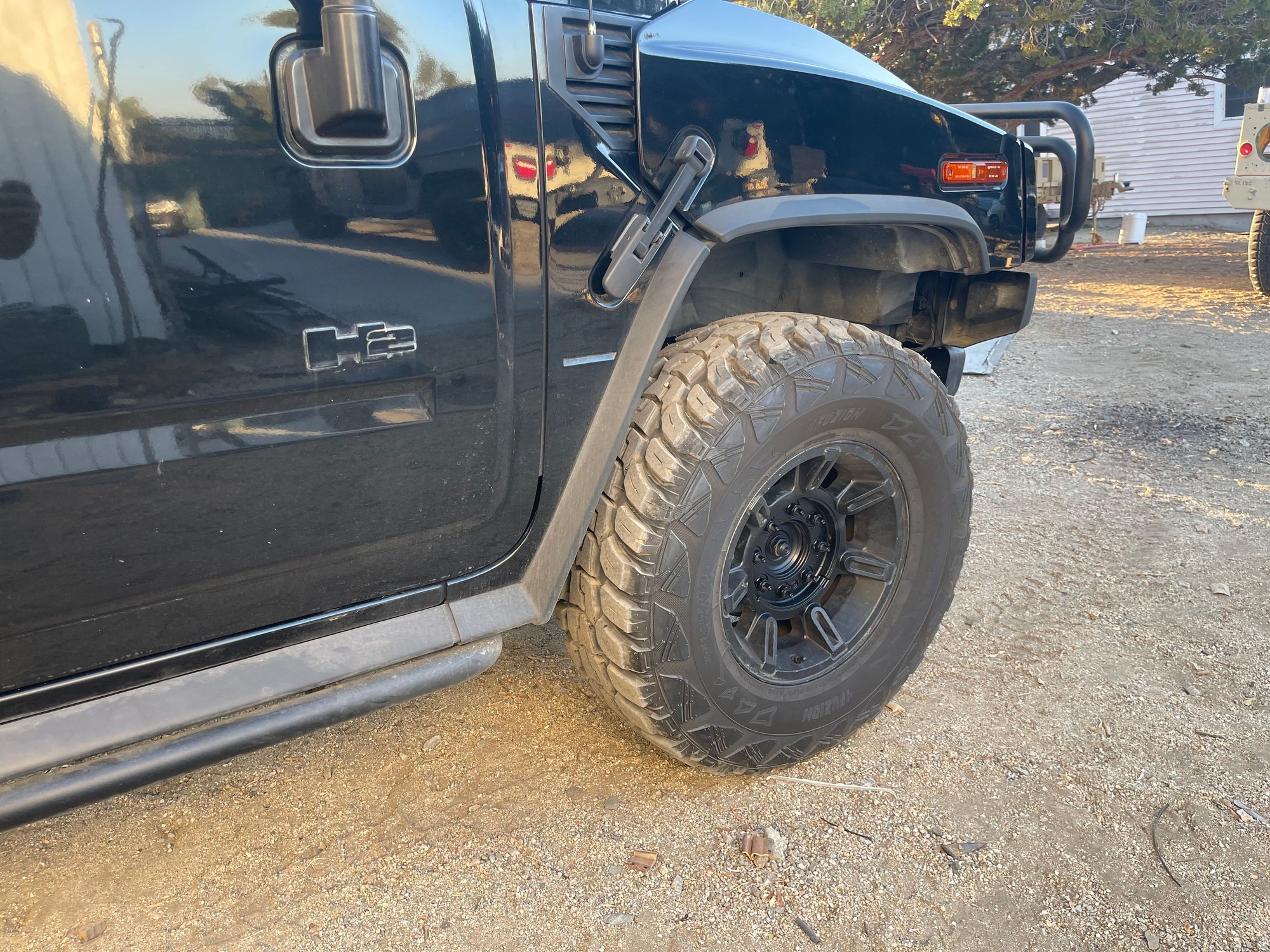

The camber issue you see on the tires is because I bought the rims with those worn out tires. My truck does not have camber issues.
tomorrow morning, Im getting the brand new tires and also getting alignment done
Negative camber is good
Positive camber is bad

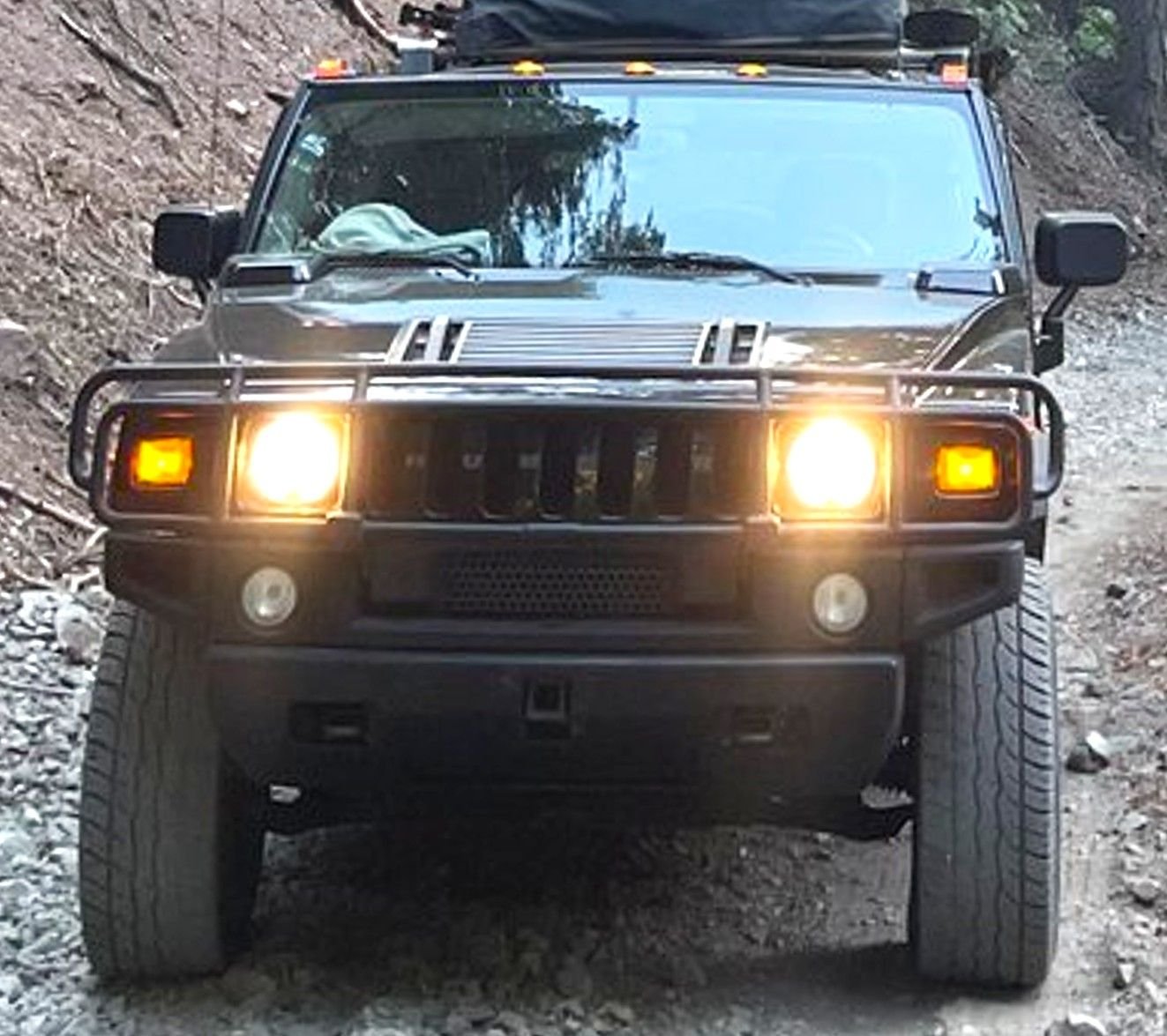

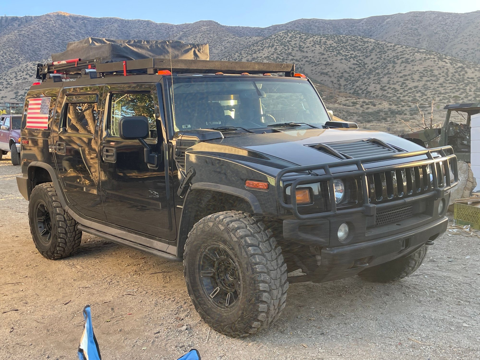

Lol, in true hummer style, start with a very heavy vehicle designed to go off road and then add even more weight until it requires a new suspension system lol
All these roof rack systems look like childrens bedframes...
I don't hate it, lol
