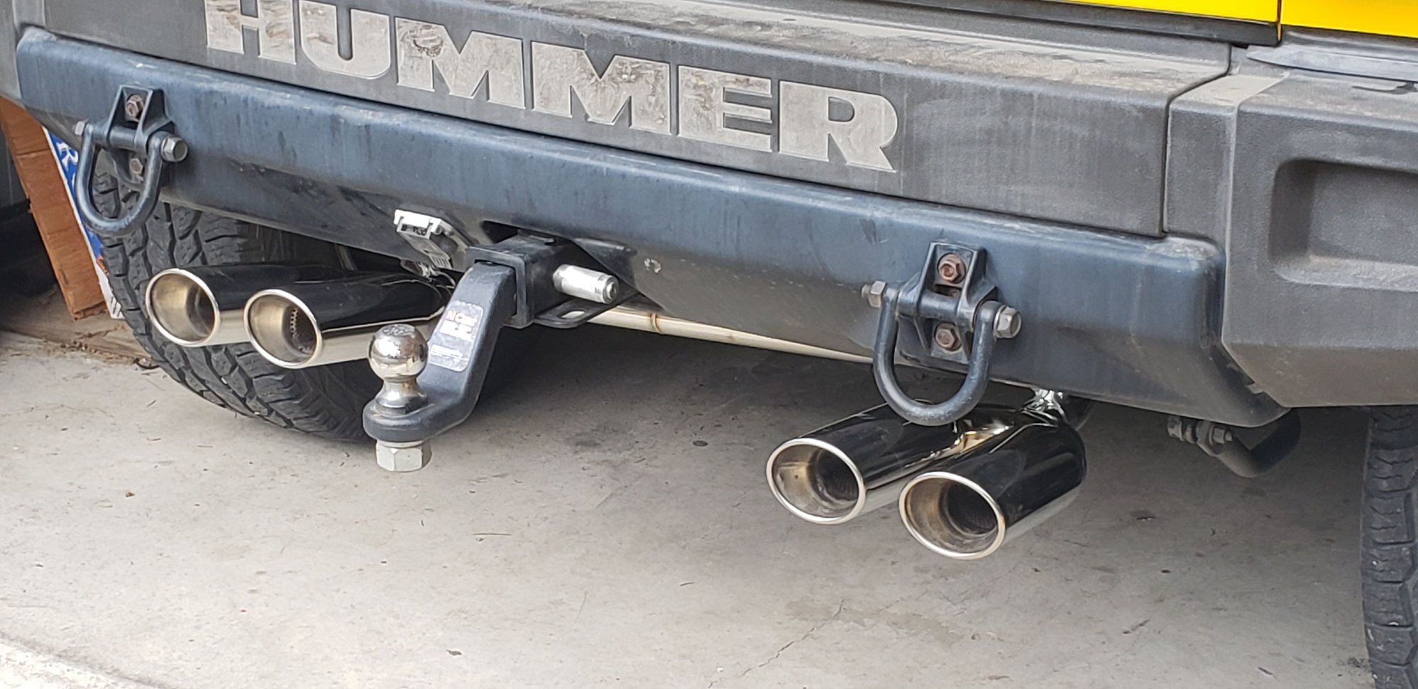

2003 model, 116,000 miles now.
Off-road, I don't think you'd want these tailpipes though....

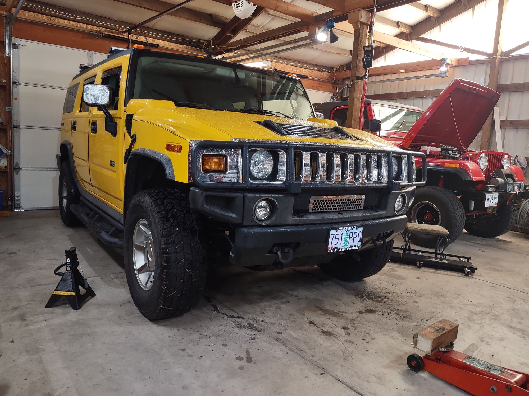

Here it is, I fixed the shifter cable bushing issue,
military cotter pin style,
I cut a bolt exact diameter of the shifter cable bushing
I drilled small hole for the cotter pin
then I ground off the end piece of the lever end where it was supposed to clip on to the bushing,
I welded the bolt to the lever,
then I cut the bolt to size needed
and here is the result.

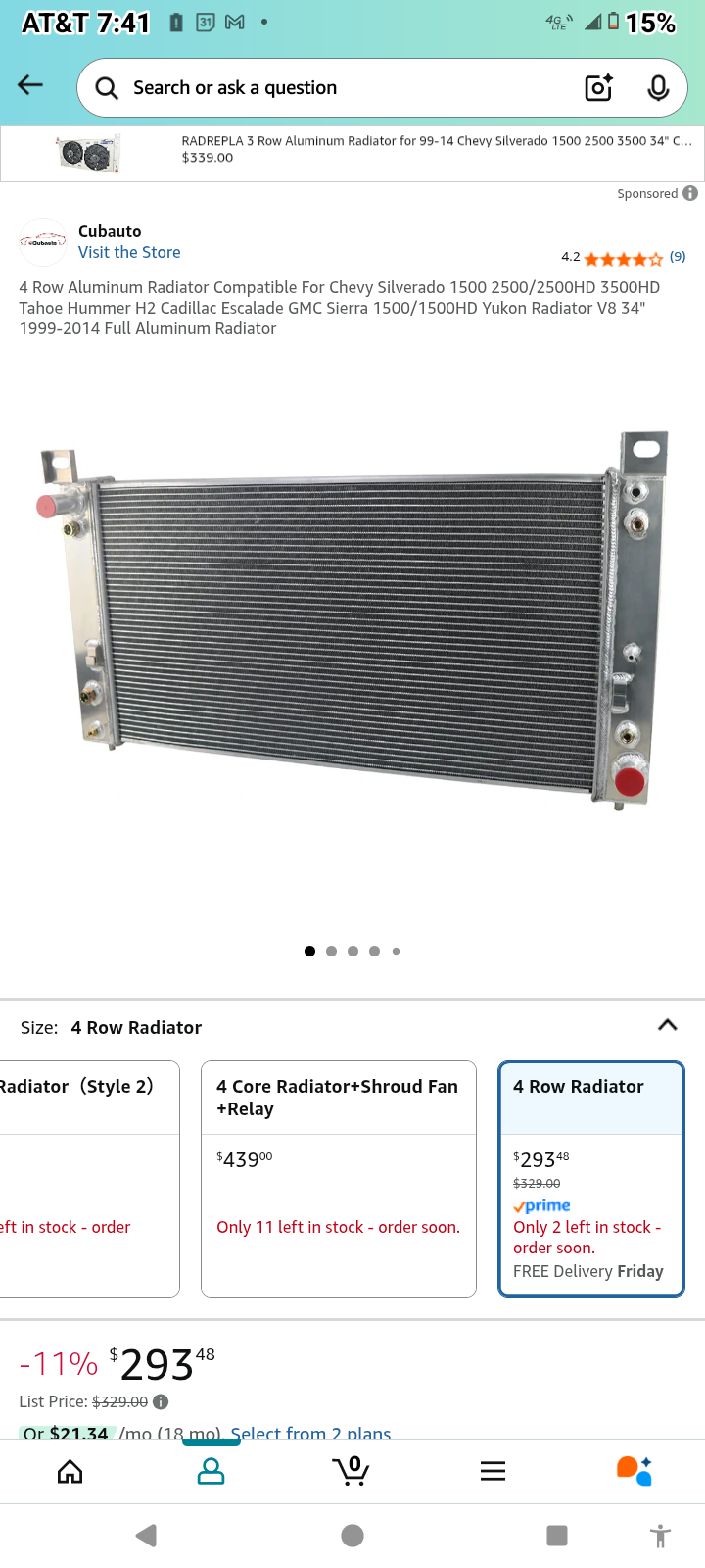

i ordered this radiator
it’s was $329
it’s was $329
Noice
I think I paid under 200 for mine during the plandemic
Its holding up but I know flushing muriatic through it didnt help the inside fins so some day I expect to get a shiny one again lol
Mines over 5yo tho obviously and survived a bad water pump, limping a head gasket almost a year, overheating it enough to damage the block etc
Chinese radiators get a thumbs up from me lol
