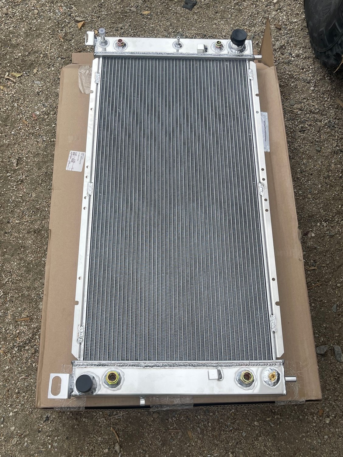

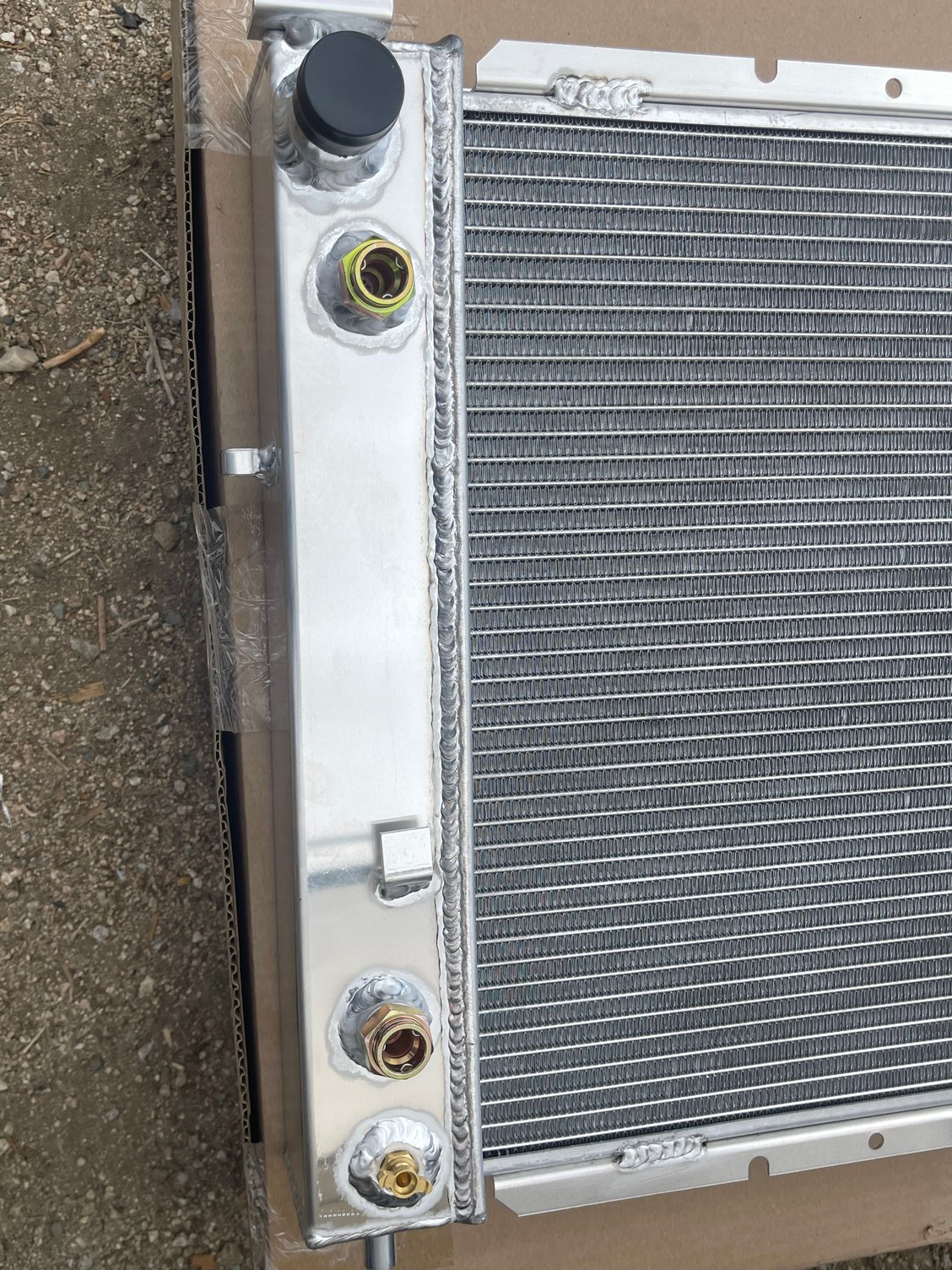

This radiator is made by evil energy
it’s a precise direct fit
much larger than stock
however shroud needs to be trimmed half inch to fit back on
other than that it’s excellent

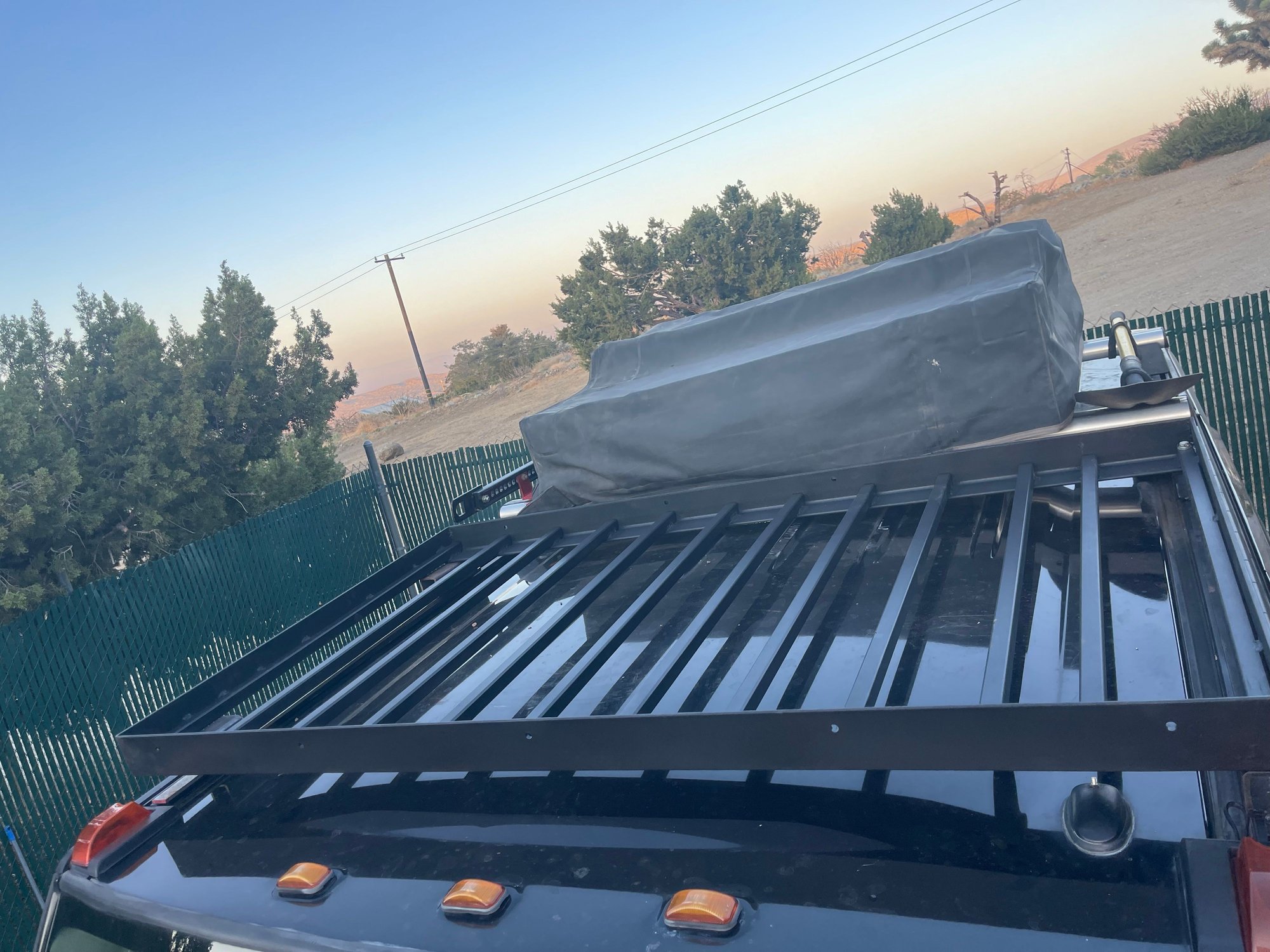

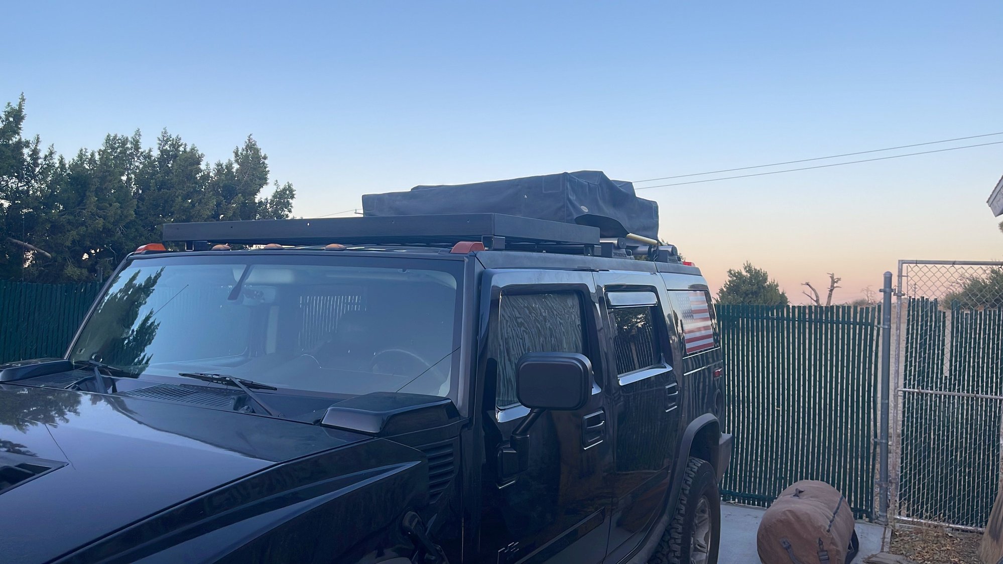

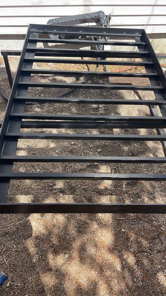

I am currently working on building my own roof rack that covers half of the roof because the other half is gonna be occupied by the roof tent,
i do fabrication work for hobby,
I think I can give Gobi racks run for their money 😁
the goal is a rack that can hold 600 LB standing on it,

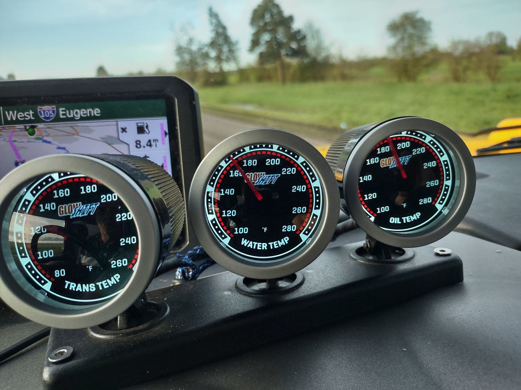

On the '03, the transmission temperature gauge matches my aftermarket gauge pretty much on the money. Most I've seen is 200° on a 105° day pulling a 6,000 lb trailer uphill. Normal driving it hangs around 155 to 160°.

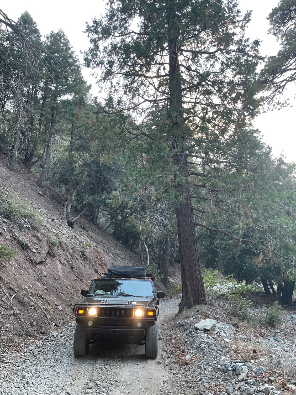

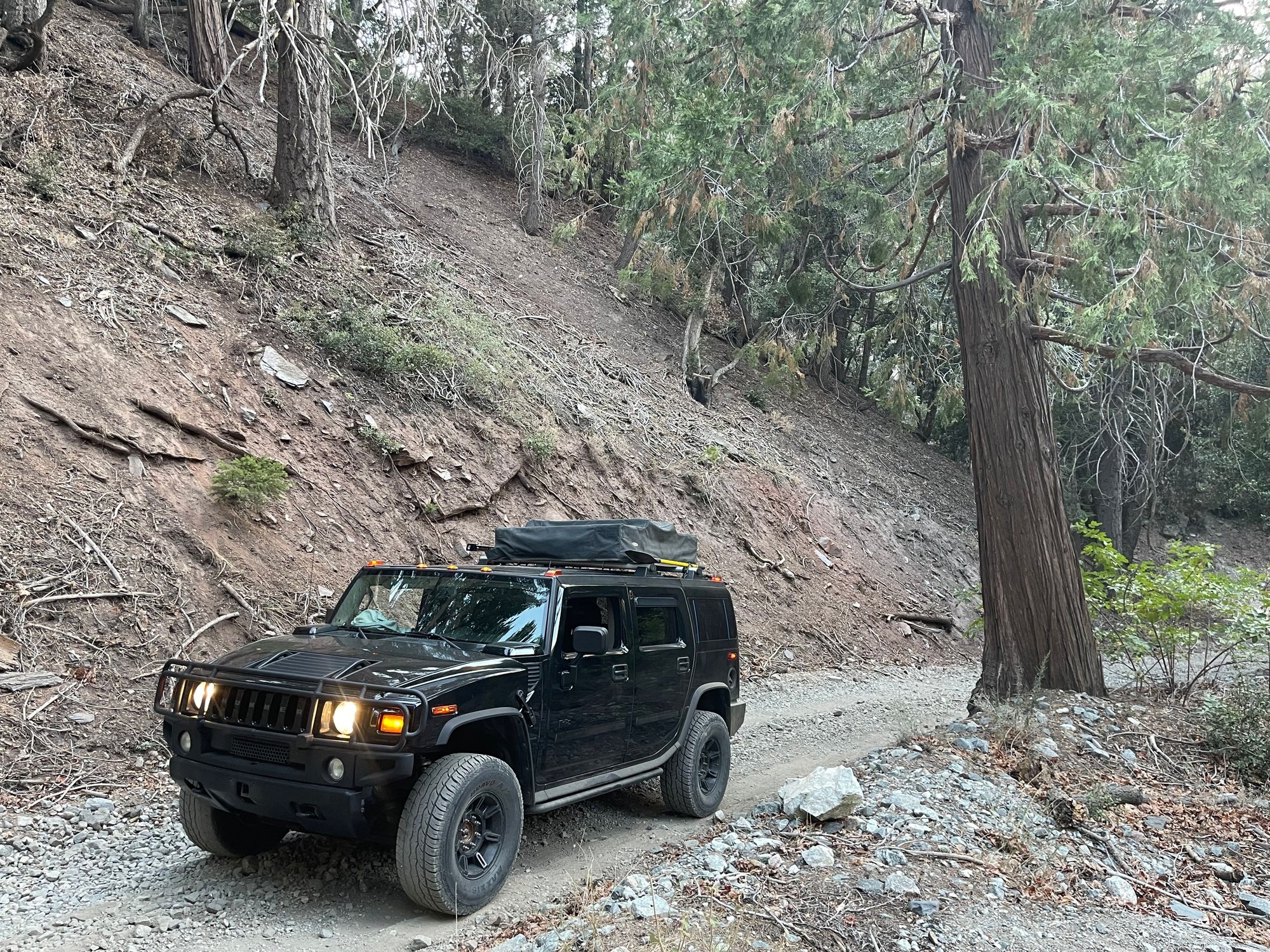

And the fun begins

Is the temperature gauge accurate on those trucks ?
going up the trail temperature gauge was showing passed center line,
however it doesn’t seep like it’s running that hot.
I opened the hood to check,
I have also done proper bleeding by having heater run all the way and top of the coolant.
with his large radiator I was thinking temperature should stay below center line?
unless the gauge is not very accurate

RobertDez's Avatar
Joined: Feb 2024
Posts: 537
From: Oregon
The engine temperature coolant gauge is the one gauge that's not very accurate. I had my cluster rebuilt with all new stepper motors. The gauge likes to stay right around the 200° mark when it's fully warmed up. I have an additional aftermarket gauge utilizing the port on the passenger side cylinder head and I get more accurate readings. While the factory gauge is showing 200°, the aftermarket one shows in normal driving the temperatures averaging 185 to 195 degrees. (I have a 189° thermostat) We've had a couple 100° days, pulled my 6000 lb trailer, air conditioning going full bore, factory gauge moves a little to the right. On a several mile uphill, my aftermarket gauge will go up to about 205°, then drop down to about 195°, and then back and forth till I get to the top of the hill. Basically reflecting the thermostat opening and closing. Keep in mind these engines are designed to run between 200 and 210°, which is considered normal.
Right aftermarket gauges I threw on..... Actually the plan was just temporarily after I went through my engine, just to have the accurate visual on things..... I may just end up leaving them. Transmission temperature gauge in the cluster is spot on with the aftermarket gauge. And I do really like having the oil temperature gauge.

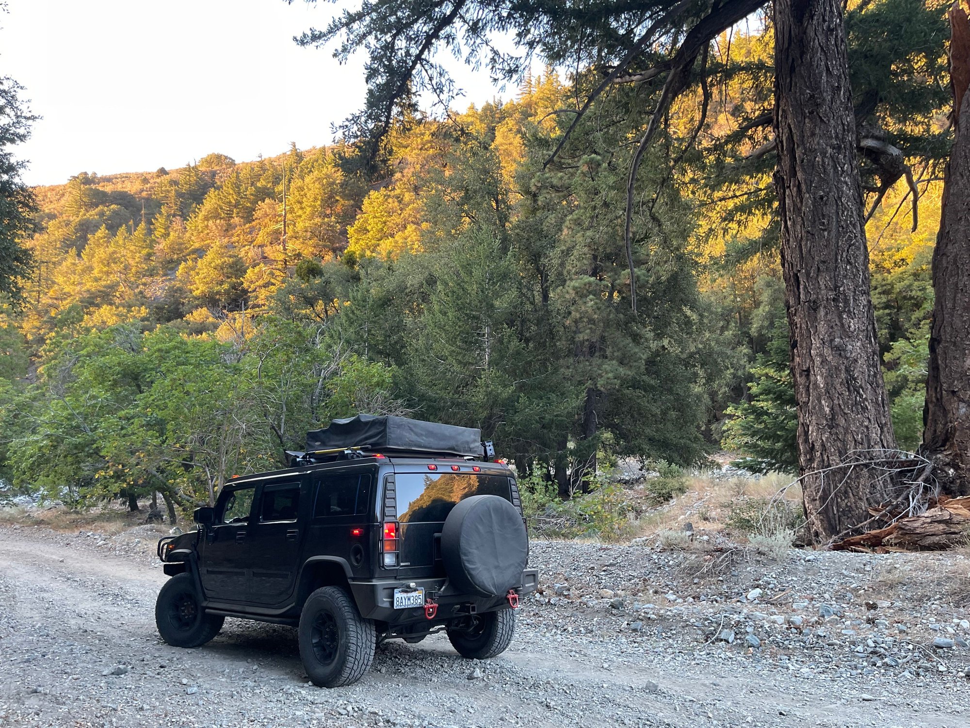

Heavy duty roof rack is made and bolted on to the roof
