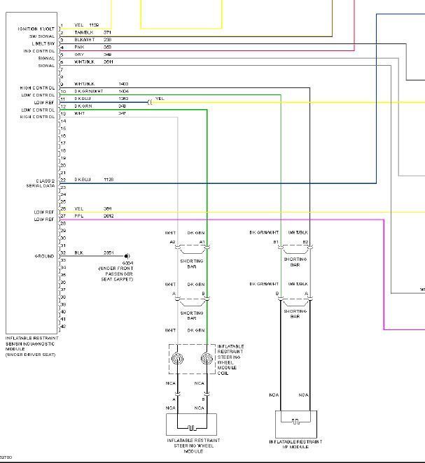

I will never understand engineers, you put the SDM module under the driver seat then put its grounding point under the passenger seat. What goes through these people's heads.
